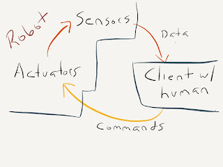

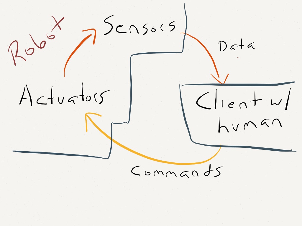

I've built some simple robots, mostly of the "drive around and use IR or ultrasound to not run into things" variety. Once I had a basic back-and-forth network socket program working, it was time to think about overall program flow.

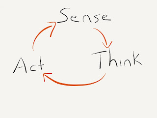

A traditional robotics paradigm is the "Sense, Think, Act" cycle. A robot takes input from it's sensors, performs processing on them to try to identify the best course of action, and then commands the robot's actuators to do something. The process then repeats.
At the moment, I'm not building a robot in the typical sense. That's because a human is in the loop, making the decisions based on sensor input. I wanted to make sure that the platform could be used as a robot, just by changing the software on the phone, but right now I'm interested in building a reasonably robust remotely operated vehicle. I'll continue to use "robot" because it's convenient. :-)
On reflection, I decided that a remotely operated vehicle can follow the same sense-think-act cycle. The primary difference is that the thinking is done off-vehicle, by the human operator.
With that understanding, I started thinking about how the communications will work. I intend to use the excellent IPCam program to stream the video from the phone. It works great, is robust, can run as a service, and can auto-start when the phone boots up.
