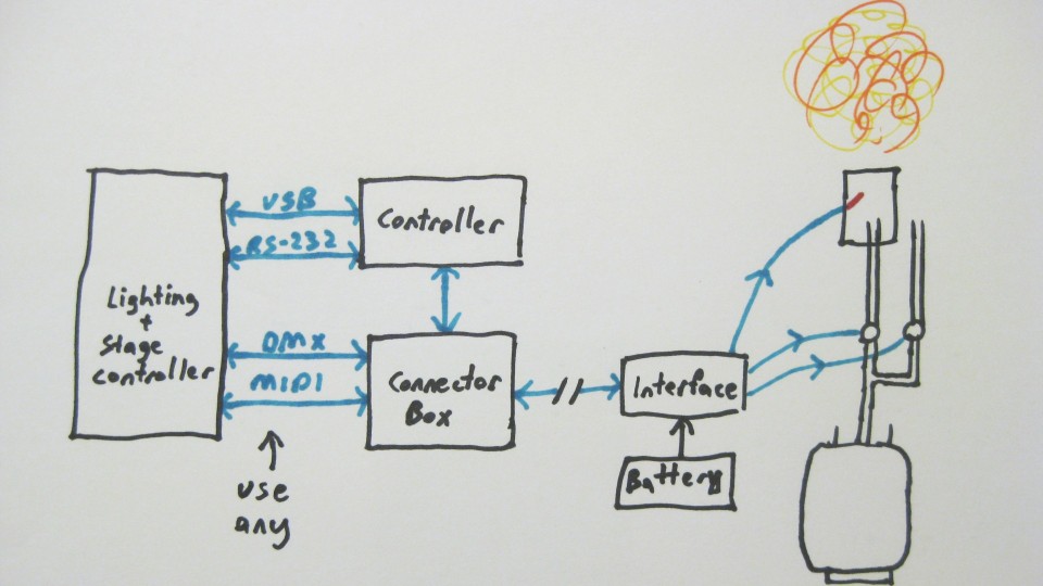

    A block diagram of how it all connects is shown here: (System Design Document)
    The controller schematic is shown in this project log.
    The first prize video is also linked on the main page links, and here.

    The system is connected in that is uses a variety of interfaces to connect to a stage and lighting control system. Interfaces supported are DMX, MIDI, RS-232 serial and USB. This allows a show operator to sequence the firing with other lighting and sound effects in a performance.

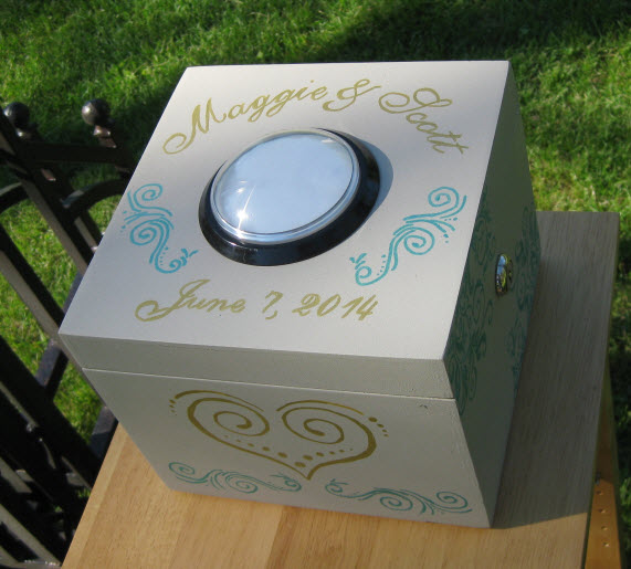

    The ceremony control box:

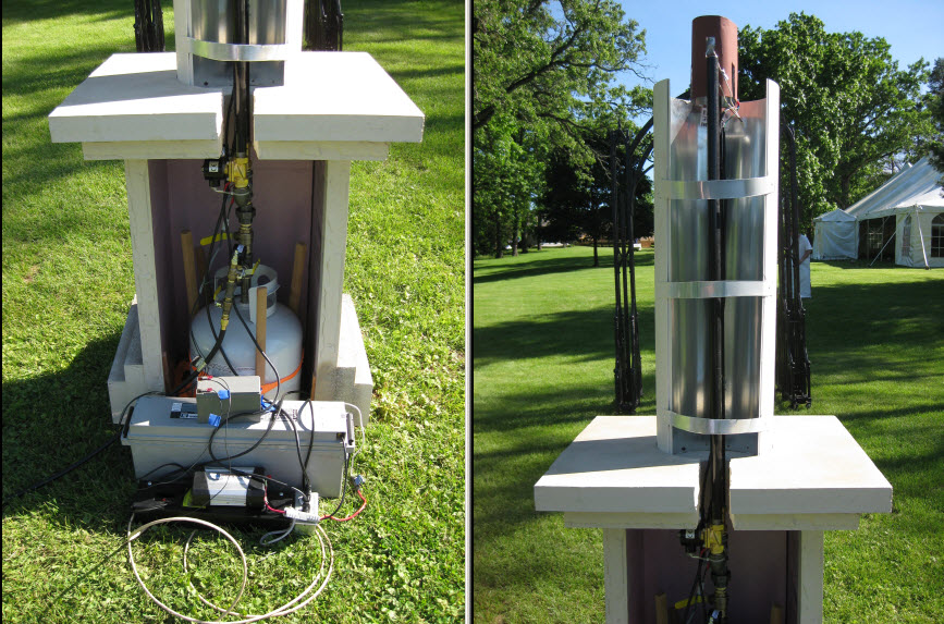

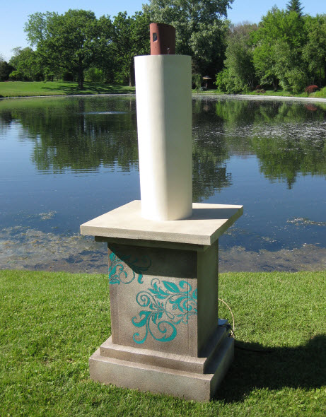

    The candle in this case is 3 feet high and 12 inches wide on top of a 3 foot stone pedestal, located about 15 feet beyond the ceremony space. The pedestal is made of insulation foam, cut and screwed together, with decorative paint to make it look like stone. The backside is open to allow installation and access. The candle on top is made of a section of galvanized steel ducting with an opening in the back for installation and to allow air to flow up through the shield.
    This is actually only a decorative shell to a two stage release propane poofer. A common propane poofer releases the contents of an accumulator tank past a flame to ignite it. To increase reliability, and prevent the visibility of the open flame pilot, Hot Surface Ignitors were used. These are off the shelf parts used in the electric ignition on many gas furnaces and water heaters. A pair was used for redundancy, though in testing, a single ignitor always worked. The ignitors were mounted in a wind shield at the top of the primary accumulator output pipe which served prevent the wind from cooling the ignitor, as well as to shield the ignitors from any propane coming out of the second accumulator output pipe. The most noteworthy difference of this from most poofers is the use of a second output path that is not ignited. This allows the release of propane into the air above the poofer prior to ignition to create more of a burning fireball effect than a jet.
    The basics of a propane poofer involve a propane tank with regulator the passes "high" pressure gaseous propane and fills an accumulator tank. In this case, the accumulator is filled to 60psi.(a standard regulator for a propane grill is 0.5-1psi) The accumulator tank has a high flow path for the propane to release under the control of a solenoid valve and out the top to be ignited. A 3/4" pipe path is used here as it is the maximum output size of the easy to acquire accumulator tank, and can empty the entire tank in about 1.5-2 seconds. The poofer is fired by opening the solenoid valve which quickly releases the stored propane in the accumulator to create the fireball burst. This system of using an accumulator is required because a standard liquid propane tank has a limited rate of evaporating the liquid into gas to be released and burned. This allows high volume bursts to be released very quickly. Further discussion of the principals of a poofer is left to the reader to research elsewhere.

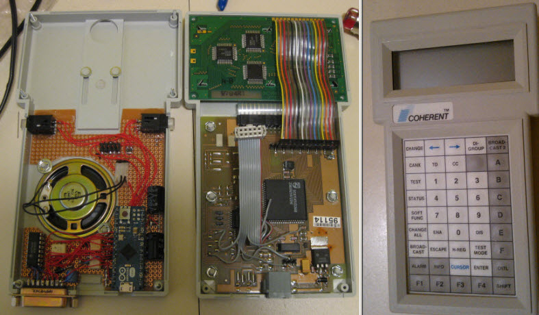

    The remaining part of the system is a controller which implements safety features as well as runs programmed sequences to correctly time the two solenoid valves. This was built from a surplus hand controller, with an arduino micro, additional buttons, and IO drivers and protection built in. This was designed to be very tolerant of electrical noise, spikes and electrostatic discharage without damage or incorrect operation.

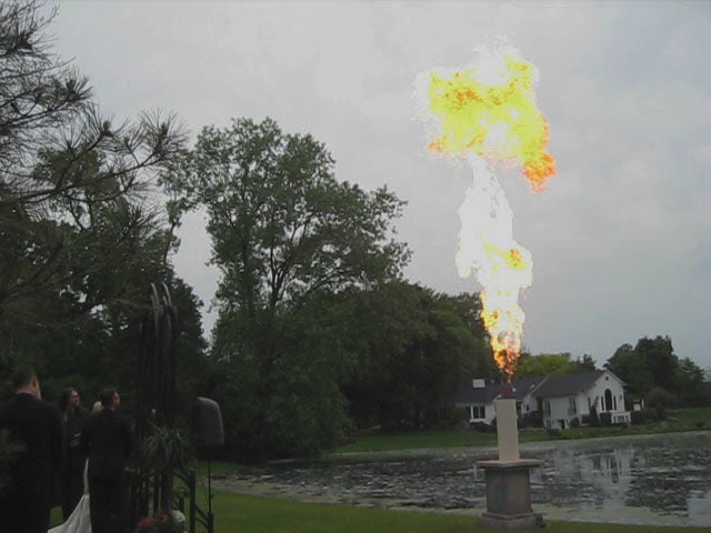

    The wedding was this past weekend, and was a great success! I'll have a video, a summary and maybe some more pictures up soon, but wanted to get this out there.
    I setup bright and early in the morning, getting everything installed and ready before returning later in the day better dressed. The minister gave a great lead up to the ceremony, explaining that this unity candle was a bit different, reflecting the background of the bride and groom. The guests were mostly unaware of what exactly the unity candle was. Actually, let me just quote D:
    "To symbolize the joining of families and communities, we use the metaphor of a unity candle. Lit together, it joins two flames into one, representing lives and passions joined into one. Of course, given our bride, and our groom, our candle is a little more elaborate than some, and holds some special significance. It is represented by this box, which you probably can't see from where you are, but it has two key holes, one on each side. The key is somewhere in this room... no.(laughter) The keys represent the complex array of life experiences, of personality, of desires, and strengths, Maggie and Scott each of you bring to this relationship. Once the keys are in place, the bride and groom will, together, press the button at the center of the box, right on top. A symbol of their joint and unified purpose in their coming lives."
    The bride worked at it, and eventually managed to find the key in her dress to much chuckle from the guests. The groom simply pulled the other out of his pocket, to even more laughs. Listening to the recording is great, because from the guests you could hear quite a few shocked reactions the moment it went off, followed by an energetic round of applause, while in the video you can see the couple grinning overjoyed, chuckling to themselves :)
    Sorry it isn't a great picture, it is a screen capture from a video which wasn't the best. I'm collecting another video or two, and will see what I can put up. The photographer knew all about this, so should have some good pictures as well. I'll share some of those as well if I'm able. Actually, funny thing about that. This was kept mostly a secret from the guests, though obviously I've been putting up logs here for some time under the assumption that no one was likely to come across this. Apparently when the couple had emailed the photographer that they were going to have a "unity fireball" along with a description, she was doing her own prep research and stumbled across this log. Sure enough, "unity candle fireball" in google points right here ;)
    Overall, the bride and groom were overjoyed at how it all worked out, and the lasting memories they, as well as their family and friends will have.
    Special thanks to M&S for asking me to do this for them, to A, K and J for helping create and decorate the decorative shell, to A for hand painting the box, A and J for code reviews, to D who helped bury wires, helped with multiple setups and tear downs, and was my safety backup in case of my illness, as well as to S who helped me take everything down after the ceremony.(formal wear is not so conducive to this sort of work)
    To answer a question that was frequently asked, yes, the bride and groom did actually fire the candle flame. I stood in the wings with the controller to unlock and configure the system, as well as to hold down the positive manual enable button as long as the area was safe to launch, but the couple pressing the button actually did fire it.
