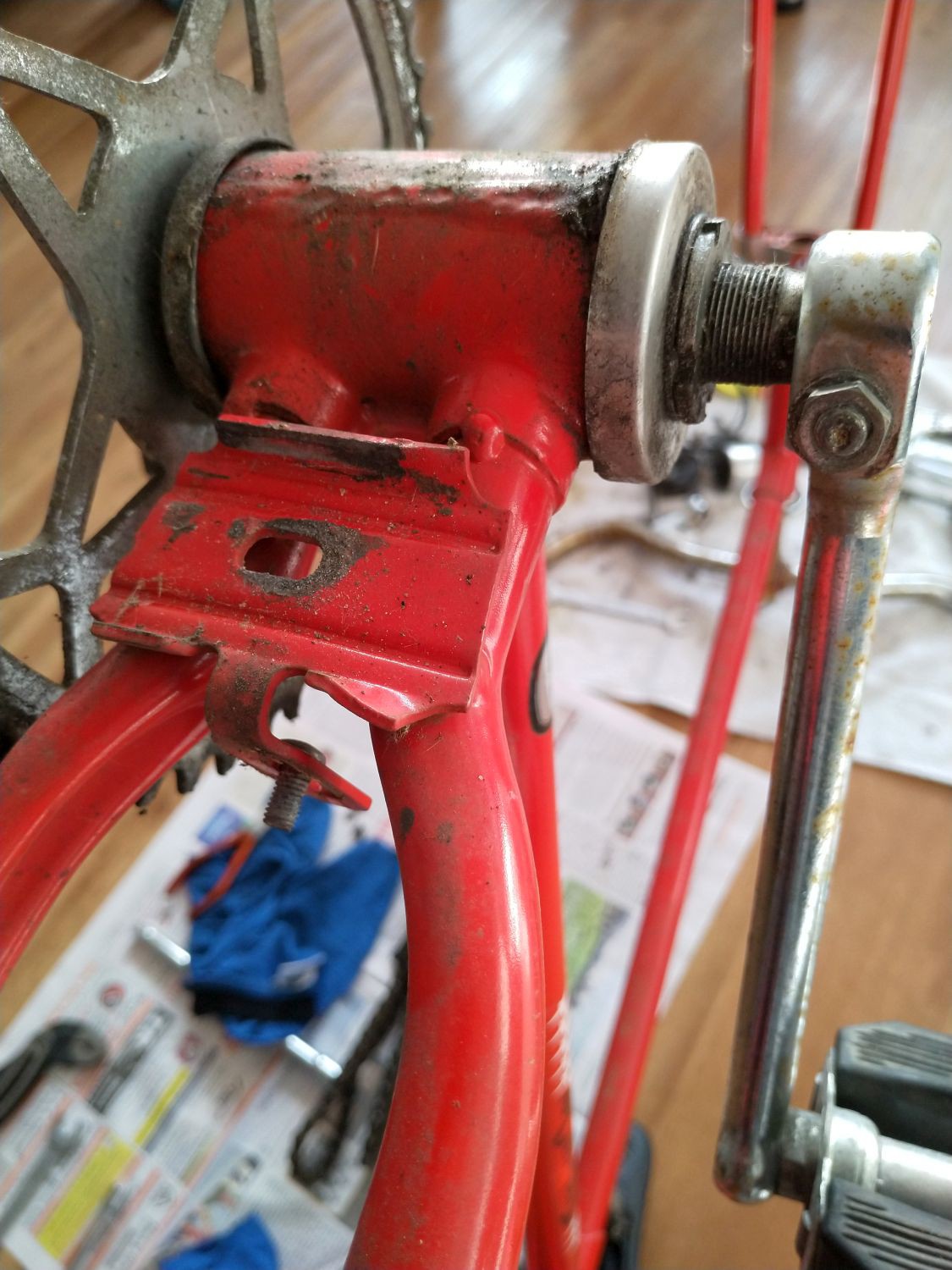

Thomson BB with 'all steel' chainwheel and 'wedge axle' crank arms
The original part was a Thomson type BB with wedge axle.
As mentioned, the crank arms were rusted and too heavy also. I decided to dismantle the crank arms and the BB completely.
The BB shall be replaced by a semi-modern square taper version.
Wedge axles are odd to square taper crank arms
Sturdy frame: All the residues on it were dirt and oil - no rust

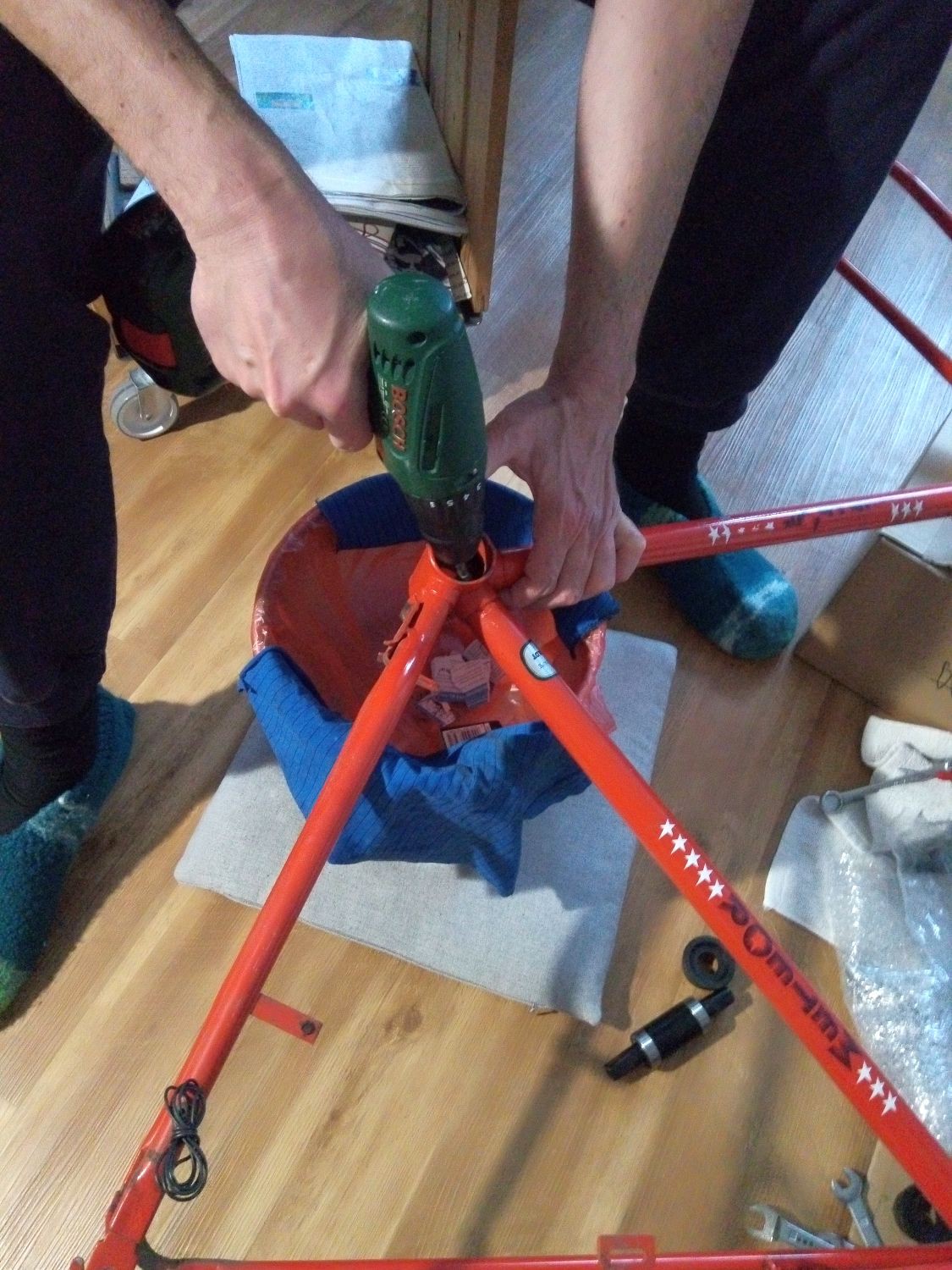

It does *not* fit! The polish frame builder has hollow turned the inner area just to fit in the Thomson bearing shells. The nylon shells for the new bottom bracket are more wide and the press-fit got blocked. I spent five hours grinding off the metal inside to make it sort of fit finally...
Grinding excess metal inside the BB housing
Cutting away excess plastics from press-fit bushing
Finally, after hours of trial and error, it fits in

Result: The press-fit bottom bracket is mounted. The time will show how durable this imperfect solution is.
