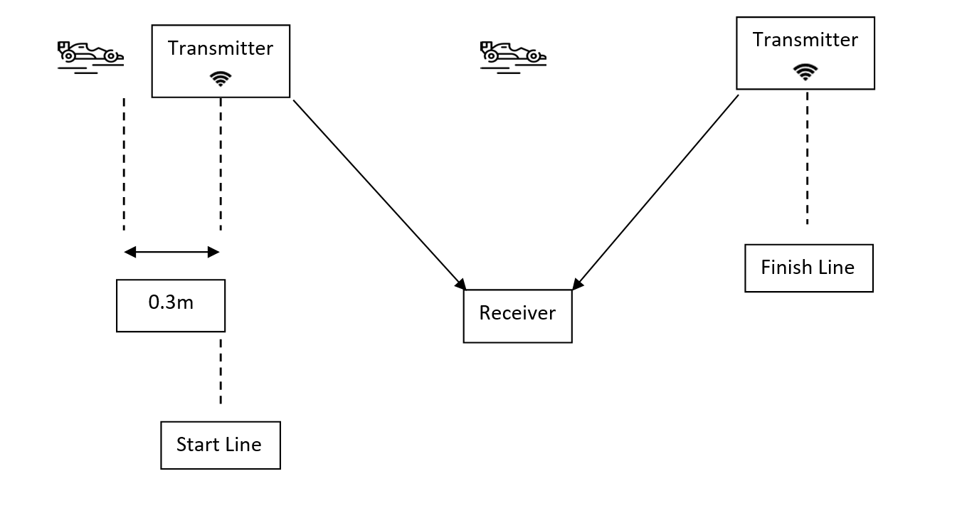

Timekeeping Architecture
The system was tested with success in all kinds of dynamic events that FSAE organizes. For example, for the acceleration event we came up with the following architecture.

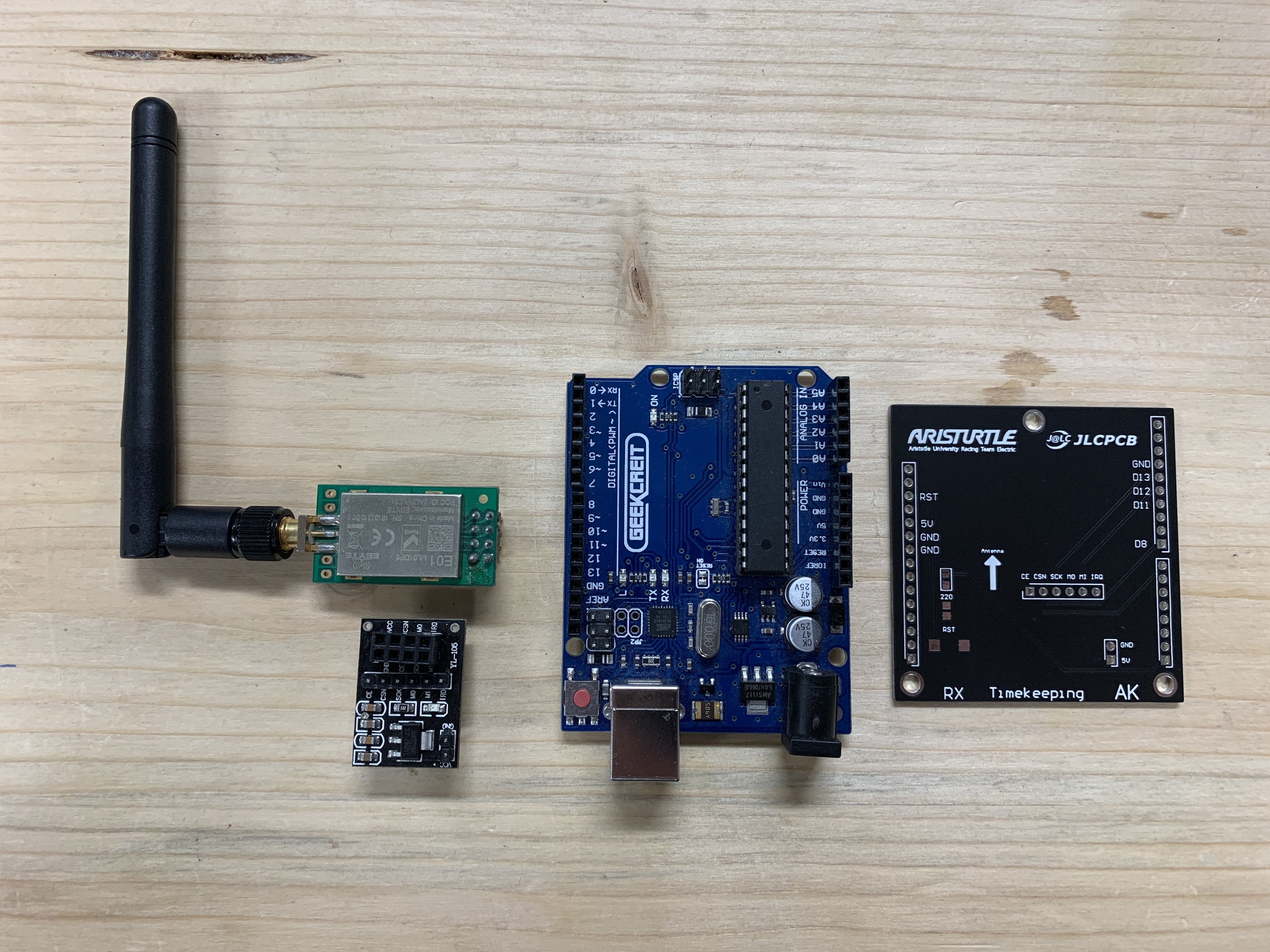

Hardware

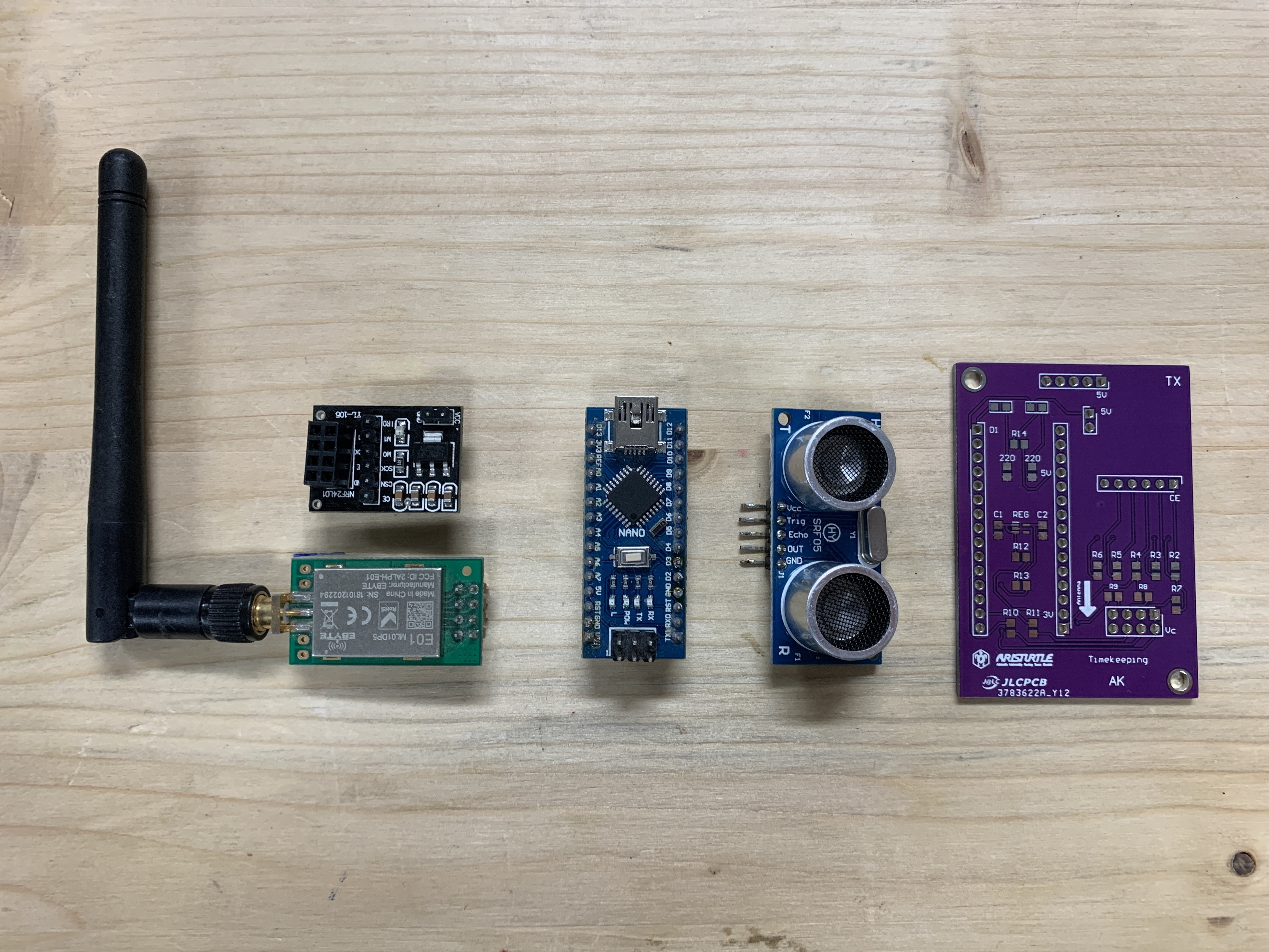

The transmitter subsystem consists of :
1  x Ultrasonic Sensor HC-SR05
1  x Arduino NANO
1  x nRF24L01 base module
1  x E01-ML01DP5 V6.5
Power Supply : power bank of 6700mAh

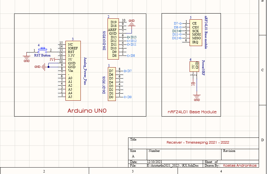

The receiver subsystem consists of :
 1 x Arduino UNO
Power Supply : From PC through USB

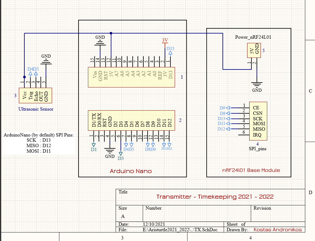

Schematic Designs

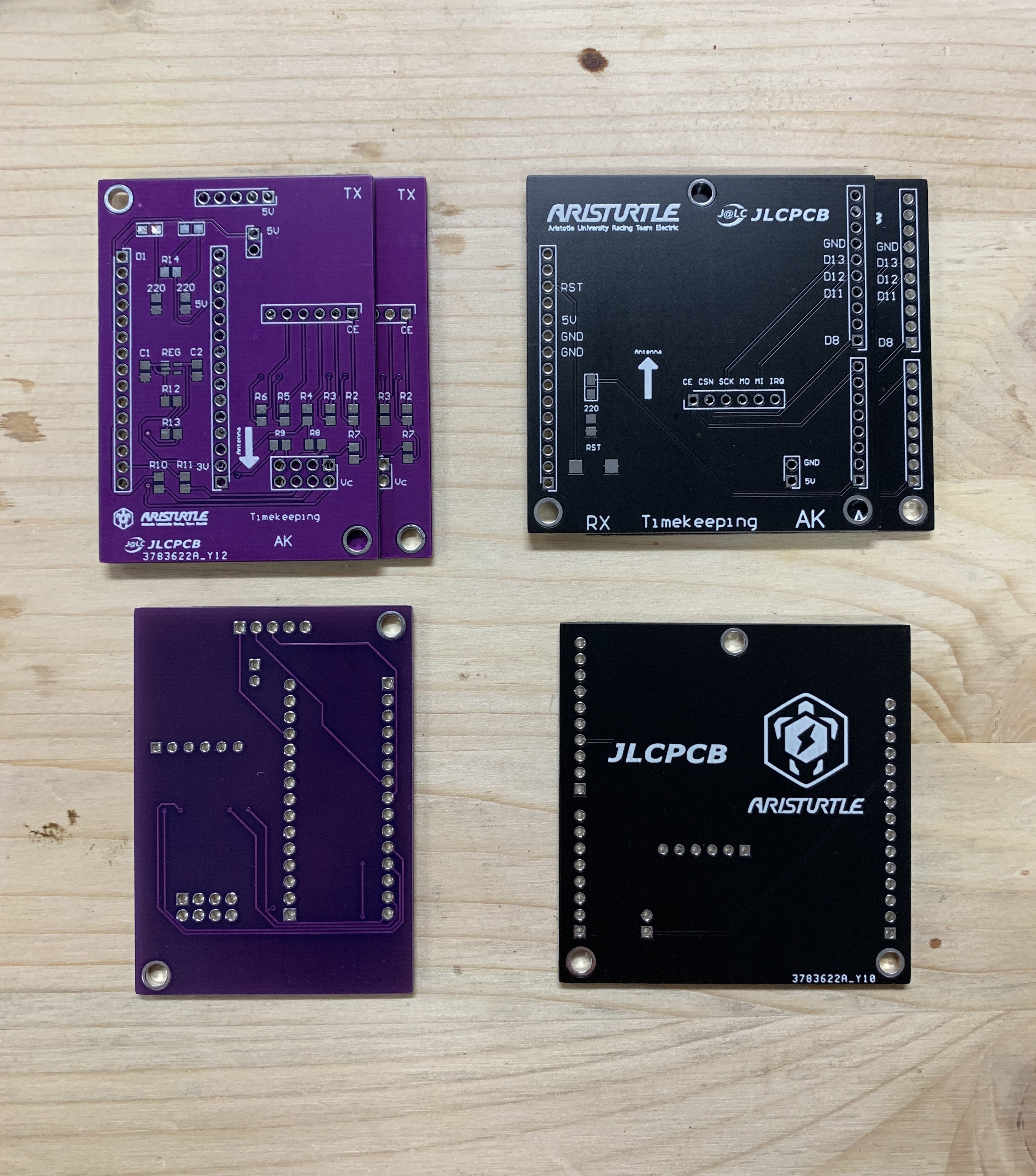

How to order PCBs from JLCPCB
Here, we would like to take this opportunity to express our gratitude towards JLCPCB for providing the PCBs and making this project a reality. You can order your own PCBs from JLCPCB by clicking here . First of all, you have to add a gerber file. Gerber file is a file that is exported from the software that you design the PCB. In our case that software is Altium Designer. The next step is to select all the characteristics you require for your PCB. After that, you will have to add the remaining files, such as the bom files and the pick and place files. Upload these files and you are ready to complete the order.

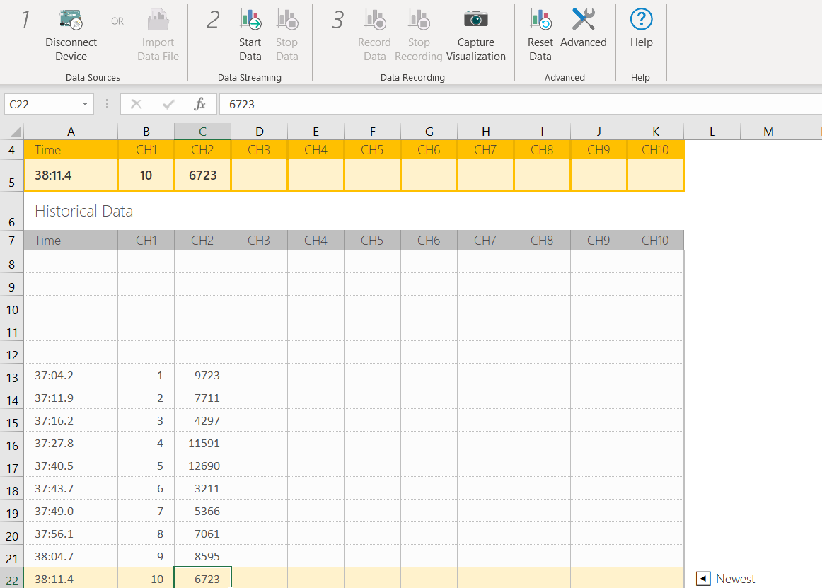

Timekeeping Interface
The serial data from the USB is being transferred automatically to an excel that is being updated in real time. To do that we used Data Streamer and you can find it here .

Proof of concept

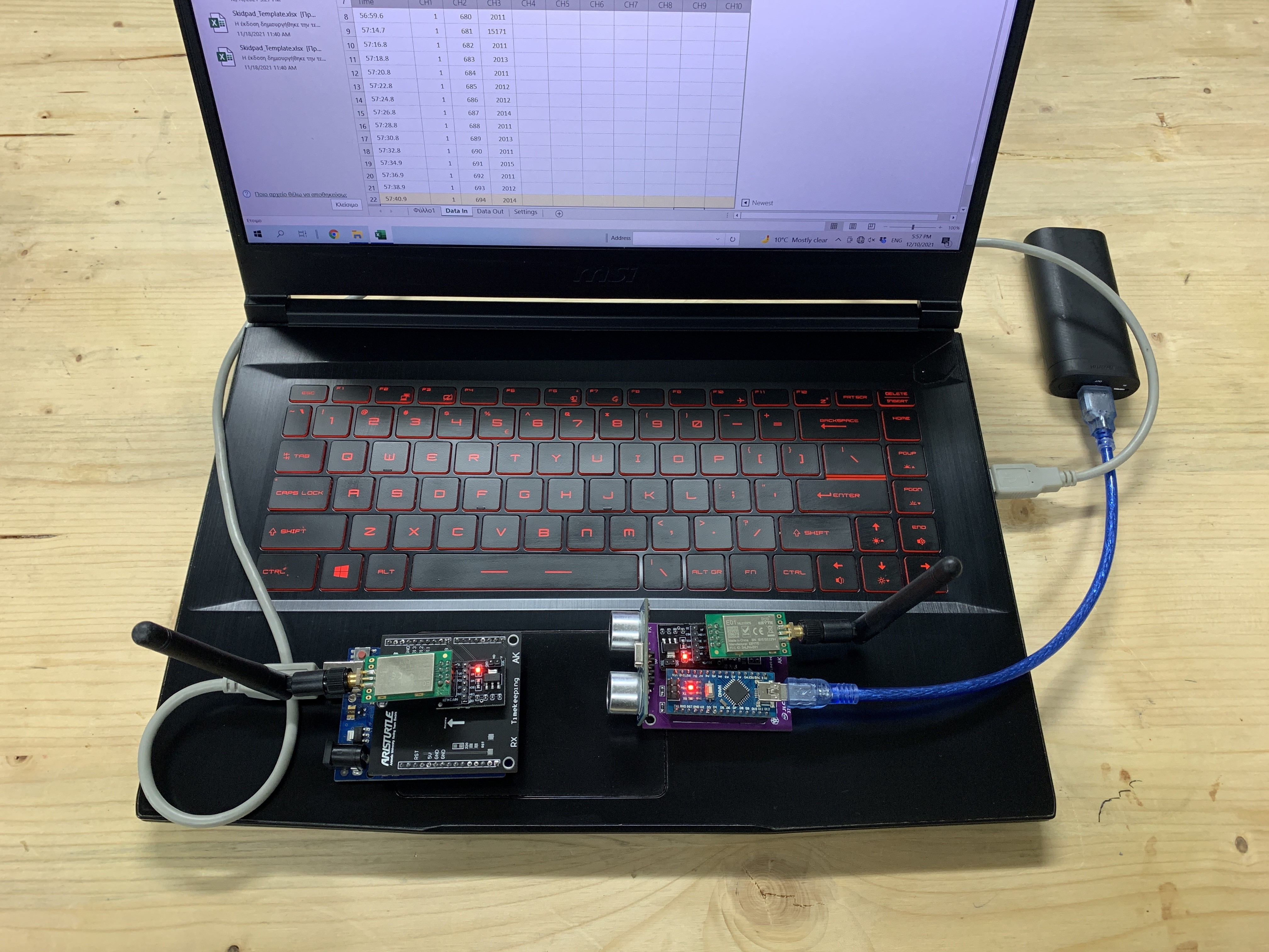

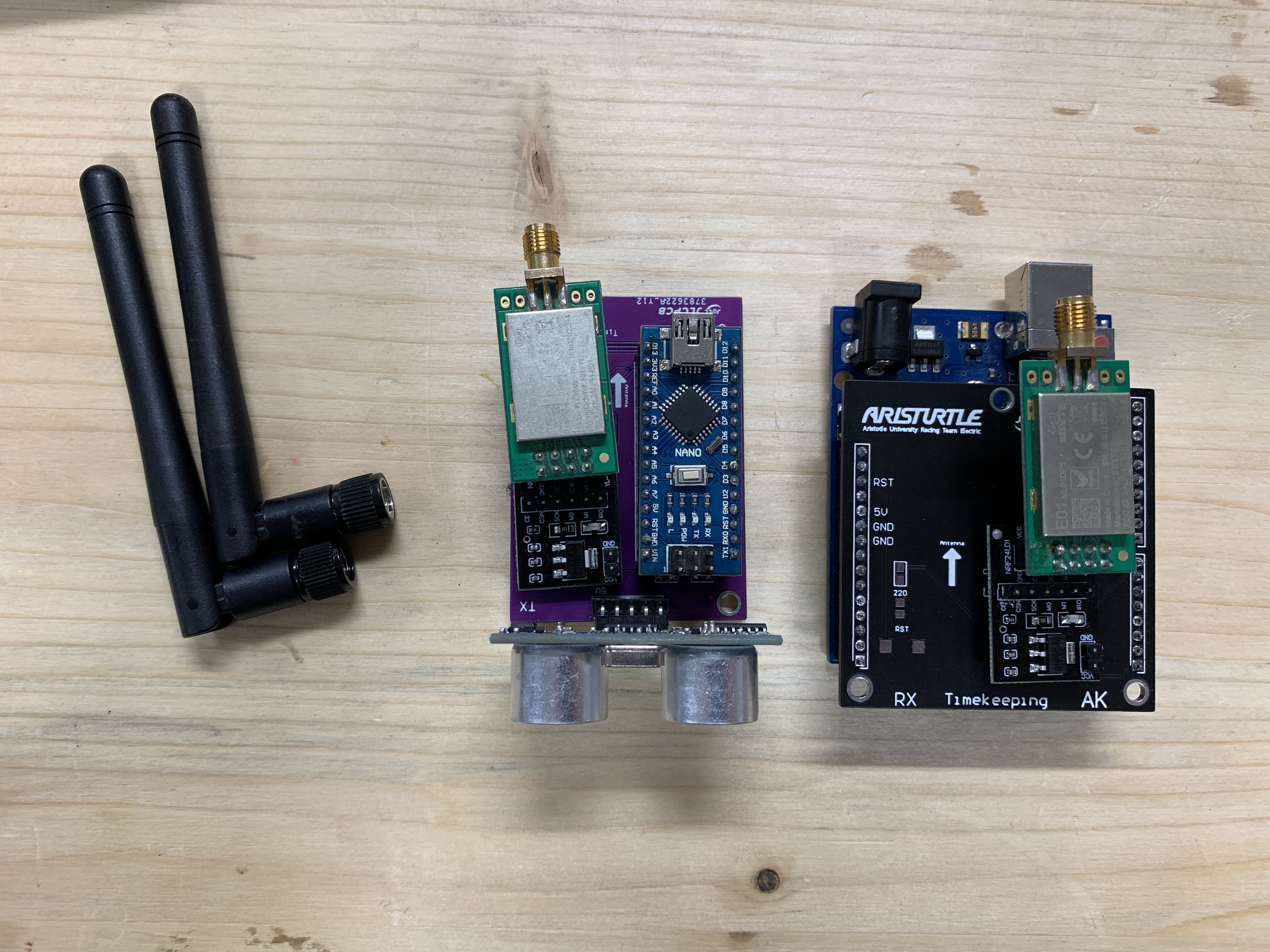

We tested the system with the receiver on the left and the transmitter on the right. Note that this set up is suitable for keeping the time for the Skidpad Event. We also found that the maximum distance that these modules have is around 400m in line of sight (LoS) by sending 1 byte/s.
