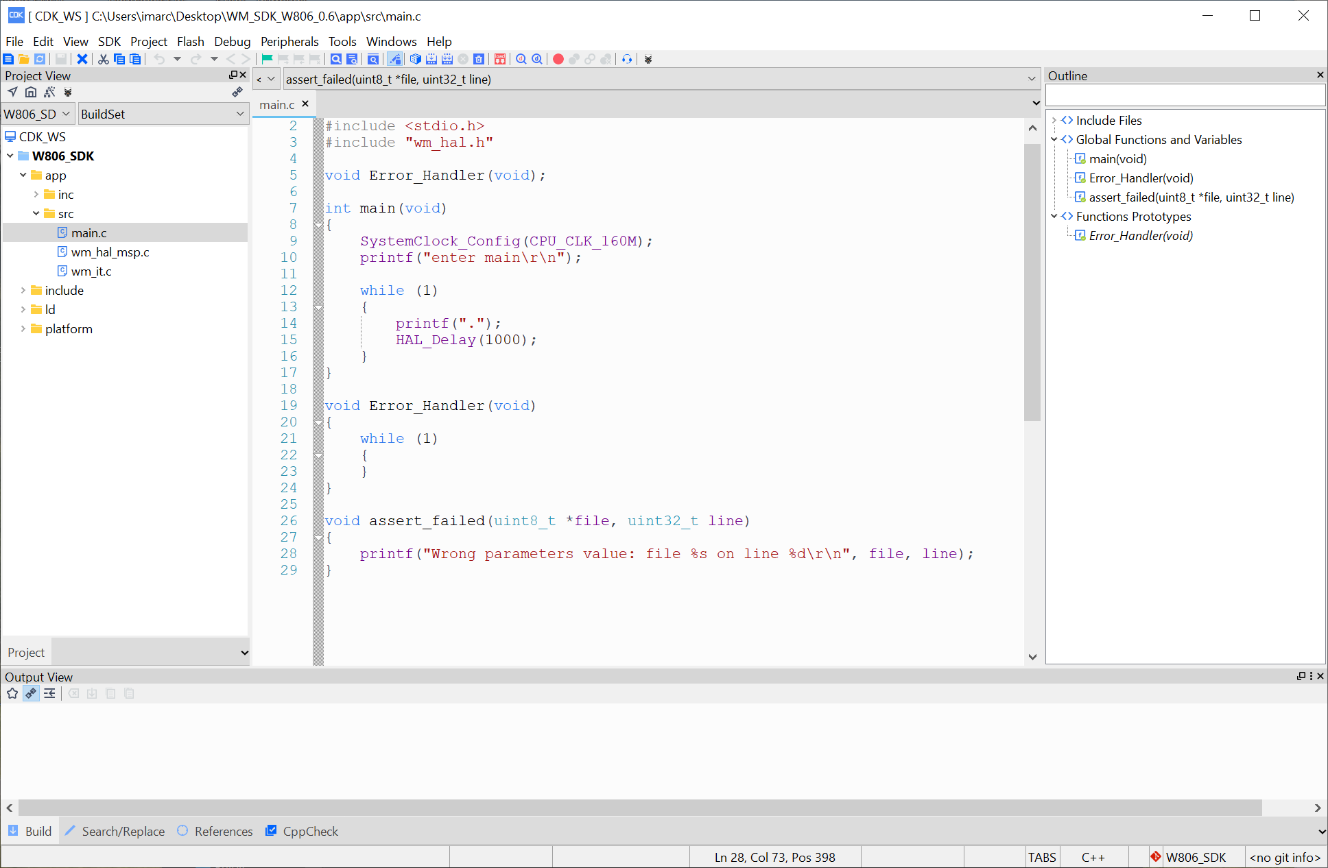

2) Open project that is located in SDK: WM_SDK_W806\tools\W806\projects\SDK_Project\project\CDK_WS\CDK_WS.cdkws

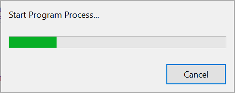

3) Enabe “Download To Flash” parameter in Debug settings
Right-click on W806_SDK → Options for “W806_SDK”

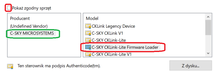

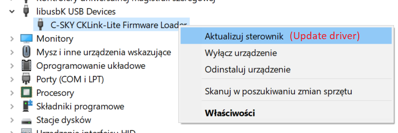

6) Update drivers in Windows Manager

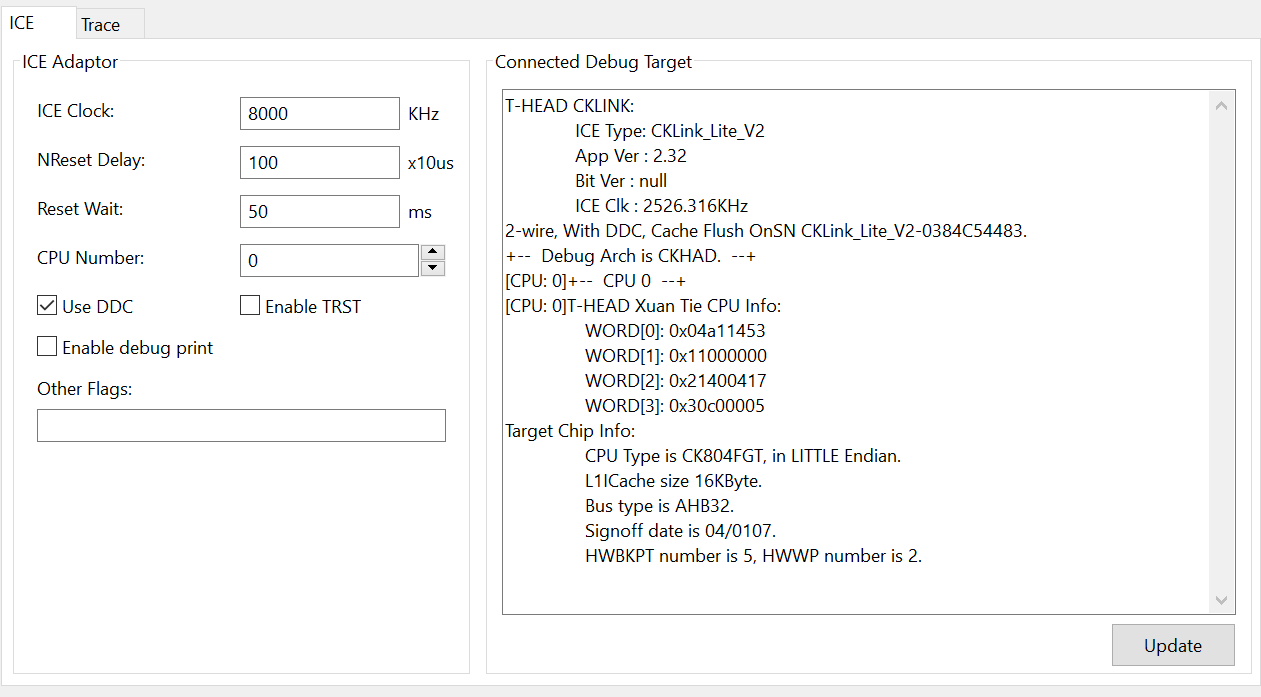

After updating driver CDK IDE should see connected hardware in Debug
Tab in Project parameters:

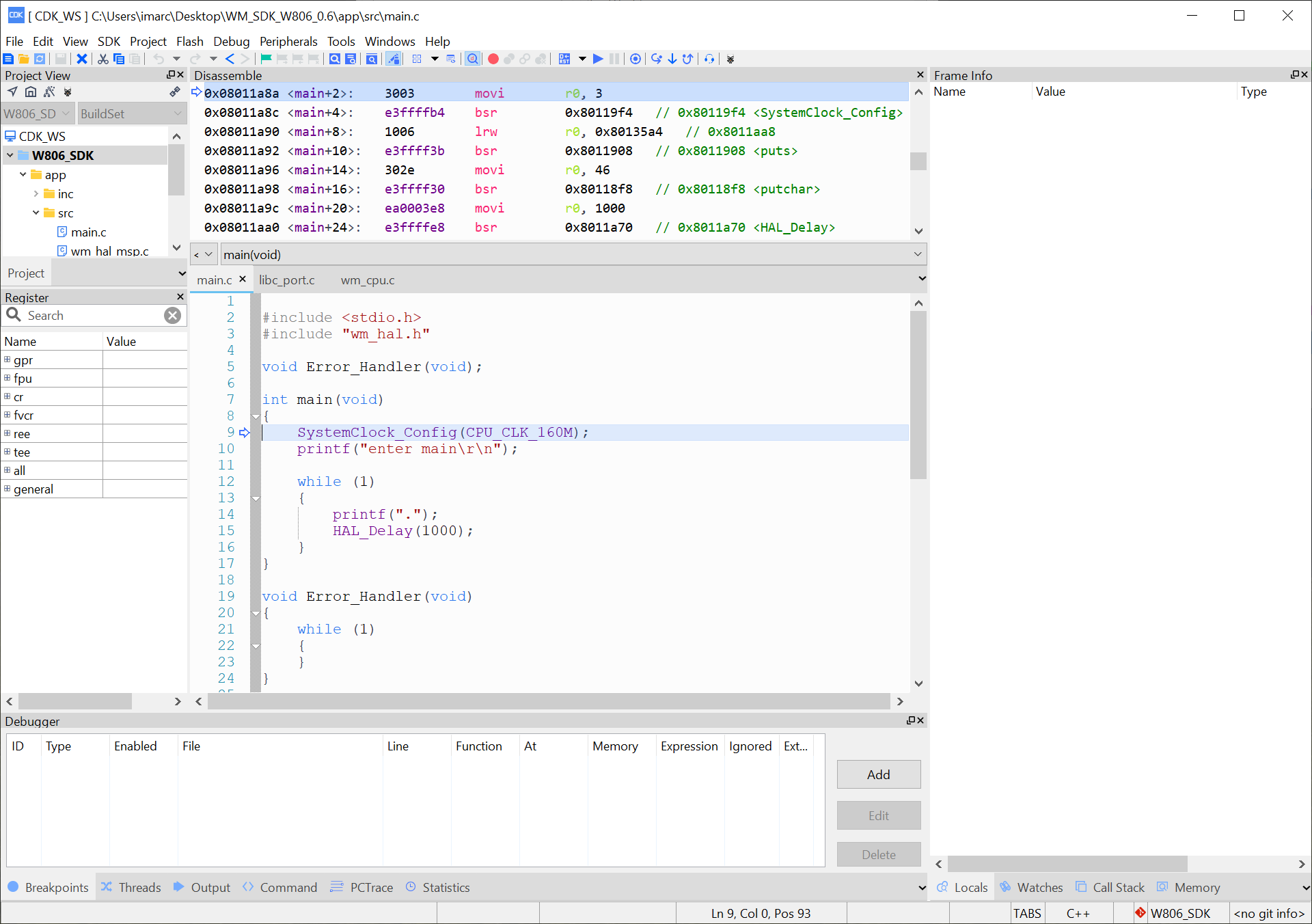

7) Compile project – in contrast to STM32CubeIDE CDK is not automatically compiling project after clicking Debug button
8) Starting Debugging

Also, I couldn't get it to load or debug due to the absence of the ELF file for "Flash Algorithm".
Currently the CDK only has these, and they are not compatible to the W806 board.
I found out that you need that specific W806 board's Flash Algorithm ELF from this site (it's called W806_Flash_Tool.elf): https://www.bilibili.com/video/BV1L44y1J7Jz/
