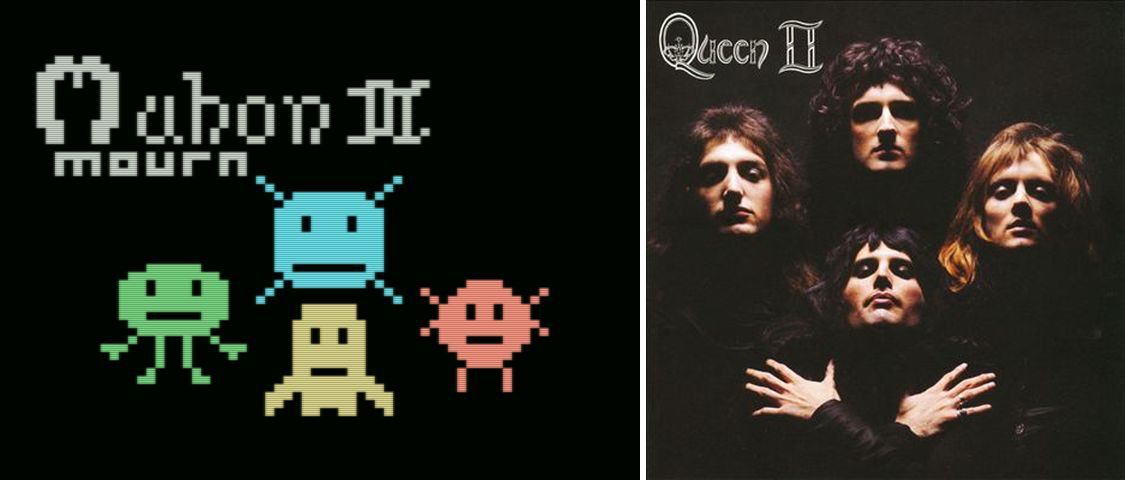

Splash Screen
The ROM loader adds about 2 seconds to the startup of the machine running the game, then a Splash screen was added to divert the attention and reduce the perception of the loading time.
The Splash screen uses Screen 3 multi-color mode, with a resolution of 64 x 48 pixels. The image was edited using mspaint and the space color was reduced to 16 colors indexed mode (bitmap) using irfanview, then a python script to convert the pixel information into data to be included on the loader code.
The screen 3 mode uses 1 byte to represent the color of two pixels (each nibble is a pixel color). The whole screen takes 1536 bytes which is the half of 64 x 48 -> 3072 pixels available.

Screenshots
The splash screen depends upon the slot where the ROM is inserted is even or odd. Both were inspired in Rock Bands.
Even Slots: Queen
Odd Slots: Information Society
