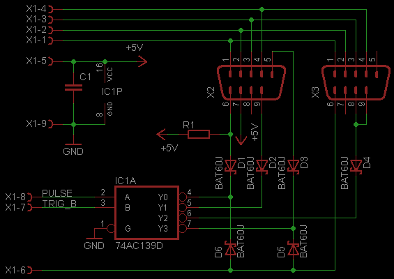

Added a second diode to enhance the detection
And drafted some driver code that provides scan and decode that takes 98 bytes plus 5 RAM addresses.
; Scan Atari keyboard and single button joystick using ; and adapter with 74LS139 ; PSG IO addresses PSGAD: EQU 0A0H PSGWR: EQU 0A1H PSGRD: EQU 0A2H ; DetectKB2600 - Detect Atari controller keyboard ; Input: ; register A: 0=Connector 1, >0=Connector 2. ; Ouptut: ; Z -> keyboard detected ; NZ -> keyboard adapter not detected DetectKB2600: call ScanKB2600 ld de,KBROWS ld c,0 Detct0: ld a,(de) and 00010000b ; isolate bit 4 rla or c ld c,a inc de djnz Detct0 cp 01000000b ret ; ; ScanKB2600 - Scan Atari controller keyboard ; ; Inputs: ; register A: 0=Connector 1, >0=Connector 2. ; Ouptuts : bit 7 6 5 4 3 2 1 0 ; KBROWS -> 1 1 1 0 # 9 6 3 ; KBROWS + 1 -> 1 1 1 1 0 8 5 2 ; KBROWS + 2 -> 1 1 1 0 * 7 4 1 ;(JOYTBITS) KBROWS + 3 -> 1 1 1 TA RG LF DW UP ScanKB2600: ; set zero flag according to port option and a ; Save PSG Context ld a,15 out (PSGAD),a in a,(PSGRD) ld (SAVPSG),a ld hl, KBROWS ; Select Joystick port accordingly jr NZ, ScanCon2 ScanCon1: and 10101101b ; clear bit 6 -> Joysel -> joy port 0, 4:PULSE and 1:TRIGGER B ; a = pins 8,7 low (row 0) ld b,a ; a = pin 8=0, pin 7=0 (row 0) set 4,b ; b = pin 8=1, pin 7=0 (row 1) ld c,b ; set 1,c ; c = pin 8=1, pin 7=1 (row 2) ld d,a ; a = pin 8=0, pin 7=0 (row 0) set 1,d ; b = pin 8=0, pin 7=1 (Joystick) jr ScanRow0 ScanCon2: and 10010111b ; clear bit 5:PULSE and 3:TRIGGER B set 6,a ; Set bit 6 -> Joysel -> joy port 1 ld b,a ; a = pin 8=0, pin 7=0 (row 0) set 5,b ; b = pin 8=1, pin 7=0 (row 1) ld c,b ; set 3,c ; c = pin 8=1, pin 7=1 (row 2) ld d,a ; a = pin 8=0, pin 7=0 (row 0) set 3,d ; b = pin 8=0, pin 7=1 (Joystick) ScanRow0: ld e,a call SaveRow ScanRow1: ld e,b call SaveRow ScanRow2: ld e,c call SaveRow ScanJoy: ld e,d call SaveRow RestorePSG: ld e,(hl) ; hl now points to SAVPSG SaveRow: di ; disable interrupts ld a,15 out (PSGAD),a ld a, e out (PSGWR),a ; update register 15 ld a,14 out (PSGAD),a ; select register 14 in a,(PSGRD) ; read keys hhhh*741 or 11110000b ; mask unused bits ld (HL),a ; save keyboard state inc hl ei ret ; Variables ; keyboard rows HHHL#963, HHHH0852, HHHL*741 KBROWS: DS 3 JOYBITS: DS 1 ; PSG register 15 save state during execution, destroyed buttons at the end ; must be contiguous to Joybits SAVPSG: DS 1
