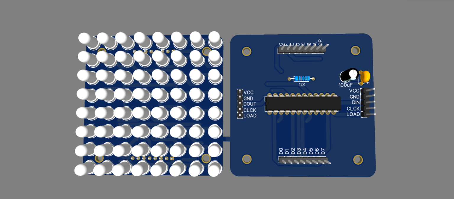

PCB Designing -

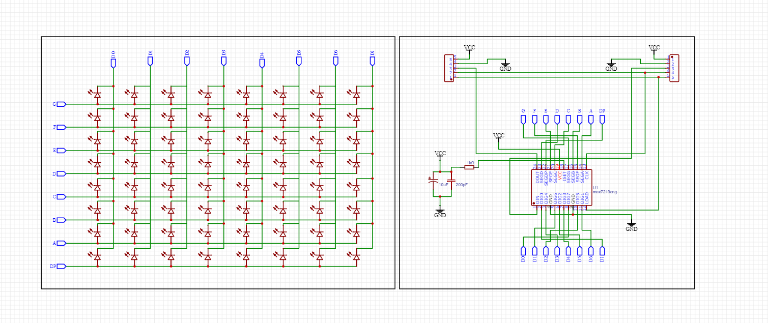

Before we can get started, first of all, We have to design the circuit, after creating the circuit, and then we have to design the PCB. As you can see here I have designed two PCBs one is for an LED MATRIX and the other one is for the driver circuit.
Schematic Diagram -
PCB Layout -

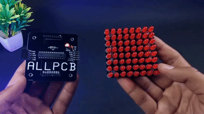

Assembling the PCB
To build the LED Dot Matrix module, follow the steps below:
1. As per my design, I have made two layers of PCB so first, we have to solder all the components of the top layer and in our top layer, we have to solder all the 64 LEDs.
2. After Complet the First Layer Now it’s time for the bottom layer PCB - We need some electronic components like some capacitors, 12k resistors, some male-to-female pin headers, and the most important thing the max7219 driver ic which will drive all the LEDs, Now its time to put all these components into the PCBs and here I don't have 24 pin IC base so I have used three 8 pin IC base. After Soldering all the components simply cut off the legs and then insert the max7219 ic into the ic base.
The circuit for the LED Dot Matrix module is now complete.
You can now proceed to program the MAX7219 IC using the Arduino Nano or any other microcontroller board.

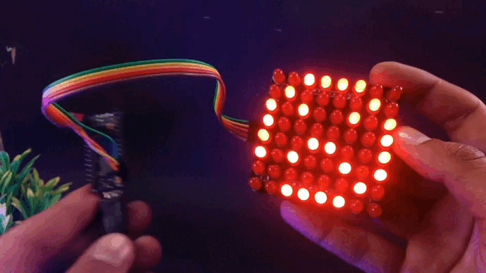

Programming of LED Dotmatrix Module -
To program the MAX7219 IC, you will need to download and install the LedControl library for Arduino. This library simplifies the process of controlling the MAX7219 IC and enables you to easily display text, graphics, and animations on the LED Matrix Display.
Connection Diagram -
Code -

Results -

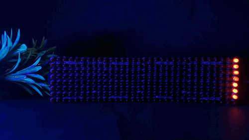

You can also add “N” No. of dot matrix simply plugin them one by one. Here I have connected 4 dot-matrix in a row but you can also connect more of them.
