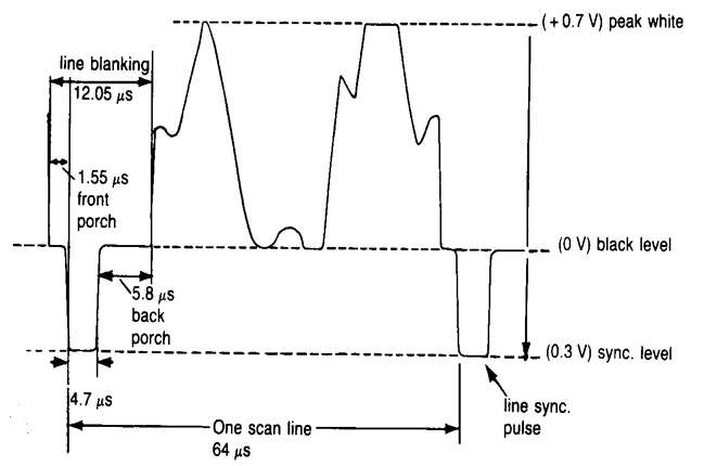

Composite video standard defines a signal with 1Vpp amplitude under a 75 Ohms. From that signal 70% (0.7V) is the amplitude of video information which stands above a 0.3V pedestal, while the synchronism information (sync tip) corresponds to the remaining 30% of the total amplitude or 0.3Volts below the pedestal.
Many projects of video generation for microcontrollers provide video signals that may work but don't respect the video standard, thus the signal generated might not be properly displayed depending upon the monitor used.
But generating a video signal with correct amplitude and impedance can be easily accomplished with the aid of resistors and some math.

With two pins for generating the Sync and Video information we can have four possible combinations from which only three are expected: Sync level, Black (pedestal) and White Level.
We need then to calculate the value of the resistors wich can provide the following voltages
Black Level    0.3 Volt @ 75 Ohms
White Level    1.0 Volt @ 75 Ohms
Sync Level       0 Volt @ 75 Ohms
