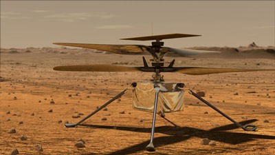

In my previous article on hackaday.io, entitled Mars 2020 Rover: Perseverance, I outlined the instrumentation on the Mars 2020 Rover. In this article I will highlight the Mars helicopter. Meet Ingenuity, a four pound helicopter drone with four foot diameter, twin counter-rotating, propellers.

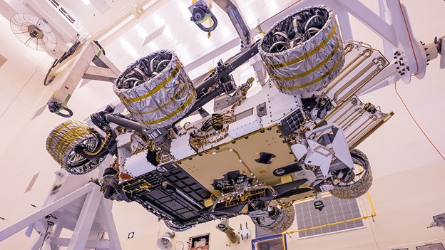

After landing on Mars, at the time Ingenuity is ready to fly, Perseverance will move 100 meters on the Mars surface and will perform a systems check on the helicopter. After this, the helicopter will have an initial flight test for as much as 30 days. The Mars atmosphere is very thin: less than 1% the density of the Earth’s. Once the helicopter is detached from the Rover, it will use its own solar panel, situated above its propellers, to generate its electrical power independent of the Rover. Figure 1.
Figure 1 The Mars Helicopter Ingenuity is shown here, in the assembly area at Kennedy Space Center, mounted to the bottom of the Rover (Image from NASA)

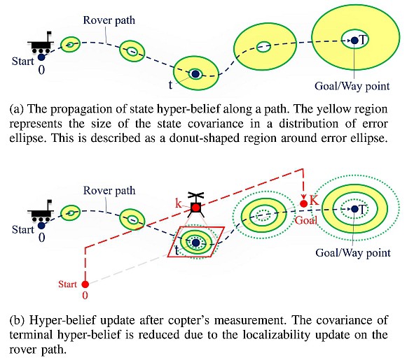

The mission concept has the copter as a scout to collect data before the beginning of Perseverance’s traverse on each Martian day. The Rover will plan an optimal path that avoids critical terrain hazards and regions with low localizability using the updated map information provided by Ingenuity.
The localizability map is first initialized with satellite measurements, and then dynamically updated by Ingenuity. Figure 2.
Figure 2 A hyper-belief propagation in the Rover’s state estimation (Image from Reference 1)
Ingenuity’s observation has higher resolution and fidelity than satellites, but the scope is smaller than the entire map.

The main challenge of a powered flight on Mars is the generation of lift in the very thin Mars atmosphere. At the surface level of Mars, the average air pressure is just 6 mbar, that is, 0.6% of the air pressure at sea level on Earth. A very high copter rotor speed between 2,300 and 2,800 r/min is needed. This is five to 10 times faster than the rotor speed of an average helicopter in Earth’s atmosphere. The mass of Ingenuity is limited to 1.8 kg to meet mission requirements. Lightweight foam-filled, 1.1-m-in-length carbon fiber rotors are used to generate the required lift while minimizing weight. Other primary lightweight structures on the copter include foam-filled carbon fiber landing legs and a carbon fiber support structure for the solar cells.

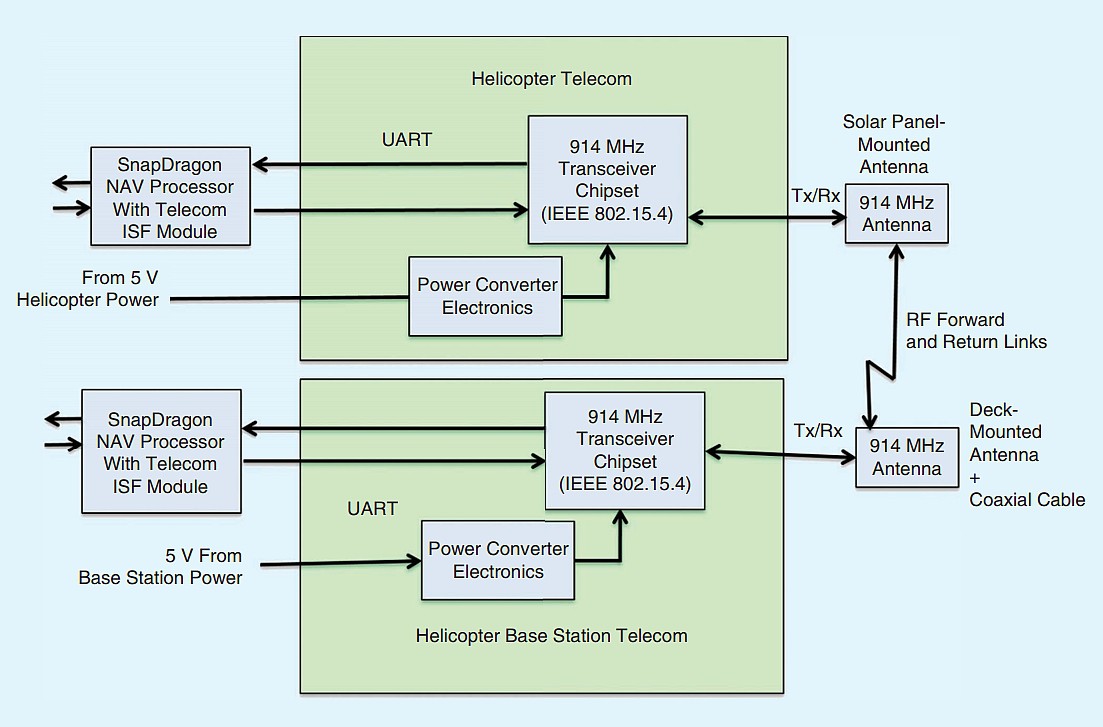

The helicopter and Rover use the same radio and Snapdragon processor. A block diagram of the telecommunication subsystem on Mars Helicopter and Mars 2020 Rover is illustrated in Figure 4.
Figure 4 This image is a telecom subsystems block diagram of the Perseverance Rover and Ingenuity copter (Image from Reference 2)
