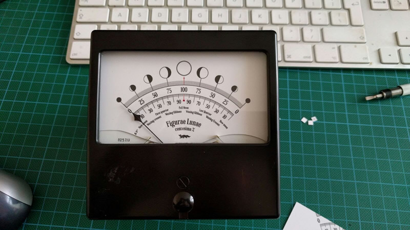

A mantle style clock that displays the phase of the moon with an large old (30/40 years) analogue panel meter
I got my hands on two old very large 12x12 cm ( 4.6x4.6 inch) panel meters which were never been used. The display was still blank. The design for the display was made in Adobe Illustrator and printed on sticker material which i laminated with matt laminator pouches.
Test fitting the new display

The Panel meter when opened
