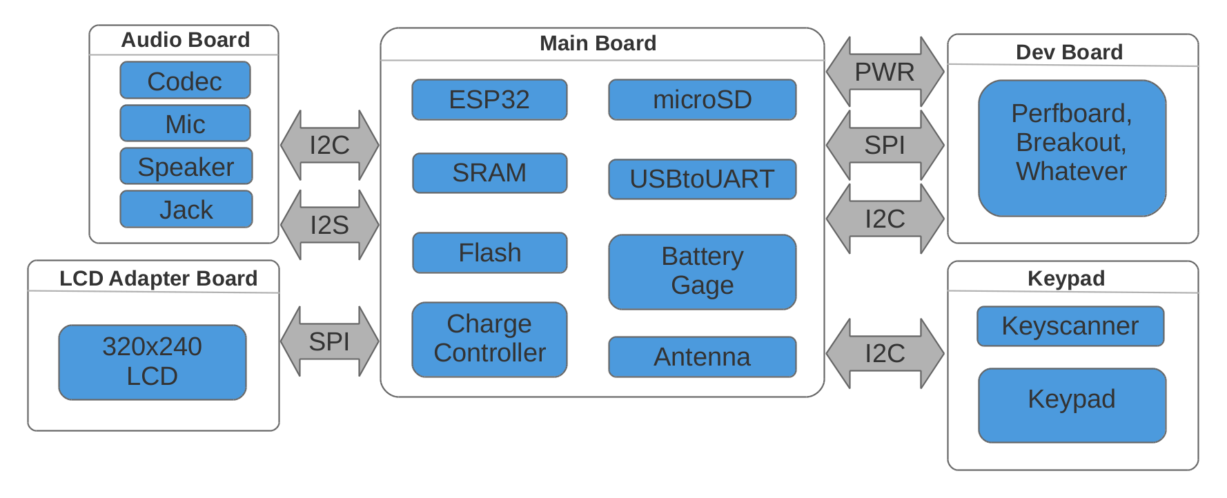

Planned Features
  • polished enough normal (non-hackers) are happy to use it as an everyday phone
  • open source
  • can call other WiPhones using the internet
  • can call smartphones or computers (using an app installed on the device being called)
  • wireless firmware updates
  • Arduino compatible software
  • Espressif ESP32 processor
  • roughly 120 x 65 x 12mm
  • 320 x 240 (2.4“) LCD screen
  • spare I/O broken out to user-accessible header
