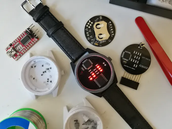

The watch has 4x4 minus three LEDs arranged in a multiplexed matrix. Where one column corresponds to one digit in digital time. The time is shown in binary coded decimal and one of digit is represented as with a maximum of four bits.
It both looks exceptionally stylish and works great with a simple user interface and battery life up to two years. Arriving at the final design was an iterative process where a lot of different problems had to be solved. In my opinion the end product turned out great and is something I love to wear on a daily basis.

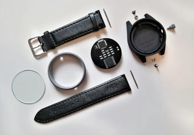

The watch body needed to be solid when put together, yet easy to open up for changing the battery or making modifications to the code. That would mean no glue where I could use something less permanent. In fact, the only glue used in this build was for the crystal glass.
The opening and closing was solved with the main body being made of two parts: the watch case back, and the front watch ring. The watch case holds all the components like the PCB, watch band, and watch crown. The watch ring holds the glass, and slides down into the case back where it's secured with two tiny screws.

2Parts and Tools
An overview over what components and tools were used in this build. More on how the parts were selected in the next step.
The components are divided among what's needed to make the PCB which acts like the watch movement, and the watch body itself.

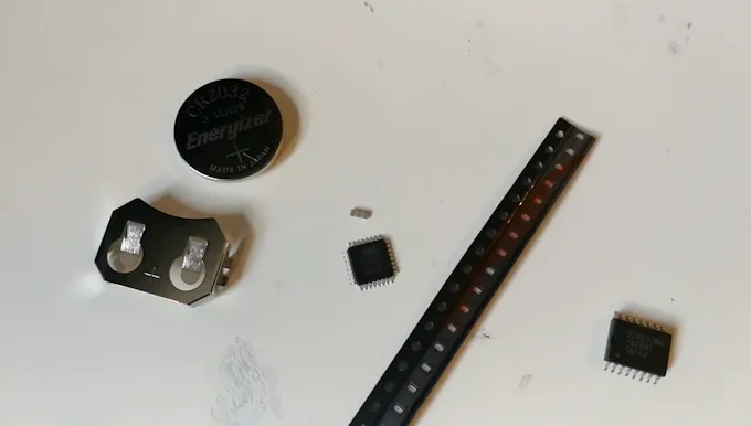

3Choosing Components
There are four main parts of the circuit board. We have the atmega328p microprocessor. This is the same as is found in popular arduino models. This is the brain and will communicate with a real time clock (RTC) module, process the time, and display this on the LEDs. All of this of course needs a power source, preferable a tiny battery.
Atmega328P
The microprocessor had to meet certain criteria. It needed at least nine pins for GPIO, eight for the LEDs and one for the push button. It also needed an I2C bus where it could act as a master to poll the RTC for the time. At lastly it had to be able to operate on low voltages and not draw exorbitant amounts of current while powered. The Atmega328P-AU nails all of these criteria while still being small enough to not eat the whole PCB area. A big plus is that it's also used for most popular Arduino boards. This means it has a lot of support and it should be familiar to work with as I'm experienced with Arduinos.
The PCB was designed to use an 8MHz ceramic resonator. However, it turned out that the processor should be clocked even lower to run on low voltages. Take a look at the picture in this step, taken from page 303 in the datasheet, which explains the ration between clock frequency and operating voltage. A clock frequency of about 4MHz should be the maximum for this project. I used the internal oscillator at 8MHz and activated the divide by 8 bit, which gives the apparent clock frequency as 1MHZ. The soldered 8MHz resonator is still needed, however it's just really needed while burning the bootloader in step 8. I didn't see any reason to remove the resonator after the bootloader was burned.
DS3231
At first I considered using the DS1307 RTC. This is a more popular chip commonly found on RTC boards ordered for cheap from China. However, this requires around a 5V power source, even though it uses a regular 3V battery for time backup. Few tiny batteries provide up to 5V so to use this chip I would need a way of stepping up the voltage. Stepping up voltage always leads to power loses, which I could not afford. Ref the second law of thermodynamics. Thanks Mr. Carnot!
The DS3231 can operate on as low as 1.8V, which is perfect when everything is driven by a battery with 3V. It also has a quartz crystal built in, which means the circuitry is easier to solder. The inbuilt clock crystal is also temperature compensated! Ambient temperature can cause a clock crystal to have irregular oscillations. This means it becomes less accurate after the first time being set. The DS3231 measures the ambient temperature and uses this in a calculation to compensate for temperature fluctuations.
When do you need a temperature compensated real time clock? You need it when the RTC is in changing temperature environments. Perfect for a wrist watch, for when you're walking in and out of different rooms or going outside, when the temperature isn't constant.
LEDs
The LEDs come in a 0603 package size - which is really tiny! They can draw up to 20 milli-amps each, but this is not really a problem. Due to the way the multiplexed LED matrix is displaying the time with column scanning, no more than three LEDs will be powered at the same time. The current is also reduced with larger than needed resistors. The light output are reduced with the current limiting resistors, so you can experiment to find the light level and current consumption you're happy with. My experience is that resistors between 100 and 400 ohm draw little current and are plenty bright.
Take a look at the table provided on listing for these LEDs. They all require the same amount of current, however the red LEDs require the lowest voltage while still providing more than 100mcd of light. All of this means that in terms of light and power, the red LED color gives you the most bang for your buck. You may of course choose other colors, but I recommend against colors that require voltages around 3V. Just because the battery voltage will decrease over the years, meaning the LEDs shut off. This leads to the weird situation where the watch is still powered and keeps the time accurately, the LEDs just require such a high voltage that the watch has no way of telling you the time.
CR2032
I wanted this to be powered by a regular old coin cell, also known as a watch battery - which is fitting. A CR2032 usually has a voltage of 3V and typical capacity of 200mAh. One drawback however is that relatively large loads may drop the voltage down to 2V. This is handled in two ways: first reducing the current load, and second not caring if the voltage drops. The current load has been reduced by using low power ICs like the Atmega328P and DS3231. It is also reduced by using current limiting resistors on the LEDs, and because the matrix is driven with column scanning no more than three LEDs are really on at the same time. Because LEDs are the components that draw the most current in this watch, this had the biggest impact. Also, so what if the voltage drops from the battery? I've prepared for that. The DS3231 can safely be powered by 1.8V, I chose red LEDs because they require the lowest voltage to turn on, and the Atmega328P has a special bootloader that's clocked at 1MHz and brown out detection at 1.8V. All this means the watch is happy to chug along with either large current loads or low voltages!
The watch circuit could be powered by a lithium cell. It doesn't have the problem of voltage reduction at the same current draws as a CR2032, but it would bring some additional problems and challenges. For this project, a lithium-ion battery would have two main drawbacks. While the capacity of a tiny cell is close the capacity of a CR2032, it needs some extra for safe charging and safe discharging. It would also need a way of connecting a charger. I prefer the option here where the case can be opened and the battery swapped right away. Lithium batteries are also a bit more dangerous to work with and just requires more care and consideration.
You may be familiar with the voltage range for a lithium-ion battery. They usually start at around 4.2 volts when fully charged, decrease quite quickly in voltage to 3.7V, before shutting off at 3.2 volts. If I was going to use such a varying voltage range to power the LEDs, I would also need some supporting circuitry to keep the LED voltage somewhat more regular. This not only adds to the complexity of an already tiny PCB, it will also consume more power. I've reduced power in every area I could, and the end result is this watch which will accurately keep the time for about two years on a regular coin cell battery!

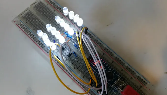

4Theory Time 1: Multiplexed Matrix
Multiplexing is a way of interfacing multiple inputs and outputs (IO) with fewer actual IOs. The configuration used in this watch is a 4x4 LED matrix with three unnecessary LEDs removing. This could control up to 16 single LEDs using only eight outputs on the microcontroller. I simply removed the three LEDs that were not needed for showing the time and date from the matrix.
To turn on a single LED simply set the selected row number to high, and the other row to low, while setting the selected column to low and the other columns to high. This means the current is provided by the row goes through the LED, and sinks into the column number.
Creating more complex shapes with an LED matrix may lead to unwanted LEDs to turn on. To prevent this most matrices are activated with a column (or row) scanning. Simply put this means that only the different LEDs in one column are turned on at the same time. This column is then disabled before the next column is activated. All this happens more quickly than the eye can perceive. The result is the impression that the LEDs in the different columns are turned on at the same time, creating a complex picture.
The watch has the matrix rotated 90 degrees between the schematic and the PCB to make coding easier. This was done so one time digit was stored in its own byte on the arduino code.

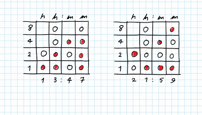

5Theory Time 2: Binary Coded Decimal
Binary Coded Decimal as mentioned in the second step codes individual decimal digits as their own binary number. The main benefit in this case is how much easier it becomes to actually read the time. It's so much easier to read each time digit 2 (10), 3 (0011), 5 (101), 9 (1001), than reading the complete number at once 2359 (100100110111).
So how do you read the time with BCD?
I'm glad you asked. The lowest row on the watch represents the least significant bit and the upper row is the most significant bit. The row from the bottom to the top has the values: 1, 2, 4, 8. So each digit has its value coded upwards and you read the digits from left to right.
When an LED is activated in a particular row and column you should count this value. When the LED is off just ignore the value. To read the first digit simply sum all the activated LEDs corresponding values, and keep this digit in mind while reading the next one. Take a look at the picture. Are you able to tell the time?
The reason for the 13 LEDs on the watch are that these are just the LEDs needed for showing all the possible combinations for the time of day.

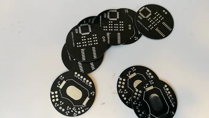

6Creating the Circuit
Okay so we've talked a lot about parts of the circuit and the reason behind the components. Now let's put it all together in a complete circuit! The PCB was made round to make a callback to regular watches. A standard watch body is usually 42mm with a glass diameter of 38mm. That's the outer edge of the glass. However if the glass rests on a 1mm wide lip, the available diameter is suddenly 36mm. This meant I could give the PCB a diameter of somewhere around 35mm if I wanted some margins when everything fit together.
The PCB was designed in Autodesk Eagle and you can download the GERBER files here. I had them produced from JLCPCB.com who has a 10 unit for $2 deal. I'm satisfied i\with the quality and have uploaded a few pictures on this step. The PCBs were made for me at a thickness of 0.8mm, but 1mm should work fine as well. And once again because I wanted this to look stylish, I ordered the PCB with a black solder mask to match the rest of the watch.
After the PCBs were delivered there was part of the silk screen that was their production number. This is often used as a way for the factory to identify which PCBs in a order go together. Usually this number doesn't matter at all. However because the front of the PCB was going to be displayed in all it's glory, I had to remove that number. Luckily this turned out to be easy. I just scraped it off with the end of an USB-C cable. You can really use any flat and hard edge, like a coin or spatula. Just be careful not to scrape with too much pressure or you can scrape the solder mask off the traces. Practice on the backside of the PCB to get the right feel for removing the silk screen.

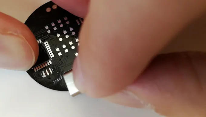

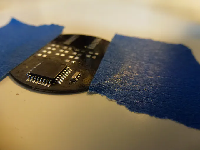

7Soldering
The very best way of keeping a circuit board still while soldering is with your old friend: masking tape. A couple strips will keep the PCB dead still while you wave around the soldering iron.
I started with all the components with the lowest profile and completed the front side before doing the back. When soldering tiny SMD components and especially when soldering SMD chips, you need a lot of liquid solder flux. These come in various applicators like flux pens or squeeze bottles. I have a bottle with a tiny brush in the lid.
Start by tacking down one side with some pre-melted solder and stick the component in place, making sure to align it the way you want it. Now apply liquid solder flux, melt some solder on the tip of your iron and touch this to the unsoldered points. Easy as that! Use this easy process to solder all the components except the button.
If you apply more solder than needed and short chip pins clean the tip of your iron and reheat where its too much solder. The surface tension of the liquid solder should pull a small amount of it onto the iron. You may have to repeat this step a few times until all the excess solder is removed.
While flux is magic for it's solder-flowing-abilities it's more like dark magic for its electrical-noise-inducing-abilities. Flux, when left on a PCB may let current flow where you don't want it. In other words it can disturb sensitive signals like from the ceramic resonator. To avoid unwanted noise the flux is cleaned off with rubbing alcohol and, well, rubbing with some thick tissue paper or q-tips.

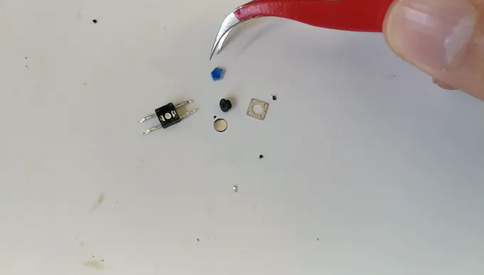

8Button Modifications
As you may have noticed the watch crown on the side of the watch is what you press to wake the watch from sleep. This crown had to be inserted into the body from the outside, should not be possible to accidentally pull out after assembled, and needs to activate an interrupt button connected to the microcontroller. I'm quite pleased with the solution.
Most cheap, tactile push buttons you're used to seeing have a small, round, black, plastic part you push on to make the leads conduct current. This black plunger is removed and instead replaced with the end of the watch crown.
The button is opened by using flush cutters to remove the four plastic rivets on the front side of the button. Now the metal cover can be removed and on the inside you find the plastic plunger and a flexible metal disk. The disk is what actually makes contact between the button leads when the plunger is pushed.
Remove the black plunger and reinsert the metal disk. I used a small bit of rolled of masking tape to keep the disk from shifting positions after it was inserted. Now add the outer button cover again and secure it with some super glue. The result is a push button with an open hole that can be activated by pushing a sharp object into the opening. The sharp object we're using is, of course, the end of the watch crown.
The button modifications are finished and it can be soldered at a right angle on the underside of the circuit board.

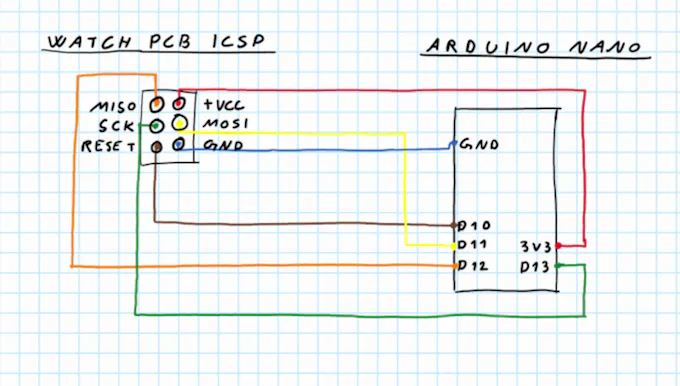

Now we need to use an Arduino as an ICSP programmer to actually burn the bootloader to our watch circuit. I used an Arduino Nano. Connect the master Arduino in the schematic attached to this step. Go into Arduino examples and open the "ArduinoISP" example code. Upload this to the master Arduino.
At this point we're ready to configure the bootloader we want to burn, but first set the Tools > Programmer: to "Arduino as ISP". Select the following configuration from the MiniCore bootloader. You may also want to double check your configuration to the configuration in the picture attached to this step.
Bootloader settings
- Board: ATmega328
- Bootlader: Yes
- Clock: 1 MHz internal
- Compiler LTO: Disabled
- Variant: 328P / 328PA
- BOD: 1.8V

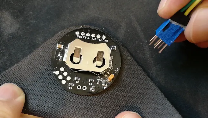

Now the final step is to connect the ISP wires from the master Arduino to the watch circuit. You can press these onto the programming points on the backside of the watch PCB. Because I had to experiment with a lot of different bootloaders and fuse settings, including trying to make my own modifications at some point, I soldered female headers to the programming points to make it easier to experiment.
With the ISP wires properly in place select the option Tools > Burn Bootloader. Wait for a short while and you should receive a success message. If you don't there are two probable reasons. The main culprit is usually the resonator. Try to resolder and reclean this part before trying again. If you have access to a proper scope, minimum 16MHz sampling frequency, try to probe the resonator points. If it's properly soldered you should get nice, smooth sine curves. Another possible source of error is the ISP wires don't have a proper connection if you're just pushing them down. Either adjust your grip and try a few more times, or solder the wires or female headers onto the programming points.

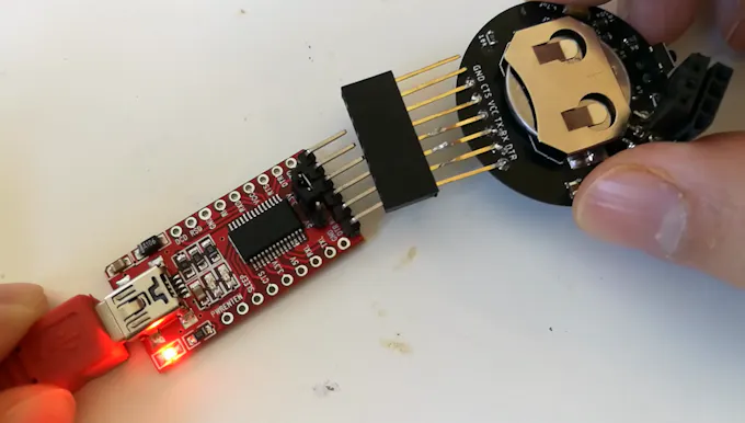

10Code
When the bootloader is burned to the microcontroller, an FTDI converter can be used to upload the actual Arduino code. The code could actually be uploaded through ICSP replacing the bootloader, but I didn't really want it that way. That would make it harder to upload new code if I did any changes in the future, and the serial terminal couldn't have been used to communicate with the microcontroller. As you probably know, the serial terminal is incredibly important while debugging a project, so I didn't want to remove that ability. And after all, adding the FTDI connection points didn't complicate the PCB in any way. That left a lot of great reasons for it being added, and no real reasons for removing it.
To upload the code first open the sketch I've attached here. Connect an USB FTDI adapter to the serial programming points. Once again, these connections can either be pressed onto the PCB or connected by soldering the pins or female headers that has to be desoldered later. I used female headers.
When uploading make sure you keep the same exact board settings used for burning the bootloader. The time on the RTC is set whenever the code is compiled and uploaded. When you have the first successful upload comment out the line at 35, which compiles the time, and upload once more. This is the line responsible for reading the time and adjusting the RTC. By removing this line the time will not be set the original compilation time, if the code where to randomly reset at some point.
