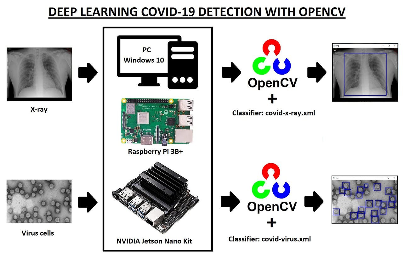

Detecting COVID-19 with OpenCV Classifiers
PC, Raspberry Pi and Jetson Nano: 1) Detecting COVID-19 in X-ray with OpenCV; and 2) Detecting COVID-19 Virus Cells with OpenCV
Public Chat
Coronavirus disease 2019 (COVID-19) is an infectious disease caused by severe acute respiratory syndrome coronavirus 2 (SARS-CoV-2). The disease was first identified in December 2019 in Wuhan, the capital of China's Hubei province, and has since spread globally, resulting in the ongoing 2019–20 coronavirus pandemic. Common symptoms include fever, cough, and shortness of breath mainly. https://en.wikipedia.org/wiki/Coronavirus_disease_2019
The time from exposure to onset of symptoms is typically around five days but may range from two to fourteen days. While the majority of cases result in mild symptoms, some progress to viral pneumonia and multi-organ failure. To make this project I was inspired by the next work: https://www.pyimagesearch.com/2020/03/16/detecting-covid-19-in-x-ray-images-with-keras-tensorflow-and-deep-learning/
Goals:
  • 1 --> Make the Classifier: covid-x-ray.xml
  • 2 --> Make the Classifier: covid-virus.xml
  • 3 --> Testing the Classifiers on the PC
  • 4 --> Testing the Classifiers on the Raspberry Pi 3B+
  • 5 --> Testing the Classifiers on the NVIDIA Jetson Nano Kit

Schematic diagram
JPEG Image - 401.17 kB - 05/20/2020 at 18:58
