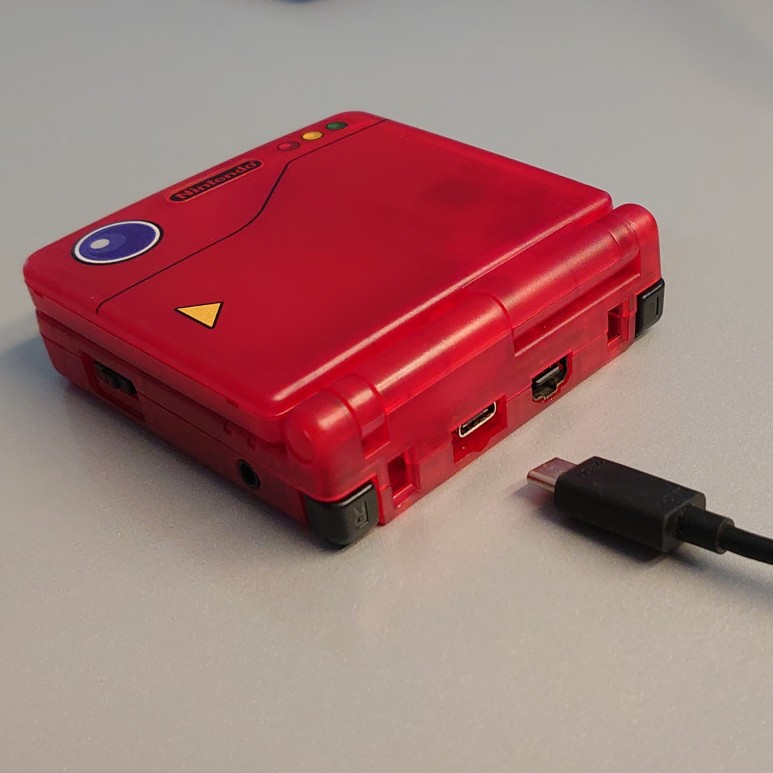

For 3.5mm headphone jack, use the following.
The terminals below are for the tip, ring 1, ring 2 and sleeve structure.
Two terminals are located on Ring 2, so it can be used regardless of 3-pole or 4-pole.
For the GBA SP bottom shell, just make the space between the battery terminal and the battery latch as above.
Hi, thanks for this mod ! I have seen yt videos where people would connect the wire at other spots on the motherboard, like in this video at 4:12
https://youtube.com/watch?v=MOywVfRrYTg&si=EnSIkaIECMiOmarE
So i’m wondering if the placement of the wires matters ? Wich one is the best ? Thanks !
