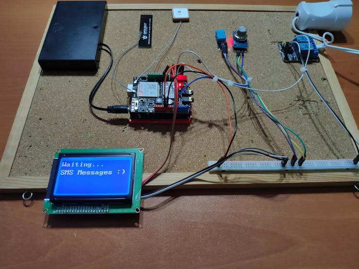

Connect the DHT11 Temperature and Humidity Sensor, the MQ-135 Gas Sensor, and the 2-Way relay to the Arduino Uno.
Attach a plug to the 2-Way relay to be able to control the cooling fan easily.
After making connections, I fastened all components to a corkboard. As you may have realized, I used the base of my previous project (ORP Water Quality Detector) to create this project. In this way, I can switch back between projects by merely adding or removing sensors :)

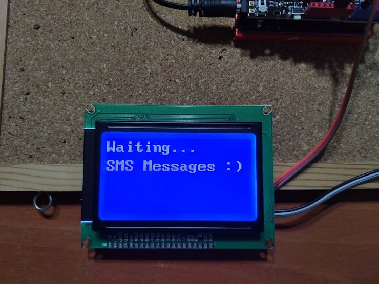

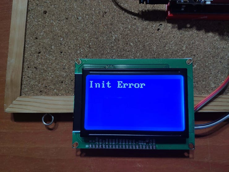

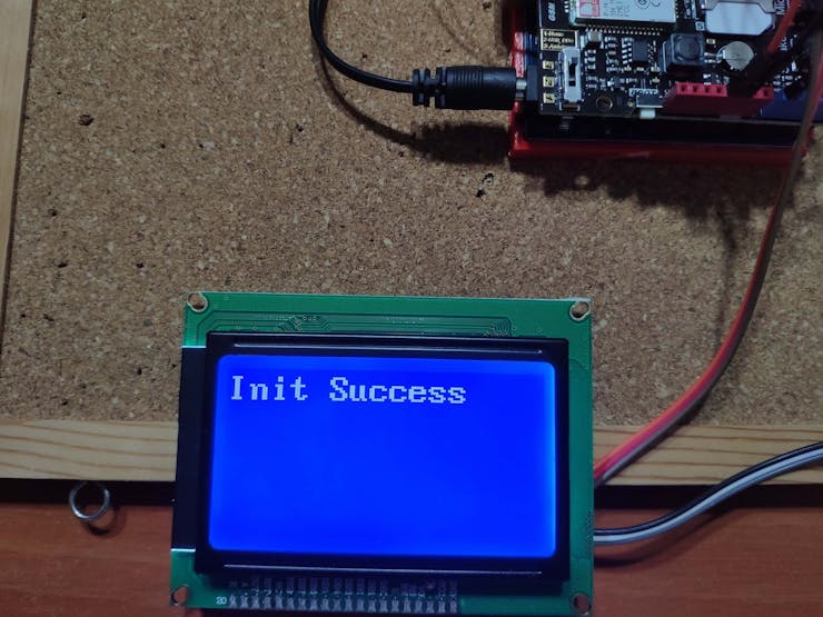

1) The device throws an error message (Init Error) until the SIM808 connects to the GSM network.
2) When the SIM808 connects to the GSM network and works properly, the device shows a confirmation message (Init Success).
3) The device always returns to the home screen after receiving and interpreting SMS messages to let the user know it is ready.

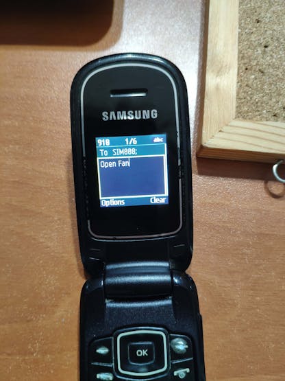

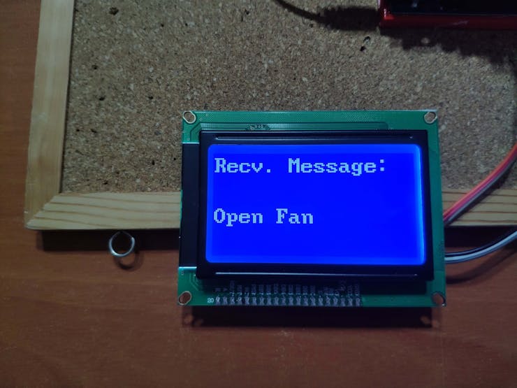

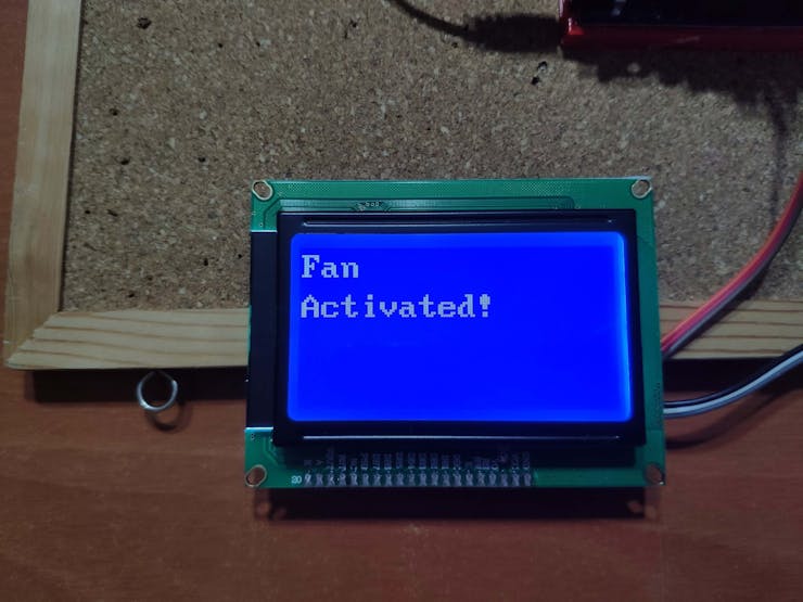

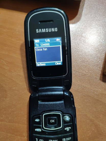

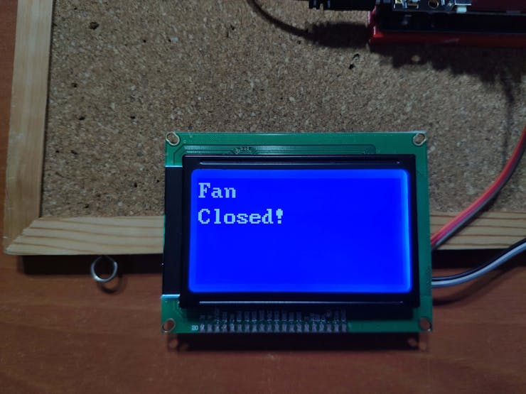

4) If the device receives Open Fan as an SMS message, then it activates the cooling fan.

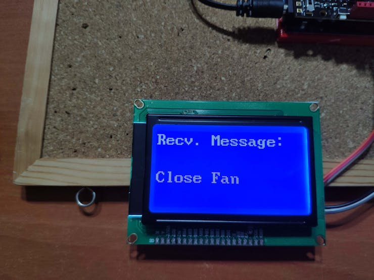

5) If the device receives Close Fan as an SMS message, then it turns off the cooling fan.

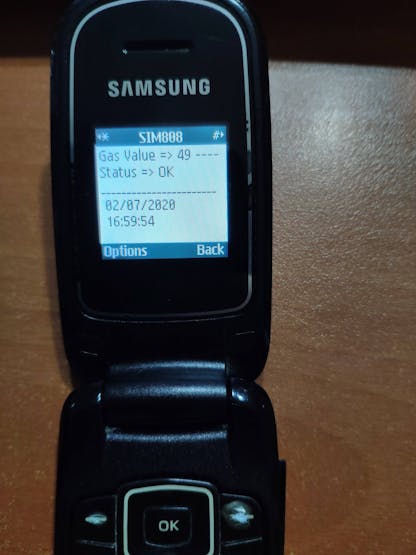

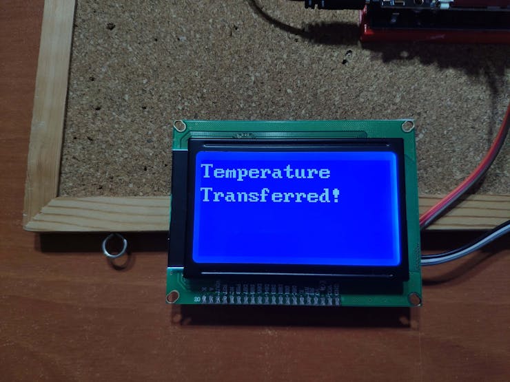

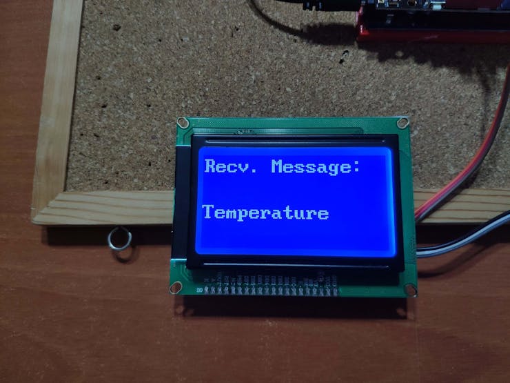

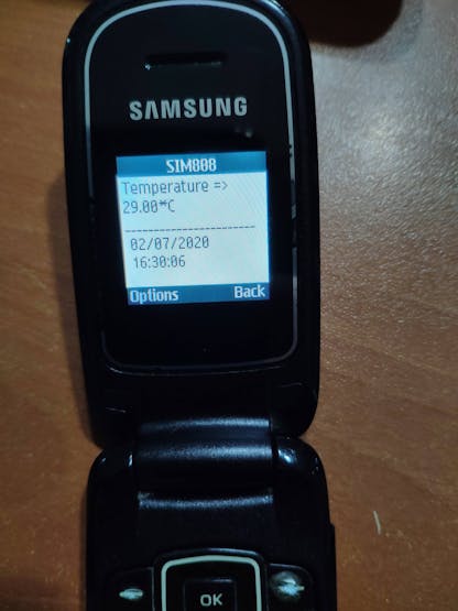

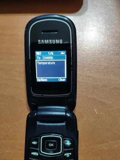

6) The device sends a feedback SMS message, including the current temperature detected by the DHT11 module, to the given phone number if it receives Temperature as an SMS message.

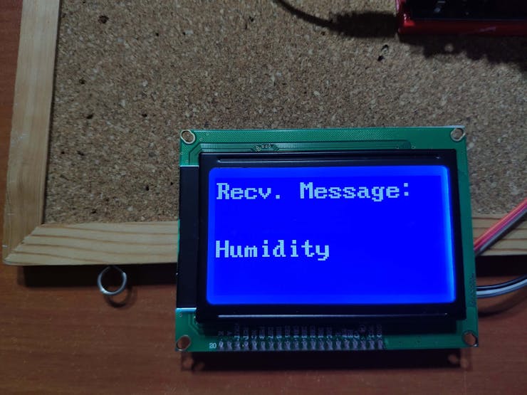

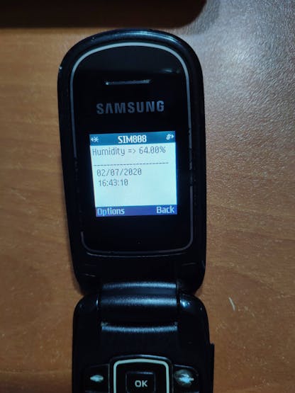

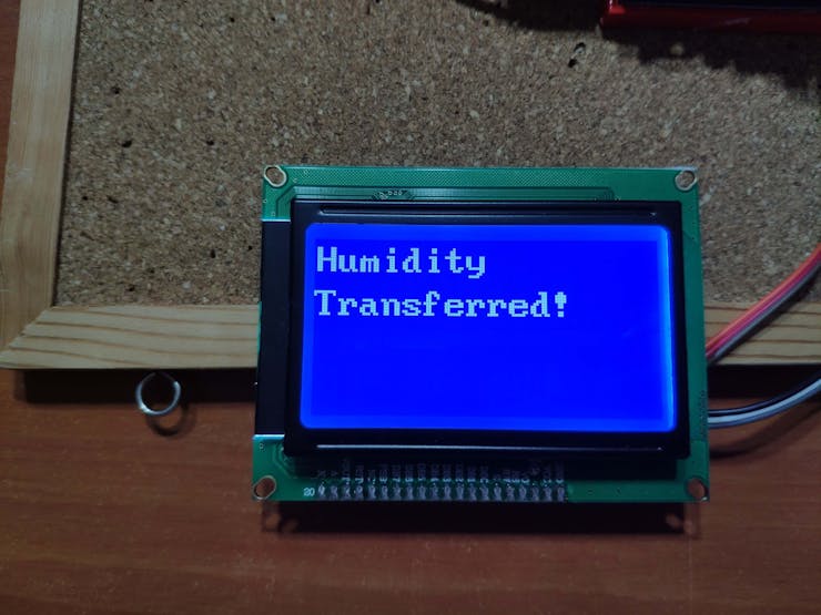

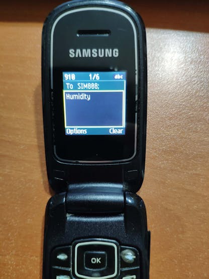

7) The device sends a feedback SMS message, including the current humidity detected by the DHT11 module, to the given phone number if it receives Humidity as an SMS message.

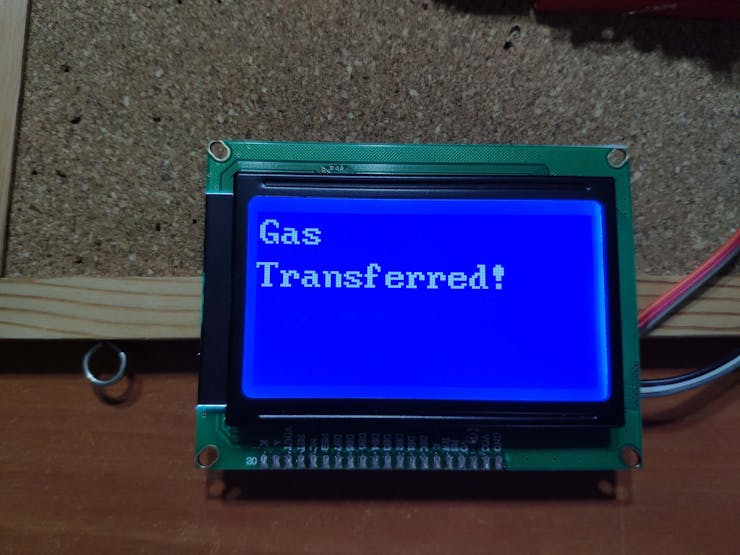

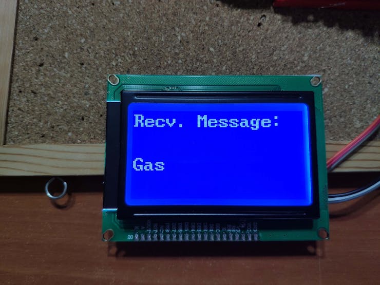

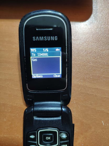

8) Depending on the gas value detected by the MQ-135 module, the device sends a feedback message including the gas status (OK or DANGER) with the current gas value to the given phone number if it receives Gas as an SMS message.
