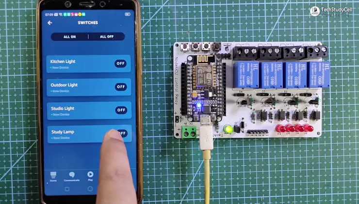

Control Relays With Voice Commands Using Alexa
If the NodeMCU is connected with the WiFi, then you can control the home appliances from Amazon Alexa App and also from the manual switches.
You can control, monitor the real-time status of the relays in the Alexa App from anywhere in the world.
You don't need an Alexa device for this home automation project.

 Configure the Alexa App for This Smart Home System
Go to "More", then select "Skills & Games" Search for Sinric and tap on "Sinric". Tap on "ENABLE TO USE"
 Connecting Devices With Alexa
Log in with the Sinric account credentials.
Goto Alexa and tap on "DISCOVER DEVICES".
It will take a minute to add devices. During this time the NodeMCU should be connected with the WiFi.
Tap on "Devices", and tap on "Switch" to see all the devices.

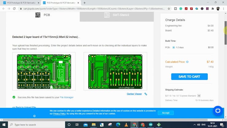

Design the PCB for This Smart Home System
To make the circuit compact and give a professional look, I have designed the PCB after testing all the features of the smart relay module.
You can download the PCB Gerber file of this home automation project from the following link:
https://drive.google.com/uc?export=download&id=1Jx4D_DSV_ei1y0a82AbtxbsNhy8sjCmY
Order the PCB
After downloading the Garber file you can easily order the PCB
1. Visit https://jlcpcb.com and Sign in / Sign up
2. Click on the QUOTE NOW button.
3. Click on the "Add your Gerber file" button. Then browse and select the Gerber file you have downloaded.
Uploading the Gerber File and Set the Parameters
4. Set the required parameter like Quantity, PCB masking colour, etc.
5. After selecting all the Parameters for PCB click on SAVE TO CART button.

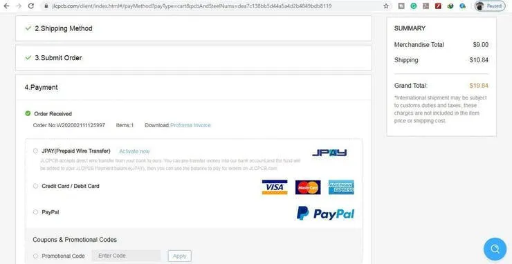

Select Shipping Address and Payment Mode
6. Type the Shipping Address.
7. Select the Shipping Method suitable for you.
8. Submit the order and proceed with the payment.

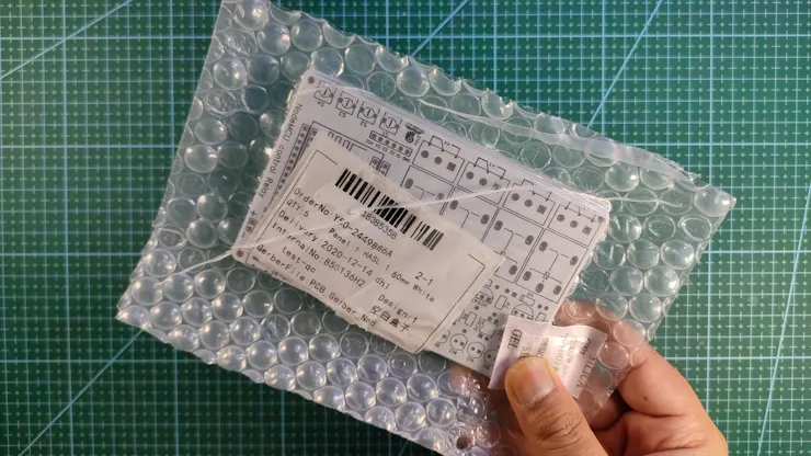

You can also track your order from the JLCPCB.com.
My PCBs took 2 days to get manufactured and arrived within a week using the DHL delivery option.
PCBs were well packed and the quality was really good at this affordable price.

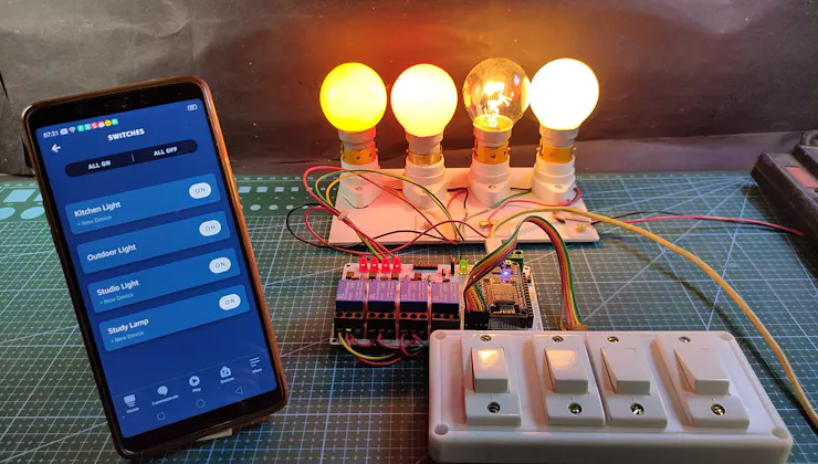

Testing the NodeMCU Home Automation Circuit
After uploading the code, if the NodeMCU connects with the WiFi, the blue LED will turn on.
Then you can control the relay module from Amazon Alexa App.

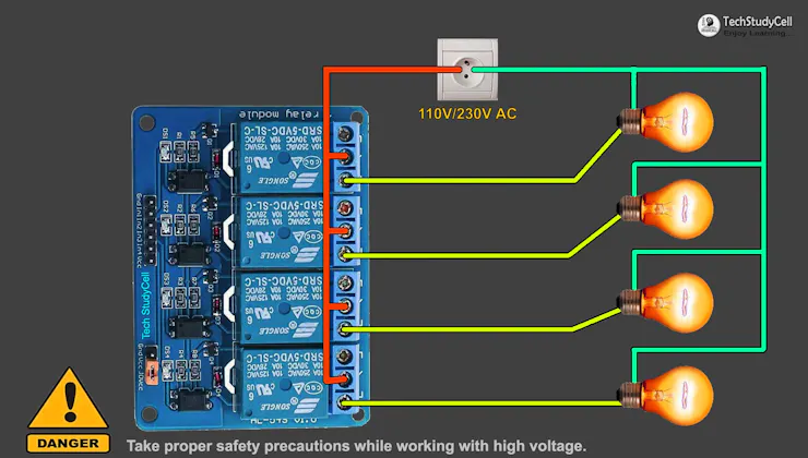

Connect the Home Appliances with Relay Module
Connect the 4 home appliances as per the circuit diagram. Please take proper safety precautions while working with high voltage.
Connect 5-volt DC supply with the PCB. (I have used my old mobile charger)
Turn ON the Supply
Turn on the 110V/230V supply and 5V DC supply.
Finally!! the Alexa Home Automation System Is Ready
Now you can control your home appliances in a smart way.
