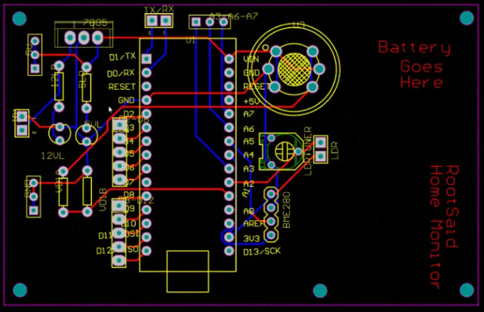

Let’s get started! I designed a circuit and PCB using Altium PCB Designer. It is great for designing complicated circuits, as well as multi-processor boards and industrial use cases. The link to the trial version will be in this description; definitely check it out if you’re interested!
This is the circuit. Here we have Arduino Nano, a gas sensor, LDR, and a BME 280 sensor. This is the voltage input terminal, where we can connect a nine-volt battery or a 12-volt dc adapter. This 7805 voltage regulator will convert any voltage between 7 to 32 volt to a steady 5 volt supply. This 5v can be fed to Arduino and other components or if you are using Arduino Nano you can connect this Vin directly to the Vin pin of Arduino.
And then we have a gas sensor. There are different types of gas sensors depending on which gas you want to measure – there are methane sensors, carbon monoxide sensors, LPG sensors, you can choose the one depending on your needs. The output of the gas sensor is connected to pin a1 of Arduino.
Then we have an LDR. A trimmer is connected at this point so that we can adjust the sensitivity of this LDR and the output of LDR is connected to pin a2 of Arduino. The BME 280 is the sensor that we will be used to sense the temperature, humidity as well as pressure. The Vcc pin of BME 280 is connected to 3.3 volts of Arduino, the ground is connected to the ground, and SDA and SCL are connected to SDA and SCL Arduino. Basically, this is our circuit.
Once the circuit was finished and tested, I designed a compact PCB using Altium, where I can fix all the components neatly. Here you can see routing is on both sides of the board which means it is a dual-layer PCB. Now all I have to do is export the Gerber file.

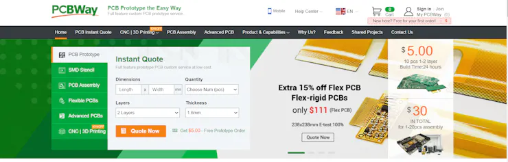

I ordered PCB from PCBWay. PCBWay is a PCB manufacturer specializing in PCB prototyping, low-volume production, and neat and tidy PCB assembly.
To order your PCB from PCBWay, go to the PCBWay website and fill in the basic board details in the instant order form. From there you will be directed to a form where you can provide more elaborate board details. Update your board information in the PCB specification screen. On the next screen, you should be able to upload your Gerber file and submit it for review. Once the review is completed, all that is left is to add to the cart, make payment, and wait for your PCBs to arrive.

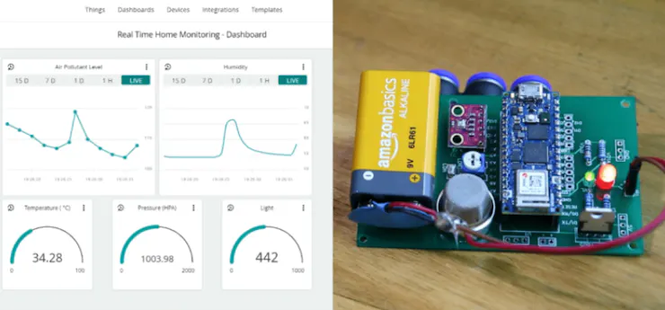

Here we are in the Arduino IoT cloud. Here you can see I have already created a device called a real-time room condition monitoring system. So if we go inside that you can see five variables named humidity, light, value, oxygen value, pressure, and temperature, and here you can see I have already linked this project to this Arduino board RP 2040 which is my Arduino Nano RP 2040 and below that under the network tab.
I have entered my WIFI SSID and password which the board will be using to connect to the internet and send all the values to Arduino IoT Cloud. Here we have a dashboard that will help us to visualize all the parameters.
This is done by creating different panels for different variables and linking all the panels to the corresponding variables. If there is any change in temperature the value of the temperature changes and the gauge will change. The same goes for all the dashboards.

Lets Turn It On!
Now, let’s do a demo. See what happens when I blow onto the board, cover it with my finger, increase the ambient light, etc.
