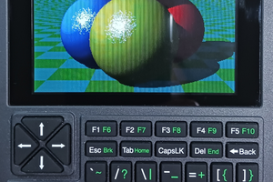

The finished product:
Intended usage:
When you turn on LegGO, it automatically displays the selected PDF file (we call it "setlist") in full screen on the LegGo monitor.
You can Then  browse the pages back and forward with two pedals.
A pushbutton is provided to alternate positive/negative view of the page (i.e. black text on white background or white on dark), according to the lighting conditions of the stage.
