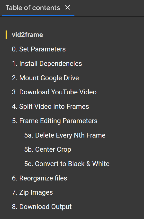

This program will take a video file from Google Drive, Google Colab, or directly from YouTube as its source. It will then output a series of images compressed into a zip file. The Colab notebook is broken up into the following steps:
0. Set Parameters
1. Install Dependencies
2. Mount Google Drive
3. Download YouTube Video
4. Split Video into Frames
5. Frame Editing Parameters
6. Reorganize files
7. Zip Images
8. Download Output

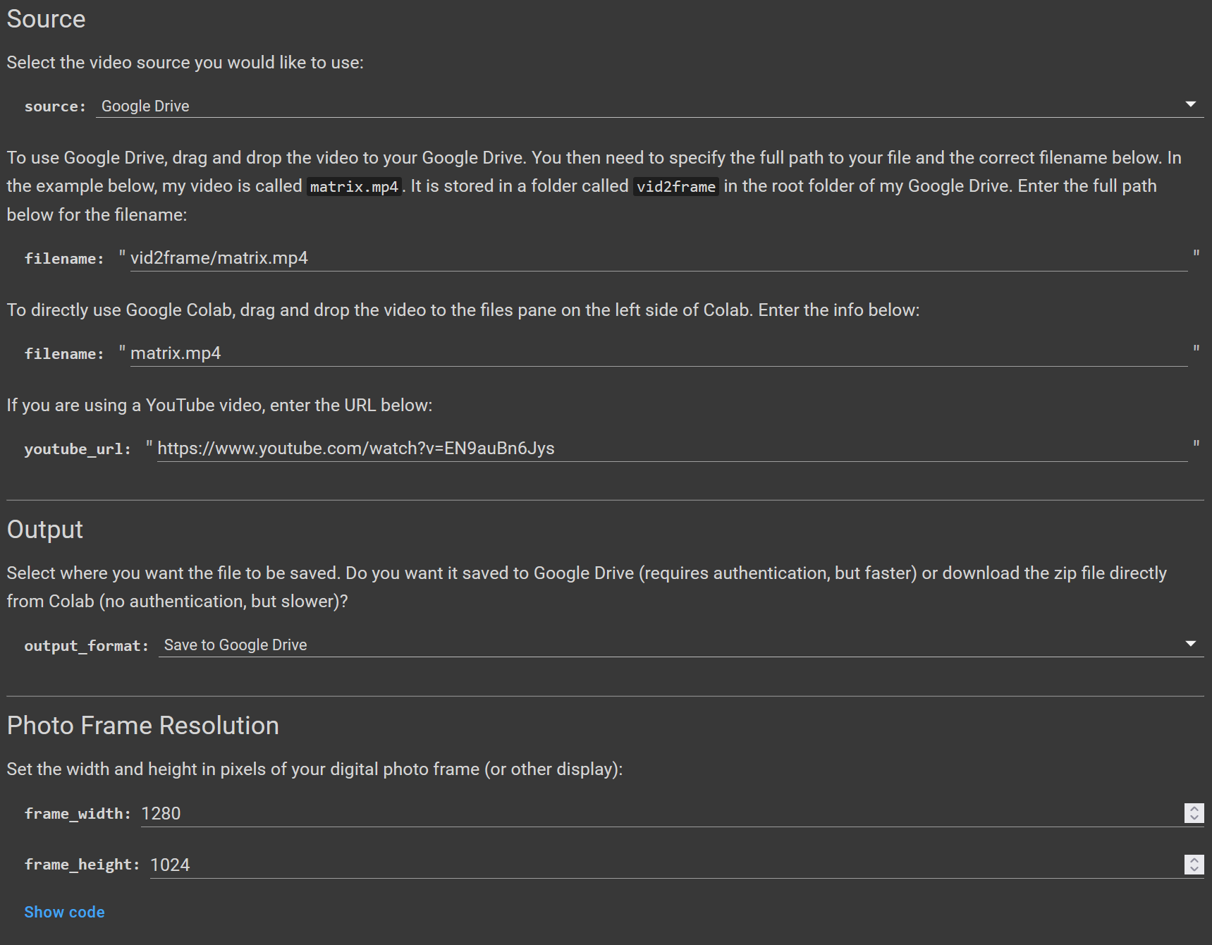

Set Parameters
You need to configure the settings for your specific configuration based on the input and output format. First, you need to select your input source: Google Drive, Google Colab, or YouTube. If you uploaded the file to Google Drive or Google Colab, you will need to specify the filename. If you selected YouTube, you will need to enter the URL. Finally, you will need to specify the resolution of your digital photo frame in pixels.
Google Colab has a lot of common libraries and programs installed by default. The only dependency we will need to install is yt-dlp if you selected YouTube as your source. yt-dlp is a youtube-dl fork with additional features and fixes.
