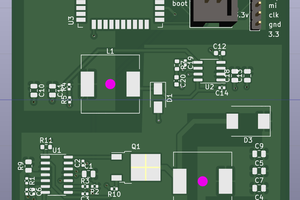

After creating the electronic schematic, the following layout of this printed circuit board was obtained. From this circuit, it is possible to control the WS2812B LEDs.
There are two ways to control them with the ESP8266. You can use WLED firmware or WS2812FX library (Arduino IDE).
In this project we will use the WLED library. It consists of a firmware and an application. Through the app you can register several devices on your WiFi network and control them through your cell phone.
