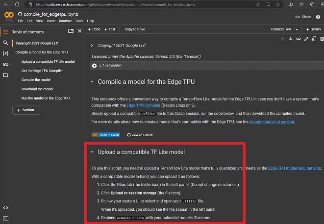

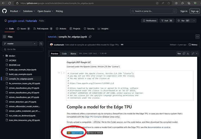

The path, that worked well in the end was compiling in Colab instead. There is a github repository with a Jupyter notebook: Compile for Edge TPU.The missing link is the edge tpu compiler. But when you try to install this compiler on the Raspberry Pi as described here: Edge TPU Compiler, the installation fails. There are examples, where the compiler was made available for the Pi: Edgetpu compiler for ARM64. However, trying it out I got an error message "Internal compiler error. Aborting!", something was missing.
![](https://cdn.hackaday.io/images/1417221716780211346.jpg)

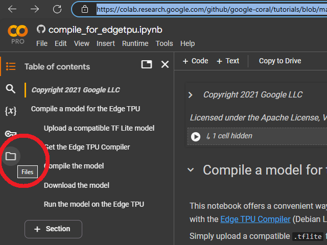

Clicking on the "Open in Colab" button will get will you to Colab.
![](https://cdn.hackaday.io/images/7726341716780282801.jpg)

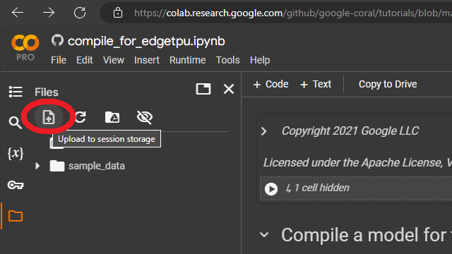

To compile a file, just follow the description. Click on the file icon on the left.
![](https://cdn.hackaday.io/images/936061716780350662.png)
The hit the upload icon, navigate to the location on your local machine and select the .tflite file to upload.

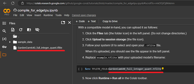

Then enter the file name into the code cell and hit "Run All" from the "Runtime" menu item.
![](https://cdn.hackaday.io/images/1999961716780414393.png)

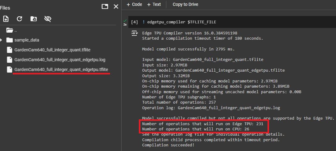

Check the compiler output for results to see that there are operations assigned to the TPU. The compiler output file will be downloaded automatically to the Download folder of the local machine.
