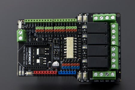

4 Channel Relay Shield
![](https://hackster.imgix.net/uploads/attachments/351001/_dsc0617-450x300_NTVgq8jEhQ.jpg?auto=compress%2Cformat&w=680&h=510&fit=max)
- Compatible with Arduino UNO Rev3
- 4 buttons to test module
- LED status indicator of relay
- Support Xbee IO directly control
- Xbee socket for wireless communication
- Selectable digital IO pin for control(Default digital 2,7,8,10)
- 6 channels Analog IO & 13 channels Digital IO
- Up to 4 Relay with photo-coupled circuit
- Contact Rating : 3A AC 120V / DC 24V
- Max Switching Voltage : AC 240V / DC 60V (Less than 38V is recommended)
- Max Switching Current : 5A
- Max Switching Power : AC 360VA / DC 90W
- Electrical Life (Min) : 100,000 Operations
- Mechanical Life (Min) : 10,000,000 Operations
- Safety Standard(relay) UL cUL TUV CQC
- Coil Working Voltage 9VDC
- Working temperature -30℃ to +85℃
- Working Humidity 40% - 85>#/li###
- Size: 95x65mm
