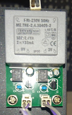

Finished the separated isolated supplies for the panel meters (these are nothing else just a simple dual 7809 based linear supplies):

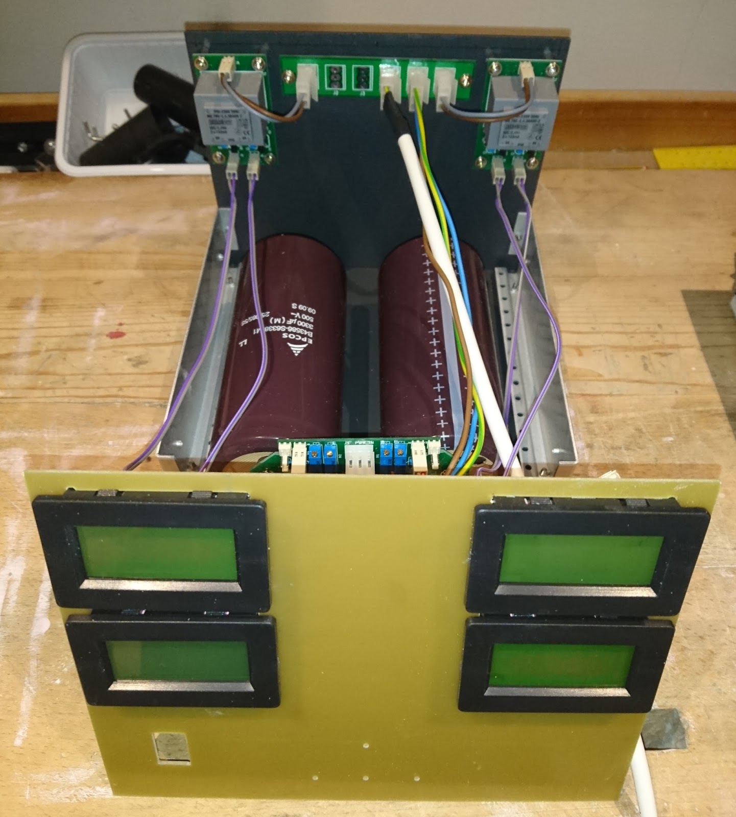

Also added the power distributor and some wiring for the backpanel:
Connected the panel meters and, milled parts of the front panel (manually as my CNC mill is still broken)
How the whole thing looks like today:
And its working, partially:
As you see the decimal dot is on the bad place (it is more likely 330V than 33V)
In addition I took a picture of the board on thermal camera. You can clearly see that the two capacitor draining resistors getting warm:
So I can tell, it is progressing, but quite few things still ahead of me:
