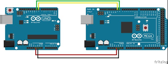

Follow steps to connect two Arduinos using software serial:
Assuming we use pins 8 and pin 9 for RX and TX on both Arduinos, connect pin8 on one Arduino with pin 9 on the other one, and pin 9 on the first Arduino to pin 8 on the second one.
  • Connect the GND of both Arduinos together.
  • If we don't power up both Arduinos via USB, then we need to power up at least one and connect 5V on each together.
