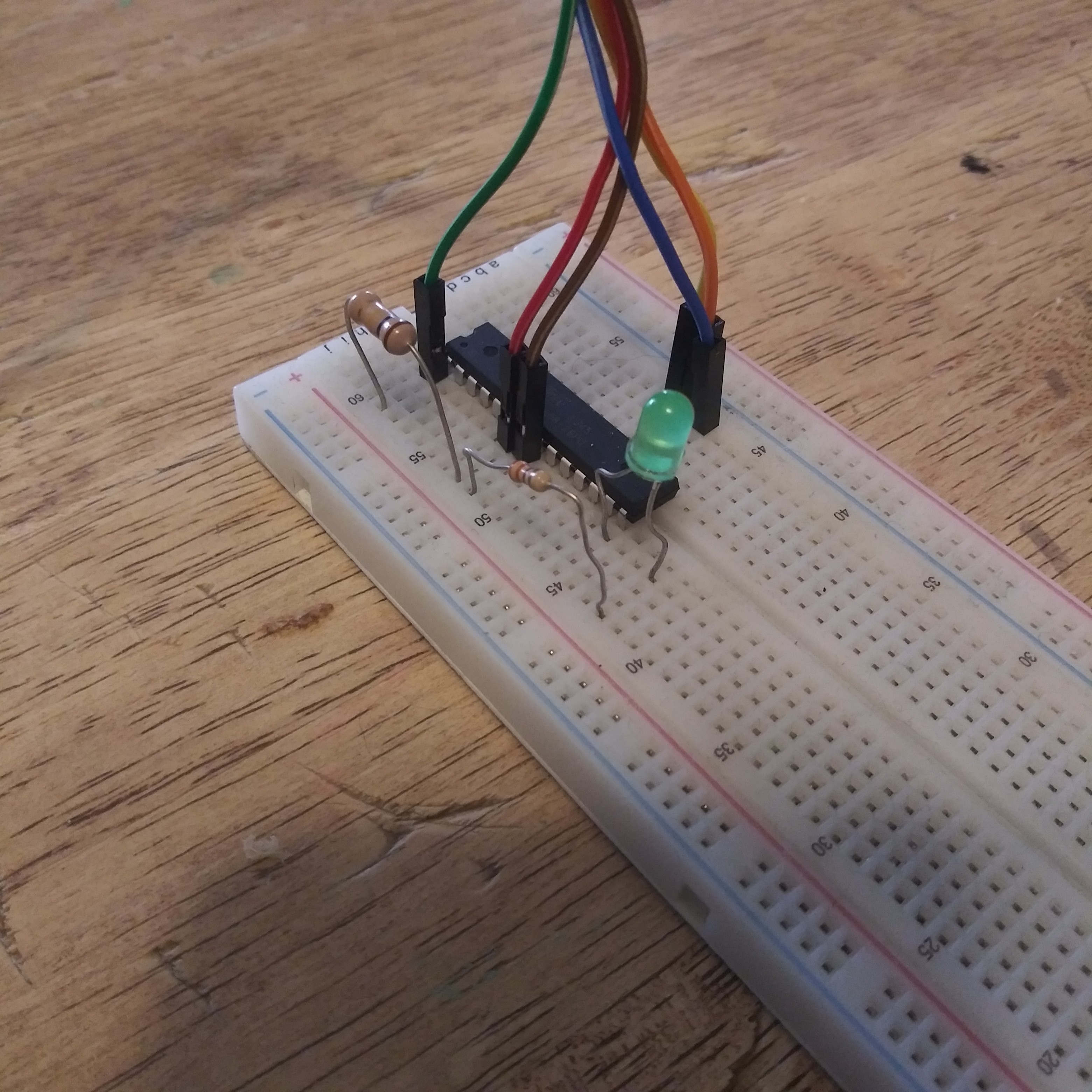

So by now we've done alot of work and still haven't done any actually programming.  But dont worry, we are about to get started.  First lets connect a LED and 330ohm resistor to the PORTB.0 Pin.

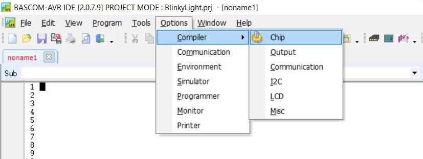

Open up BASCOM and start a new project/file.  It may already be open with a blank page and ready to start typing.  First we need to write some parameters that the compiler will use.  Its a little much information for some one who has never programmed before but luckily there is a shortcut for this.
First click options=>compiler=>chip

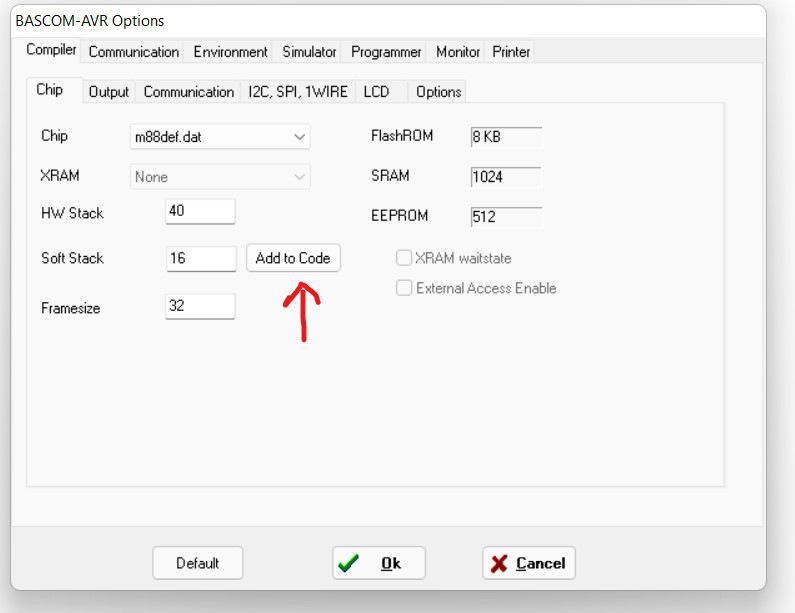

Under chip, find your microcontroller under the drop down menu.  These will be slightly cryptic with labels like 2313.dat or m8def.dat.  Find the one that most closely matches your microcontroller.  Since I am using a Atmega88, I choose m88def.dat.  Next click add to code and hit cancel.  This code (or similar) should appear at the top of your screen.
$Regfile="m88def.dat"     ' specify the used microcontroller
$crystal = 4000000        ' used crystal frequency
$hwstack = 40             ' default use 40 for the hardware stack
$swstack = 16             ' default use 16 for the SW stack
$framesize = 32           ' default use 32 for the frame space

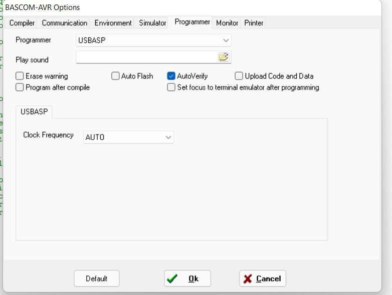

First lets make sure we are set up and ready to send the program.
Go to Options=>Programmer and make sure USBasp is selected

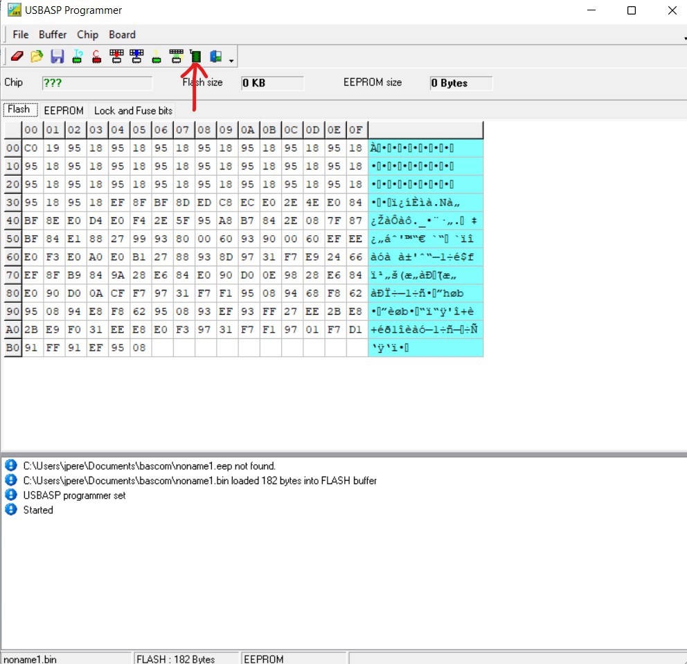

Next, lets compile.  Compiling will turn out code into something that the microcontroller can actually use.  To compile go to Program => Compile.  You can also hit F7 as a shortcut.
This is generate a few new files in the folder where you saved your program originally.   For right now, we dont need to worry about what they are doing or what they are for.
Next we will go to Program=> Send to chip.  This may bring up a second screen that will have alot of somewhat meaningless but very important information for the programmer.  Dont touch or change anything here.  Find the little green chip and select it.
If all goes well, you should get a confirmation that it was successfully sent to the chip and your led should start to blink.
