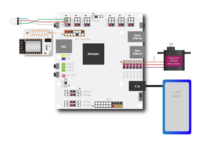

Connections
Attach ESP8266 adapter delivered with CORE2 in the box for free in the RPi connector. Connect RGB LED to the hSens1 port as described on the schematics. Connect the servo to the hServo1 port. In the end connect Li-Po as a power supply.

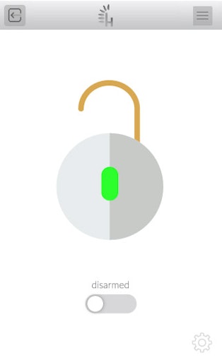

Use your device via web browser and our ui.html.
User interface
