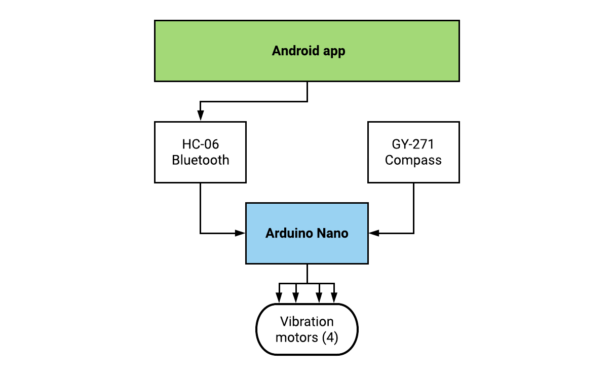

Project Ariadne Headband is made out of two parts: headband and Android app. The common usage flow is following. First, you open Ariadne Headband app. Using this app you connect via Bluetooth to your Headband. Next, the app will ask for you current GPS location. Then you open Google Maps integrated into our app and select your destination (place where you want to go).
Our Android app will compute the geographical azimuth from your current location and chosen destination. When you are ready you start navigating by pressing a button that sends computed azimuth to the Headband you put on your head. Azimuth plus some other data are sent as a bytearray through Bluetooth Low Energy.
Headband consists of Arduino Nano board,  MPU-9250 "compass" module, HM-10 Bluetooth Low Energy module and 4 vibration motors. Compass module allows us to know current azimuth, that is where is the user looking. All components are placed into a box on back of your head. Our aim in the future will be to make this as small as possible so you will not even feel it. It is also possible to place everything into a hat or helmet for example instead of rubber headband. We are using rubber headband because it is very easy to manipulate.
Vibration motors around your head are placed in set directions so they can signalize where you should head. Your heading is computed by taking your current azimuth and the azimuth sent from android app (that is where you are currently going and where you should go, respectively). See illustration below for Headband overview.
For example, Motor 1 is activated when you should head 45° (this is same for other diagonal directions). If you should head straight, both Motor 4 and Motor 1 will be activated. The similar approach applies for left, right and turn back signals. We originally planned to use 8 vibration motors, one for every 45° but have concluded that it would by more complicated and would not be worth it. The motors would be too close together and it would be hard to recognize right direction. Using 4 vibration motors is both cheaper and more robust.

  • GY-271 Compass Module
    Tomas Kosicek08/26/2018 at 21:27 0 comments
    Compass module is probably the most important part of the headband. Without it we would not be able to determine azimuth and therefore navigation would be impossible. We went with GY-271 compass module mainly because it was locally available and we could get it in short time. After initial difficulties with getting data from the module we found out that module we got is equipped with QMC5883L IC instead of HMC5883L which we expected. Main difference between these two are different addresses of I2C and registers.
    After sorting this out we started printing data on serial monitor and noticed that something isn’t right. To have a better idea of the output data we decided to plot it into graphs using Python as you can see on the image above.
    Because it is a three axis compass, points are plotted into three planes, in the first column all three planes are shown overlapping and then each plane separately. In the first row are plotted unchanged data from the compass module. As you can clearly see points are forming a circle which center isn't same as zero in the graph. The reason is that values have some offset that makes calculating correct azimuth from these values impossible.
    To get rid of the offset a calibration is needed. It's done by rotating compass ideally in every possible direction and looking for maximum and minimum values for each axis. After calibration is done maximum and minimum values are saved (in present version of software it's not fully functional) and then values read from compass are modified such that there is almost no offset.
    Corrected values are shown in Graph in the second row, as you can see it's much better. Azimuth calculated from these corrected values is quite accurate. Problem is when two axis from whose azimuth is calculated aren't horizontal, if compass module is tilted on side azimuth changes. We plan to address this problem in future by using compass module with accelerometer and then compensate the tilt.
