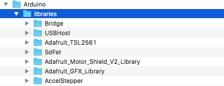

  • 3
    Install relevant libraries
    The PIR device requires the following libraries:
    #include <Adafruit_SSD1306.h>
    #include <Wire.h>
    #include <RTCZero.h>
    #include <SPI.h>
    #include <SdFat.h>
    #include <Adafruit_GFX.h>
    These are available for download as a single zip file from the files area, or you can search for them online.  When you're done they should all be in your libraries directory, see example:
    If this doesn't work, or you'd prefer a different way go through instructions here for how to manually add libraries.
