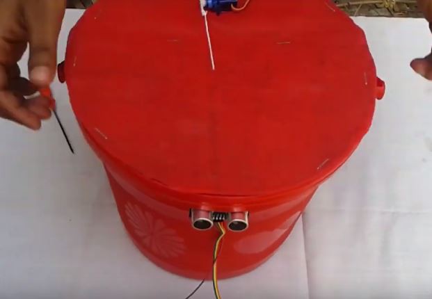

✦Step 1:-Take a dustbin

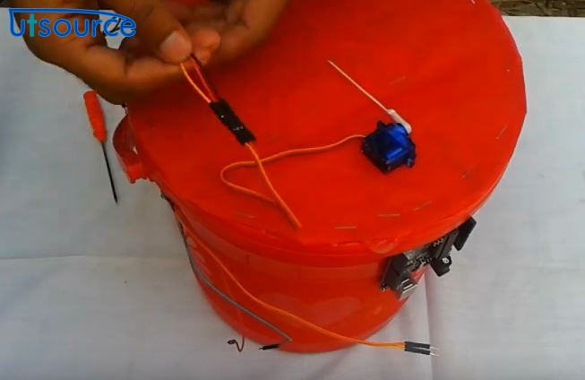

✦Step 2:-make a lead such that it will be fixed from a point and open from one point
Step 3:-Then make 2 holes in the face of the dustbin for ultrasonic sensor
✦Step 4:-then fix the survo with hot glue

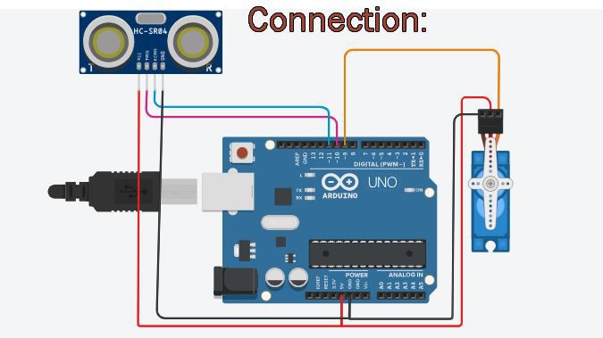

✦Step 5:--do wireing using the circuit diagram

Copt this above code into the Arduino IDE and upload it to the Arduino. now make all connection
