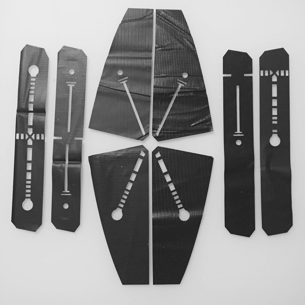

    Pond Liner Bag
    Software
    + Illustrator
    + Fusion 360
    Data Gathering Prototype Build
    The bag is constructed of pond liner which is adhered using PVC glue.
    Materials
    + pond liner http://www.homedepot.com/p/Total-Pond-7-ft-x-10-ft...
    + pvc glue http://www.homedepot.com/p/Weld-On-PVC-717-16-oz-H...
    + FPT Cap http://www.homedepot.com/p/Charlotte-Pipe-2-in-PVC...
    + Male Adaptor http://www.homedepot.com/p/Charlotte-Pipe-2-in-PVC...
    + VHB Tape https://www.uline.com/Product/Detail/S-10113/3M-VH...
    + Double Sided film tape https://www.uline.com/Product/Detail/S-17123/Doubl...

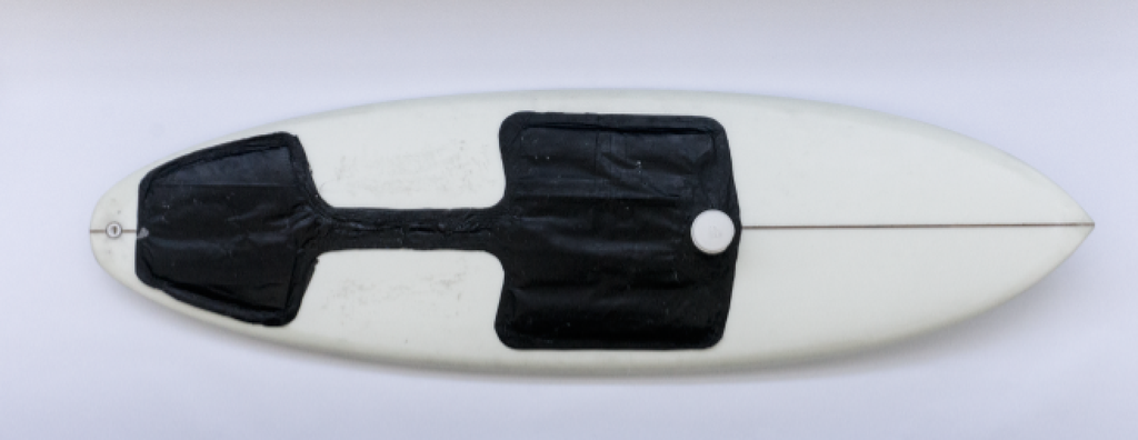

    Data Gathering Board Concept 1
    Tools
    +Vinyl Cutter http://www.ebay.com/itm/like/281910397159?lpid=82&...
    + Soldering Iron
    + Ruler
    Pond Liner Bag
    THE SENSOR
    + Force Sensor Resistor (11) https://www.sparkfun.com/products/9375
    + 10k ohm Resistor (11) https://www.sparkfun.com/products/8374
    + Stranded wire
    + Arduino mini https://www.sparkfun.com/products/13614?gclid=CLa5...
    + Arduino Datalogging Shield https://www.adafruit.com/products/1141?gclid=CIDwi...
    + Battery http://www.mouser.com/ProductDetail/Adafruit/258/?...
    Water Proof Pad Sensors
    Testing the Prototype
