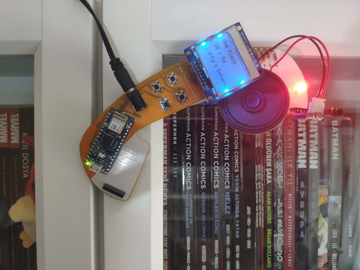

Although there are myriads of web and mobile applications to track release dates of favorite shows, I wanted to create a device that notifies me when a new episode of a series or an anime in my list is on release from scratch - hardware and software - with various features. First of all, I created a web application - TV Series / Anime Release Date Tracker - in PHP to create a series/anime list and gather information about their release dates. In that regard, I utilized the TVMAZE REST API that allows the application to obtain episode information by release date precisely, albeit without miscellaneous and perplexing coding steps. Then, I set up a LAMP (w/ MariaDB) server on Raspberry Pi to run the application. But, for those who do not have a Raspberry Pi nor want to use one as the host, I published a free version of the application with a user-friendly interface on my website. Also, you can find the source code of the application below.
After fulfilling transferring information with the web application, if there is a new episode on release, I decided to use an Arduino Nano 33 IoT as the development board to collate data generated by the application. You can find more information below on how I sorted out the response transferred by the application by using a delimiter. And, to manage features and modes I implemented on the Nano 33 IoT, I designed a user interface (menu) with a Nokia 5110 Screen and pushbuttons.
Lastly, to get informed when a new episode of a show in my list on release with its opening song, I used a Serial MP3 Player Module (OPEN-SMART) due to its simple-to-use UART command list. Furthermore, it let me add the MP3 Player mode to play all opening songs, which turned the device into an intriguing accessory for my room :)
After completing my design on a breadboard and testing the code, I designed a PCB (TV Series / Anime Release Date Notifier) with a unique retro telephone shape to create a brand-new looking and easy-to-use device.

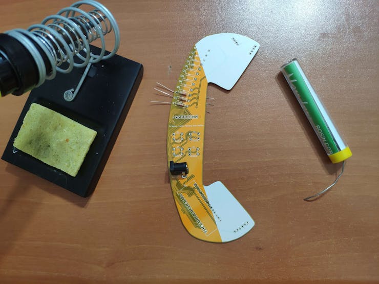

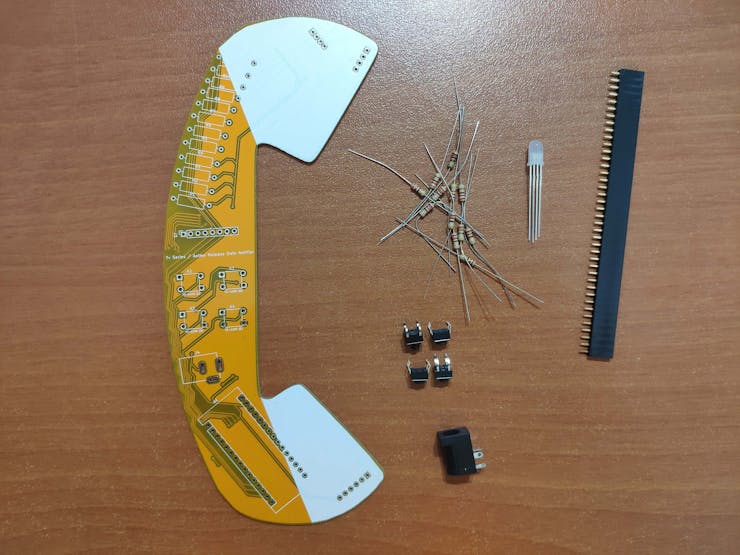

Step 1: Designing and Soldering the TV Series / Anime Release Date Notifier PCB
I designed the TV Series / Anime Release Date Notifier PCB by using KiCad. I attached the Gerber file of the PCB below, so if you want, you can order this PCB from JLCPCB to replicate this project to get notified when there are new episodes of your favorite shows on release :)

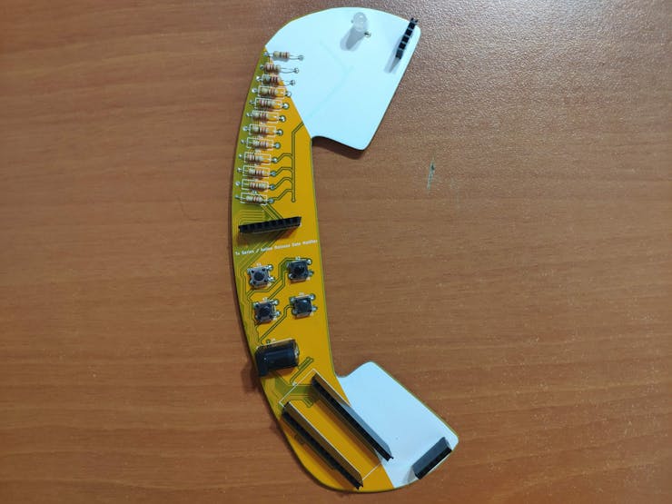

First of all, by using a soldering iron, I attached headers, pushbuttons, 220Ω resistors, the power jack, 5mm Anode RGB LED.
Component list on the PCB:
A1 (Headers for Arduino Nano 33 IoT)
J1 (Headers for Serial MP3 Player)
J2 (Headers for DS3231 - Not Required)
J3 (Headers for Nokia 5110 Screen)
J4 (Power Jack)
D1 (5mm Anode RGB LED)
K1, K2, K3, K4 (Pushbuttons)
R1, R2, R3, R4, R5, R6, R7, R8, R9, R10, R11, R12 (220Ω resistors)

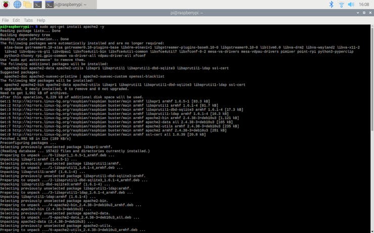

  • Install the apache2 package by typing the following command into the terminal and pressing Enter:
sudo apt-get install apache2 -y

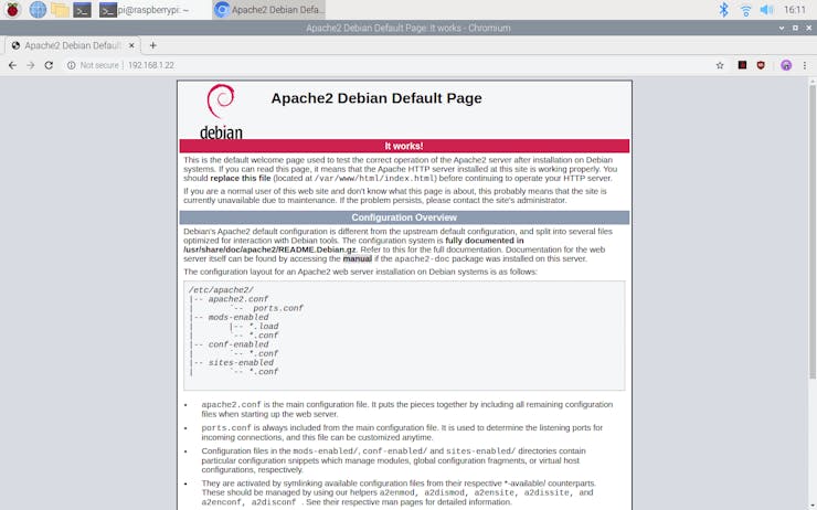

  • To test the server, open Chromium by selecting Internet > Chromium Web Browser from the menu and enter http://localhost.

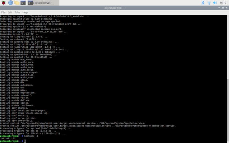

  • If you want, you can use the IP address of your Raspberry Pi as well.
hostname -I

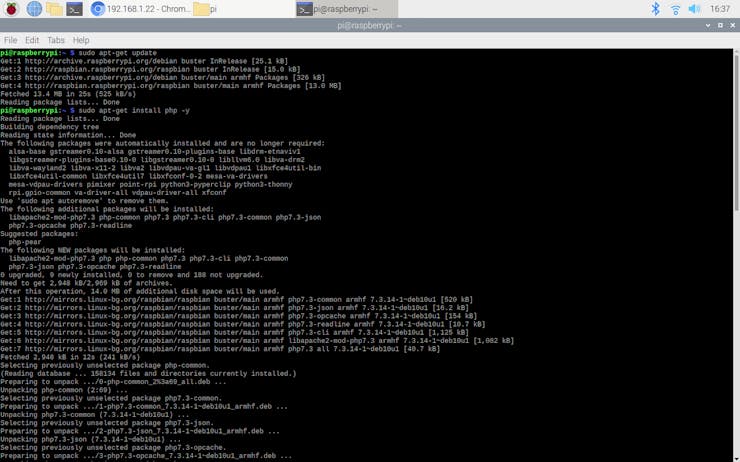

  • Install the PHP package with the following command:
  • Do not forget to update the Pi.
sudo apt-get update
sudo apt-get install php -y

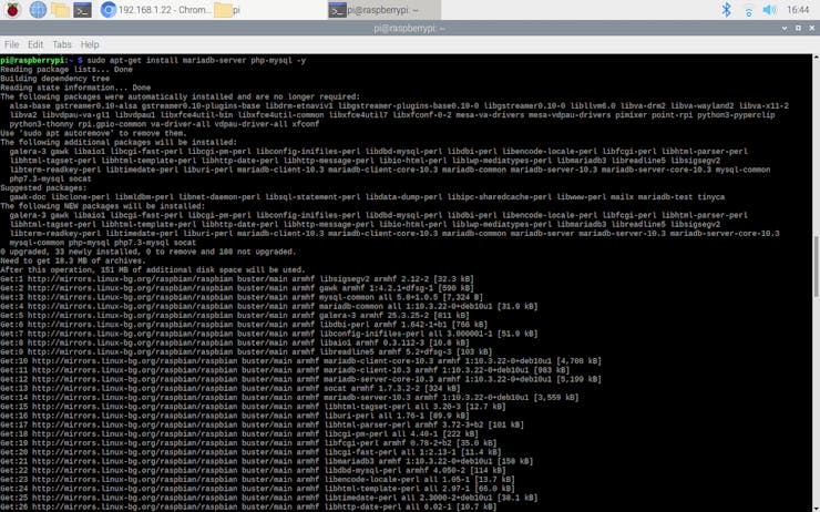

  • Install the MySQL Server (MariaDB) and PHP-MySQL packages by entering the following command into the terminal window:
sudo apt-get install mariadb-server php-mysql -y

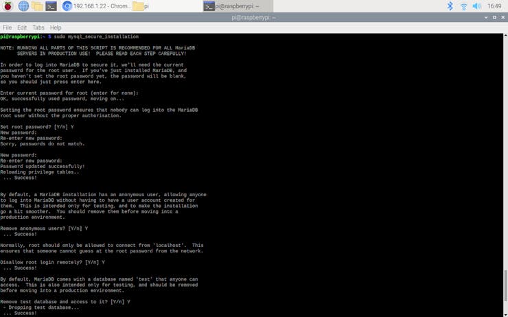

  • To create a new user, run the MySQL secure installation command in the terminal window.
sudo mysql_secure_installation
  • You will be asked Enter current password for root (enter for none): — press Enter.
  • Type in Y and press Enter to Set root password.
  • Type in bot at the New password: prompt, and press Enter.
  • Type in Y to Remove anonymous users.
  • Type in Y to Disallow root login remotely.
  • Type in Y to Remove test database and access to it.
  • Type in Y to Reload privilege tables now.
  • When completed, you will see this message - All done! and Thanks for using MariaDB!
