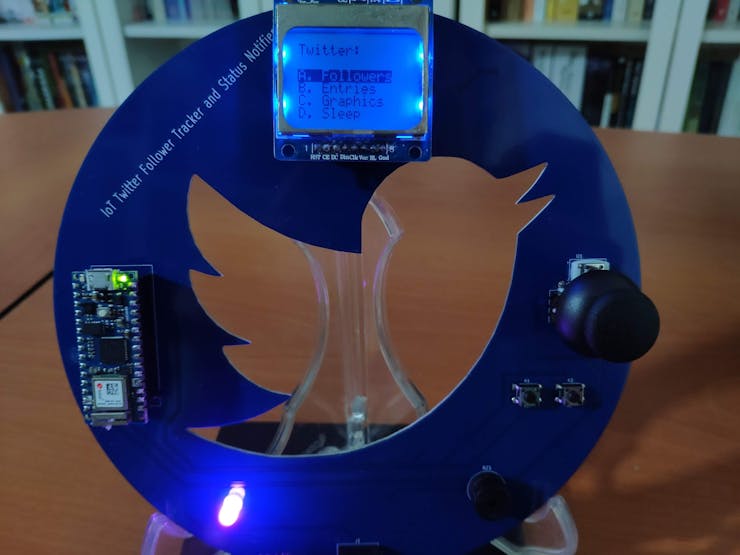

After completing wiring on a breadboard and testing the code, I designed a PCB (Twitter Follower Tracker) having the Twitter logo carved at its center. It became a stylish and fitting addition to my desk as an efficient apparatus to track the follower count of my account :)
In addition to displaying information, the device:
- Notifies the user when there is a change in the follower count - INC or DEC.
- Shows monochrome images as a screensaver if selected.

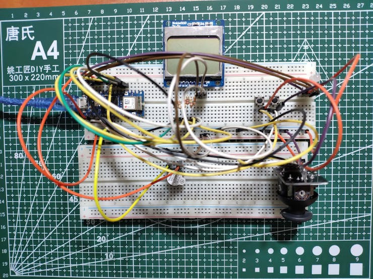

Before prototyping my PCB design, I tested all connections and wiring with the Arduino Nano 33 IoT on the breadboard.

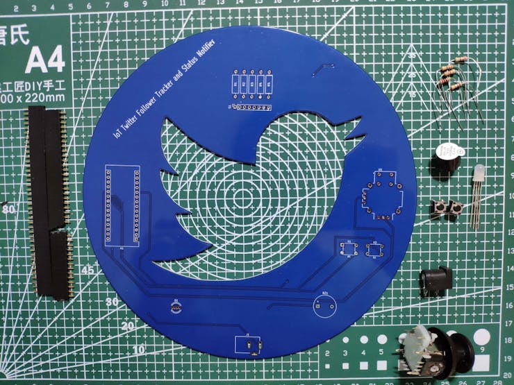

Then, I designed the Twitter Follower Tracker and Status Notifier PCB by using KiCad. I attached the Gerber file of the PCB below, so if you want, you can order this PCB from PCBWay to create a stylish and fitting apparatus to display the follower count of a selected account and get notified when there is a change, inspired by the Twitter logo :)
Click here to inspect and order this PCB directly on PCBWay.
![](https://hackster.imgix.net/uploads/attachments/1288158/image_cfcfTKarFi.png?auto=compress%2Cformat&w=740&h=555&fit=max)
First of all, by using a soldering iron, I attached headers (female), COM-09032 analog joystick, buzzer, 5mm common cathode RGB LED, 6x6 pushbuttons, 1K resistors, and the power jack.
Component list on the PCB:
A1 (Headers for Arduino Nano 33 IoT)
S1 (Headers for Nokia 5110 Screen)
U1 (COM-09032 Analog Joystick)
BZ1 (Buzzer)
D1 (5mm Common Cathode RGB LED)
K1, K2 (6x6 Pushbutton)
R1, R2, R3, R4, R5 (1K Resistor)
J1 (Power Jack)

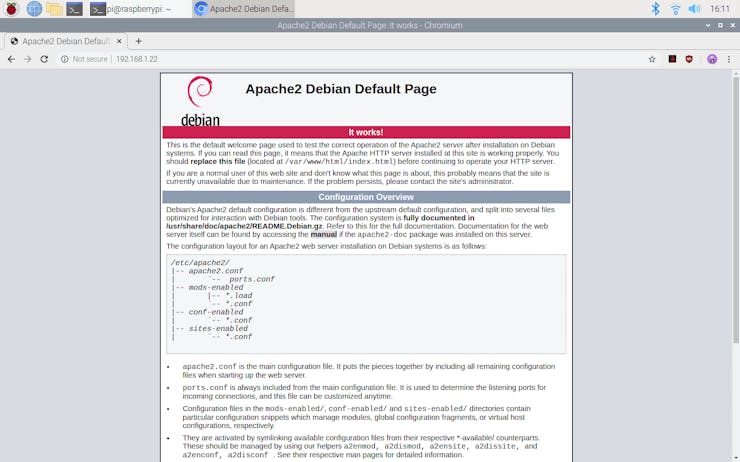

⭐ To test the server, open Chromium by selecting Internet > Chromium Web Browser from the menu and enter http://localhost.

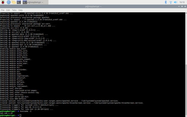

⭐ If you want, you can use the IP address of your Raspberry Pi as well.
hostname -I

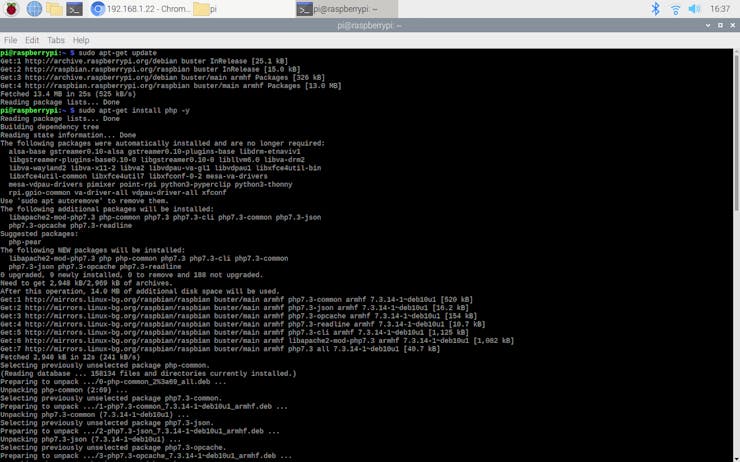

⭐ Install the PHP package with the following command:
⭐ Do not forget to update the Pi.
sudo apt-get update
sudo apt-get install php -y
