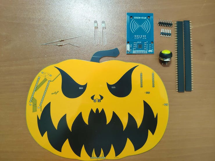

After completing my design on a breadboard and testing the code, I designed a PCB (WhatsApp RFID Talking Doorbell) with a unique jack-o'-lantern shape with an angry facial expression to create a suitable and wicked doorbell for Halloween :)

Step 1: Designing and Soldering the WhatsApp RFID Talking Doorbell PCB
I tested all connections and modules with the Arduino Nano 33 IoT on the breadboard.
![](https://hackster.imgix.net/uploads/attachments/1217545/image_sTnrLP4dPl.png?auto=compress%2Cformat&w=740&h=555&fit=max)
Then, I designed the WhatsApp RFID Talking Doorbell PCB by using KiCad. I attached the Gerber file of the PCB below, so if you want, you can order this PCB from PCBWay to create a stylish jack-o'-lantern to frighten your guests who were not informed about its cursed features :)
Click here to inspect and order this PCB directly on PCBWay.
![](https://hackster.imgix.net/uploads/attachments/1217546/image_tSXpskaJDI.png?auto=compress%2Cformat&w=740&h=555&fit=max)
First of all, by using a soldering iron, I attached headers (male and female), 5mm RGB common cathode LEDs, 1K resistor, 10K resistor, and DC184 yellow pushbutton.
