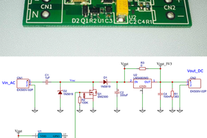

Schematic of the control part:
Switching frequency of 30kHz and maximum duty cycle of 45% is set by components R2,R3,C1,D1. Output voltage is regulated to about 7.2V. 4 LEDs are connected in series, at this voltage they start to conduct, Control voltage (pin 5 of the 555) is pulled lower via Q2 and duty cycle is decreased. Supply for the control board is 15V, stabilized by Tesla MA7815. Range of Control voltage is therefore  0 to 10V. Characteristics of duty cycle and frequency vs. Control voltage are attached below. After plugging-in, there is soft-start consisting of Q1, C17, R15, R22. Control voltage starts from zero and ramps up in about 50ms.
Overcurrent protection uses a current sense transformer. Its output voltage is filtered and connected to base of Q3. When it exceeds ~0.55V, Q3 conducts and lowers Control voltage via Q4 and Q1.
Output of the 555 is strengthened by a push-pull transistors and fed into gate-drive transformer. Gate-drive transformer with trifilar windings is located on the third PCB near the MOSFETs, together with current sense tranformer.
