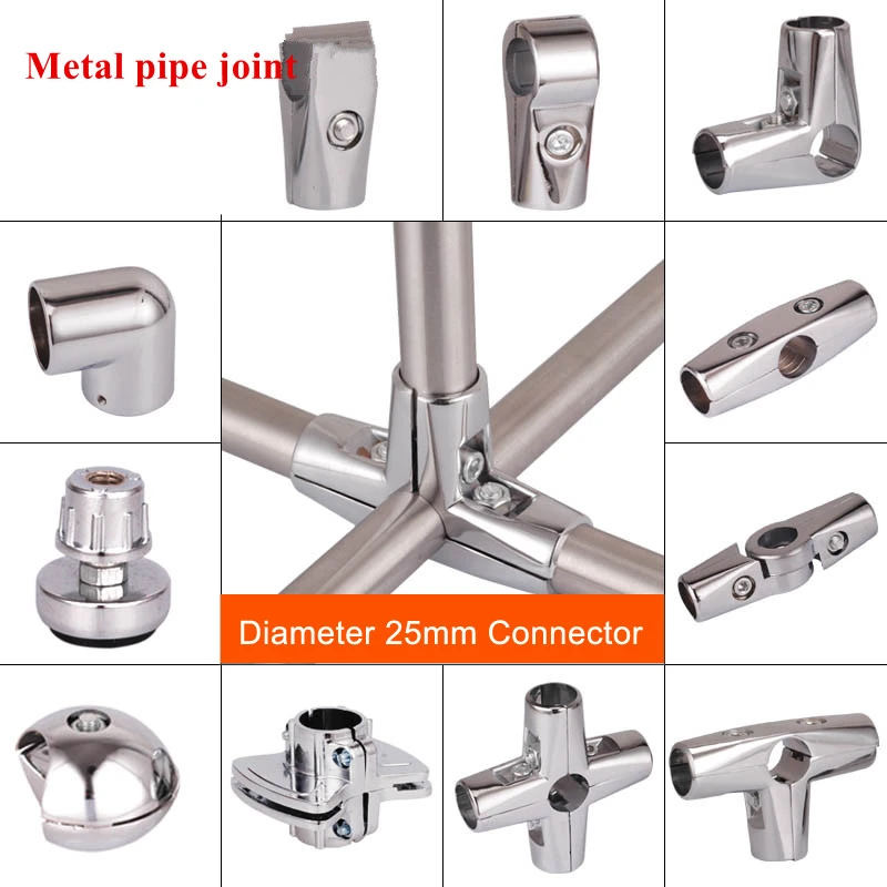

There is also metal pipe/tube connectors, but I don't know which one can withstand 5 tons or more.
