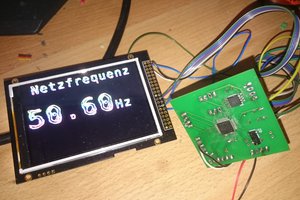

The project was built using a Atmega328pu, and Nokia 5110 LCd display on a Sparkfun dev board.
The board is custom-made (see attached Eagle CAD and images), but the project will function on a Arduino with the same microcontroller. The microcontroller is programmed with a USBTiny.
The software was written in assembly with Atmel Studio 7- initial versions written in C were far too large.
Character Development and Compression
The font was designed using our own Small Font Designer, producing variable-width characters 8 pixels tall.

Messages are written to the display buffer letter-by-letter. The current character is loaded found in the program (slowly looping to save space), decompressed to individual pixels in 64-byte buffer, and written to the LCD display buffer.
After loading the message, the display buffer is written to the LCD via SPI.

paisleyelena063 wrote 06/01/2023 at 04:33 • point
