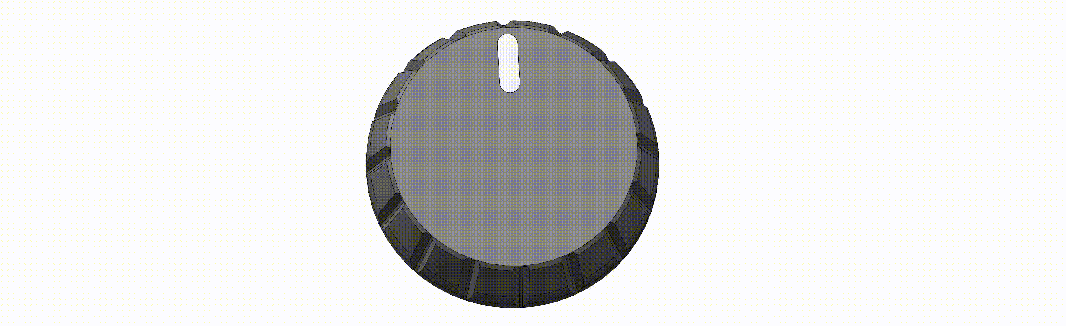

The Pico dev m3 is a development board based on the RP2040 chip, the board has the same functions and capabilities as the raspberry pi pico board, only with a different shape and some useful improvements, the most significant being the fact that the board is also designed to be a super high resolution magnetic rotary encoder.
It's not difficult to imagine the potential of a board that can become a rotary encoder at will, but I figured I’d get the ball rolling with two example projects to demonstrate how the pico dev m3 can be integrated into PCB projects.
