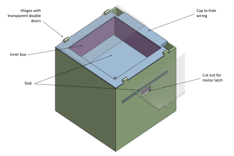

During this milestone, we also got a head start on designing our physical box, which would eventually go through many variations. This initial variation featured nested boxes where wires could be hidden, as well as a cap.

Milestone 4, was a lot of revision. Our team moved away from arm based doors, and towards gear powered doors.
We created a new box design that included a sliding door that locks from the outside to separate the top and bottom of the box and act as another level.

We also 3D printed an inner box prototype, as well as created the wooden exterior of our box with laser cutters. We taped the sides together as a prototype.
All of our components work separately, all that's left is to put them together in the box!
