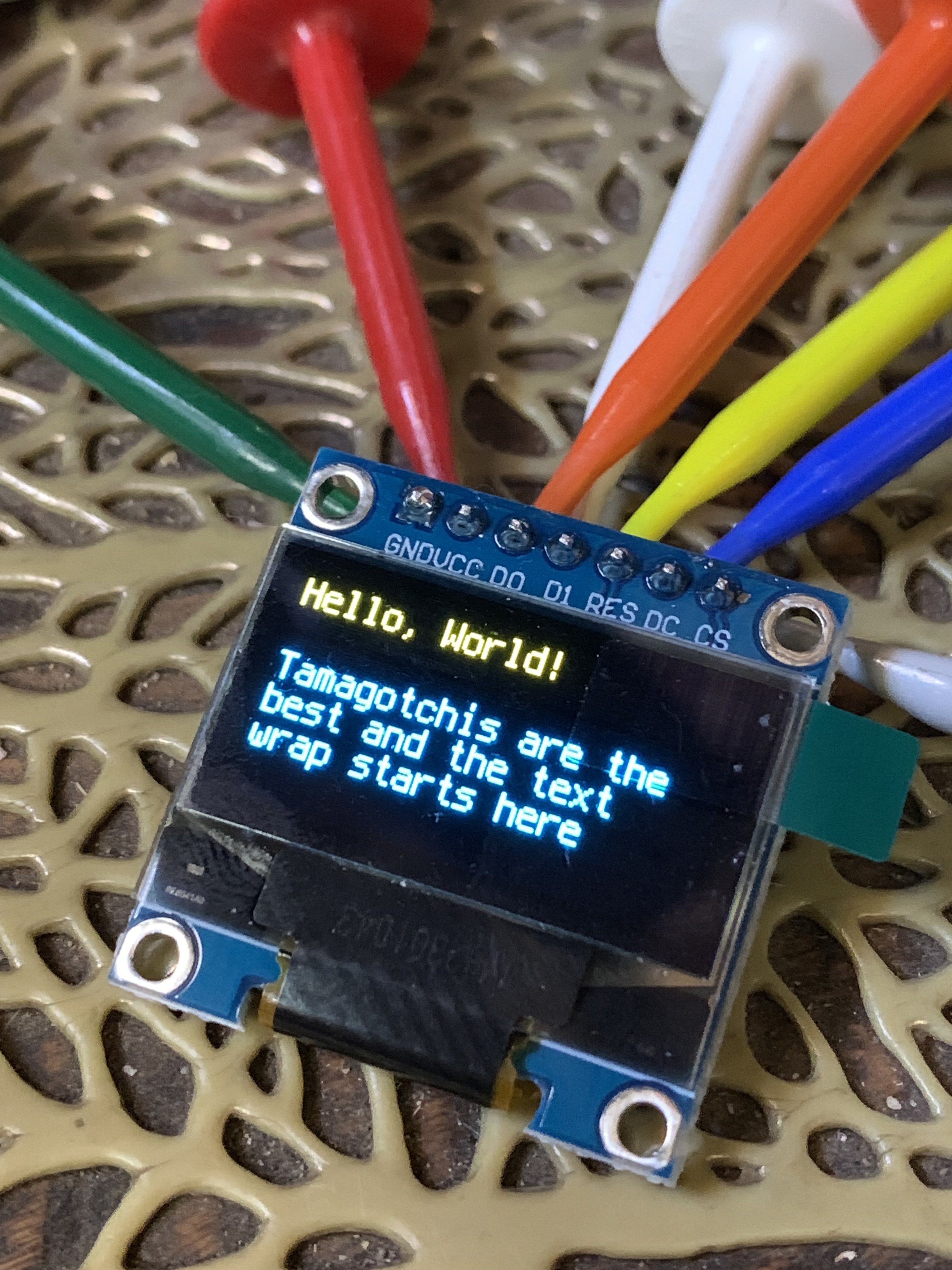

    Mx. Jack Nelson11/03/2023 at 18:08 0 comments
    Last night I received the tiniest OLED screen I've ever seen. It will take up less space than a 2u key. I hooked it up today, and after some fiddling by @Steph to find a solution for pins being held on when the Pico does a soft reset (hint, it's this line of code) I got it working.
    displayio.release_displays()
    Here is the demo code for the display, including some forced text wrapping.
    import board
    import busio
    import digitalio
    import displayio
    from adafruit_display_text import label
    from adafruit_displayio_ssd1306 import SSD1306
    import terminalio
    import time
    # Define your pins
    dc_pin = board.GP20  # Data/Command
    cs_pin = board.GP13  # Chip Select
    reset_pin = board.GP21  # Reset
    # Release any resources currently in use for the displays
    # Create the SPI bus
    spi = busio.SPI(clock=board.GP10, MOSI=board.GP11)
    # Create the display bus
    display_bus = displayio.FourWire(spi, command=dc_pin, chip_select=cs_pin, reset=reset_pin)
    # Create the display instance
    display = SSD1306(display_bus, width=128, height=64)
    # Create a display group
    splash = displayio.Group()
    # Add the display group to the display
    display.show(splash)
    # Define the max width in pixels for the text to wrap
    max_width_pixels = 128
    # Estimate the max number of glyphs based on an average character width of 6 pixels
    average_character_width = 6  # This is an estimate; adjust for your specific font
    max_glyphs = max_width_pixels // average_character_width
    # Function to wrap text manually while respecting manual line breaks
    def wrap_text_to_width(text, max_chars):
        paragraphs = text.split('\n\n')  # Split on double line breaks to preserve paragraphs
        wrapped_paragraphs = []
        for paragraph in paragraphs:
            lines = []
            line = []
            words = paragraph.split()
            for word in words:
                # Check if adding the next word would exceed the max width
                if sum(len(w) for w in line) + len(line) + len(word) > max_chars:
                    lines.append(' '.join(line))
                    line = [word]
                else:
                    line.append(word)
            lines.append(' '.join(line))  # Add the last line
            wrapped_paragraphs.append('\n'.join(lines))  # Rejoin lines with single line break
        return '\n\n'.join(wrapped_paragraphs)  # Rejoin paragraphs with double line breaks
    # Define the text with manual double line breaks
    text_string = "Hello, World!\n\nTamagotchis are the best and the text wrap starts here"
    # Use the wrap function to wrap the text and preserve manual line breaks
    wrapped_text = wrap_text_to_width(text_string, max_glyphs)
    # Create a label with the wrapped text
    text_area = label.Label(terminalio.FONT, text=wrapped_text, line_spacing=0.9)
    # Set the location of the text
    text_area.x = 0
    text_area.y = 5
    # Add this label to the display group
    splash.append(text_area)
    # Run the display loop
    while True:
        pass
