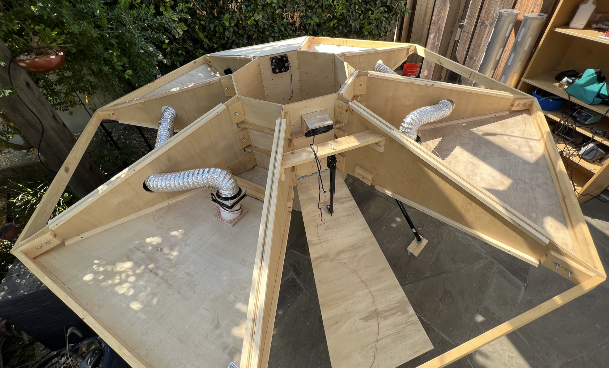

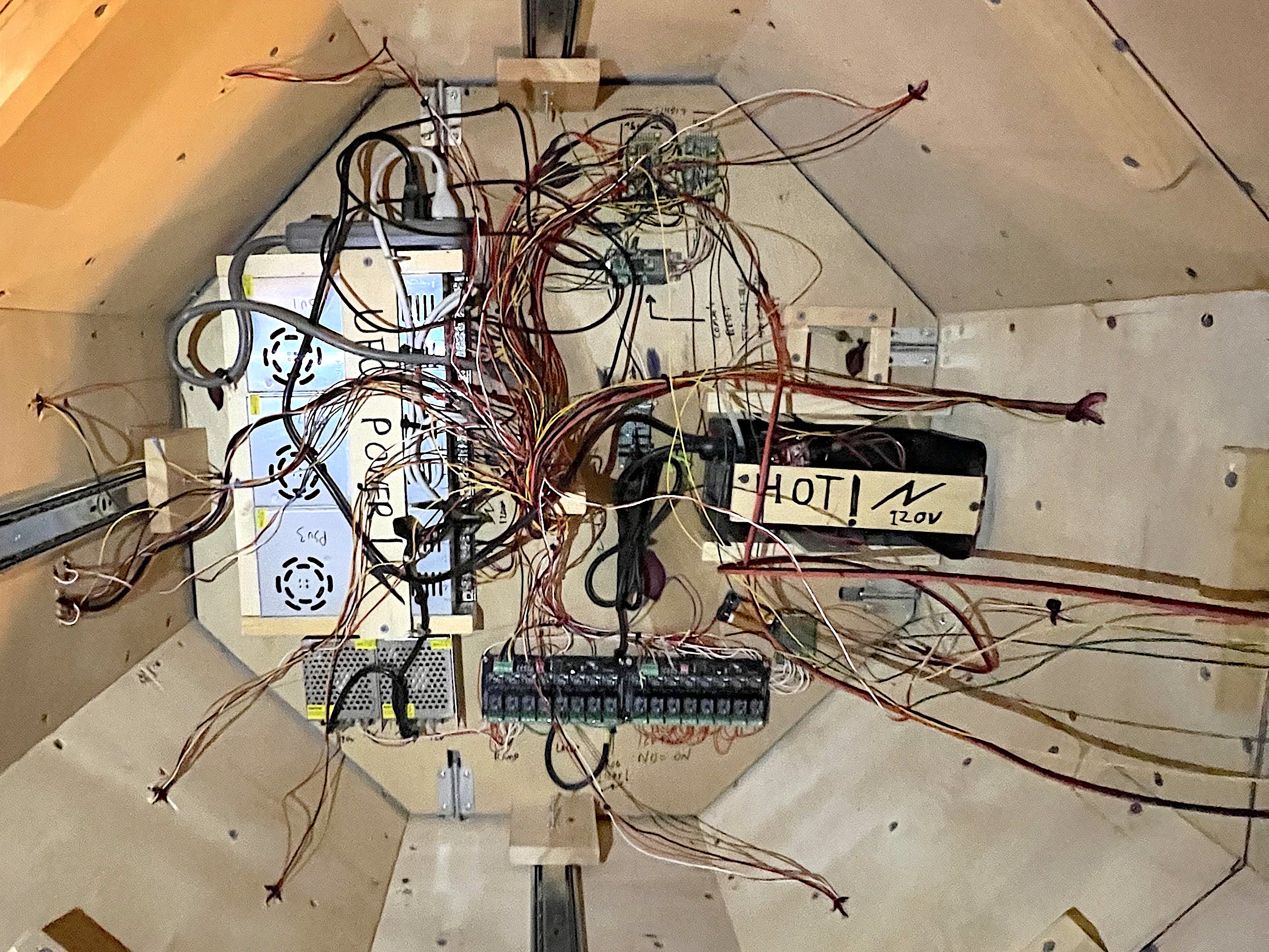

I built the UFO ground-up starting around a wooden frame and a custom-made acrylic dome. Inside is an Arduino-based control system that powers close to 2000 neopixels, a hacked smoke machine, 6 PC fans, a laser module, and a linear actuator powered ramp. The Arduino runs a hacky scheduler I coded to run sequences of events and effects. A real local artist was commissioned to make the Alien crew. Oh, and GPT4 designed one of the light effects for me! See it running here: https://www.youtube.com/watch?v=jFsSAoTA9vY
In the file section, I have dropped a PDF of my complete build notes, that led to this creation:
If you do read these notes then be aware they are scrappy / hacky. I built this UFO ground up and held most of it in my head as I went along and then documented various parts afterwards. I really did hack this together moment-by-moment - which actually made it super-fun to do. As a result, these aren’t really instructions to follow, but could be a source of ideas and clues and help if you choose to make a similar UFO.
It started with this request from the family:
Became big and heavy in the middle of its build:
And quite technically complex and wirey towards the end:
The computer above runs this code rather well:
