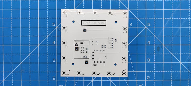

After finalizing the schematic, we prepare the PCB file using the outline and component positions provided by the CAD design of the board.
The ESP8266 board and other SMD components were positioned close to the bottom of the board, while the RGB LEDs were positioned close to the board's edges.
PCBWAY Service
After completing the PCB design, we export the Gerber data and send it to PCBWAY for samples.
We placed an order for a white silkscreen LED board.
After placing the order, the PCBs were received within a week, and the PCB quality was pretty great.
