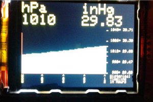

Monitor current and forecasted weather data with littleBits and a little coding. These customizable and modular weather boxes display current temperature, the forecasted high and low temperatures for the day, and the forecasted conditions for the day (i.e. sunny, cloudy, precipitation).
We wrote a short program that gets information from Weather Underground and sends that data through the littleBits cloud to a cloudBit. Every 30 minutes the program asks Weather Underground for the current temperature and the forecasted high, low, and conditions for New York, NY. Then it converts this information into a voltage* which is sent to each cloudBit, adjusting the angle of the servos (the servos must be set to turn mode for this to work). We've posted the code for our program here.
*The program does not specify the volts, rather it sends a value from 0 to 100 which tells the cloudBit what percentage of the total power (5v) to output.
