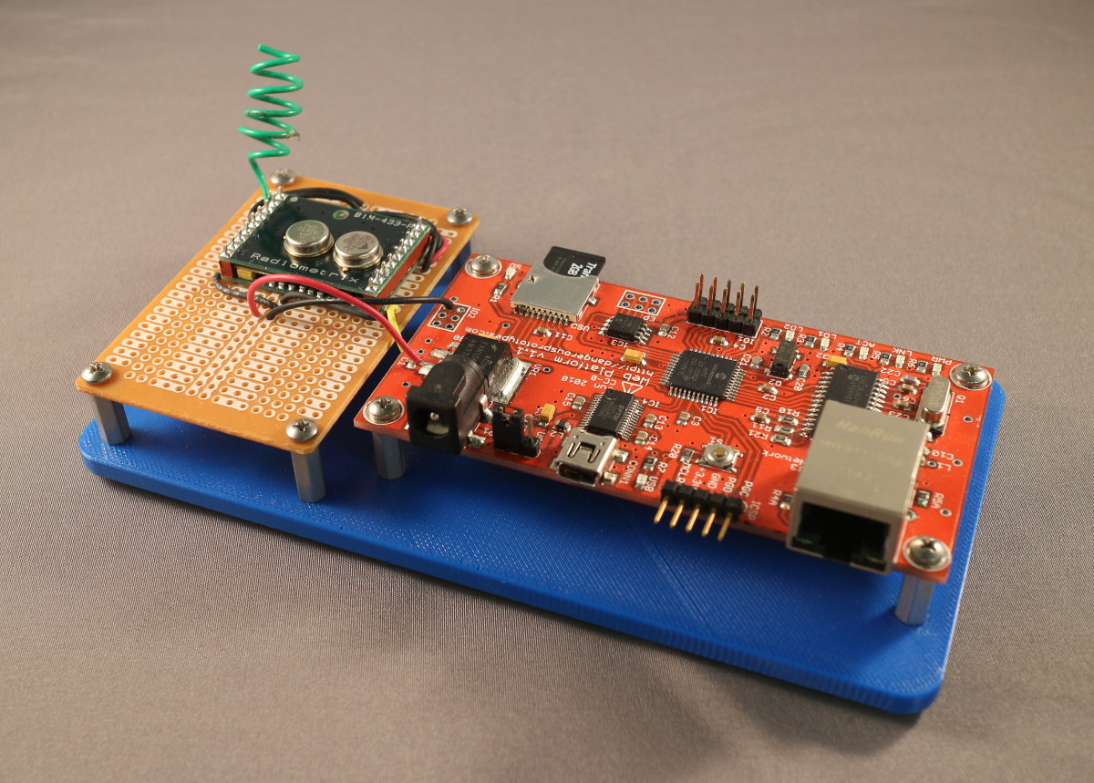

The next step was to figure out how best to decode that data and send it to a website. I considered using an Arduino with one of the web shields, but I decided that because I was already familiar with PIC microcontrollers I would rather find a PIC board with internet connectivity. This was back in 2012, before great parts like the CC3200 and ESP8266 were around, so I decided to start with the Dangerous Prototypes Web Platform. I had a Radiometrix BiM-433-F lying around that I had used when decoding the Maverick's protocol, so I soldered that onto a Radio Shack perfboard, added a coil of wire for an antenna, and wired the /CD output to a free IO pin on the PIC. I tapped 3.3V and GND for the radio directly off the linear regulator on the Web Platform board. And, because I was feeling too lazy to drill 8 holes in a piece of plywood that day, I asked Alex Rich to print me out a base on which to mount the boards.

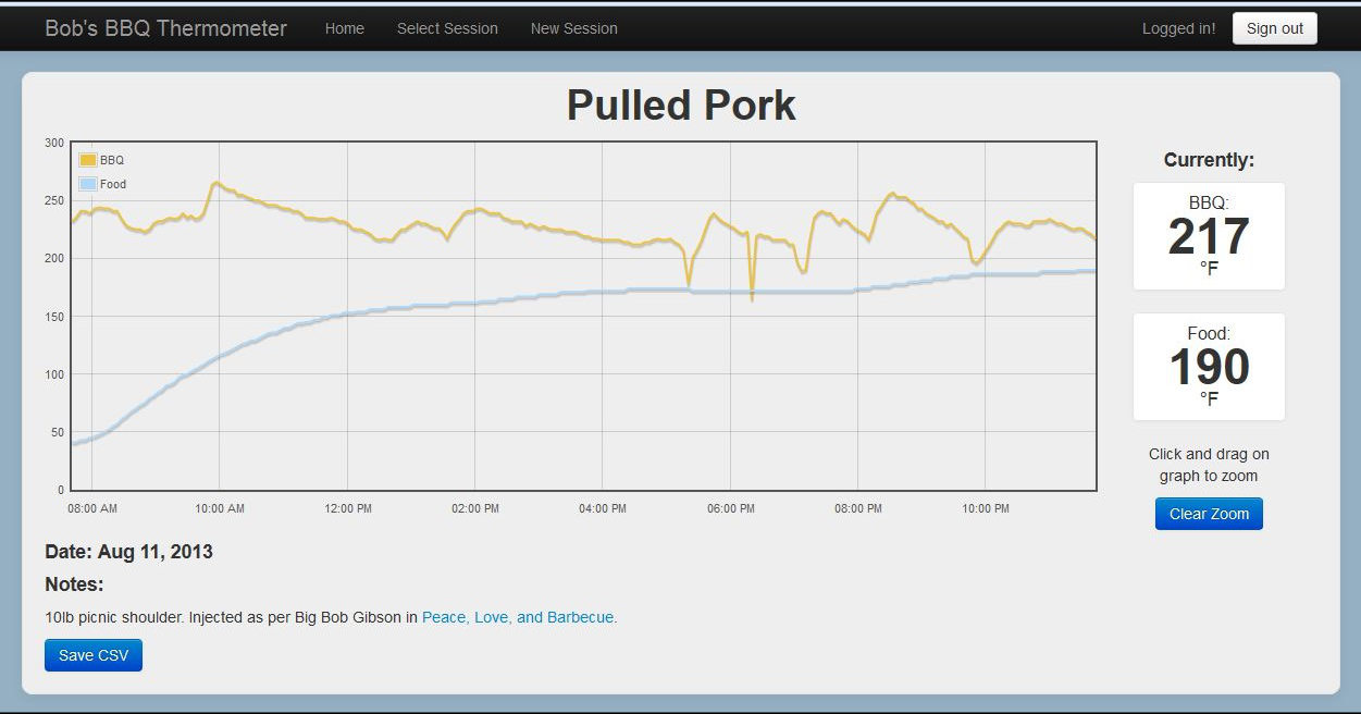

Once this was working, I had to figure out how to send this data to the internet. I decided to try using Cosm (now Xively), which had some neat graphing functionality and appeared to do most of what I wanted. By modifying the GenericTCPClient files in the Web Platform firmware, I was able to get my data (consisting of two temperatures and a timestamp of when they were received) sent to a Cosm page. However, I quickly decided that Cosm wouldn't meet my needs. The graphing didn't offer all the functionality I wanted, and there wasn't much flexibility to customize how the data was displayed. I decided that I would need to just build my own site.
Which brings us to my site: http://www.bobblake.me/bbq/.
Data is sent to it from the Web Platform in more or less the same way it was sent to Cosm. My site displays the current temperature of both probes, and displays a graph of the entire session using the awesome Flot Javascript library. It also supports viewing historical sessions, and can export all the data for each session to a CSV file. Importantly, it displays well on a mobile device, so it's easy for me to check the temperature of my smoker when I'm away – which was the whole reason for this wacky project in the first place.
