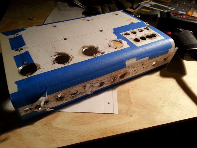

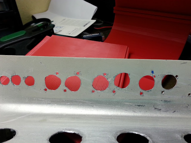

Read more »The knobs I chose for this project are very special: they are knobs from the original Atari 2600 paddle controllers! I bought them at All Electronics in Van Nuys many years ago, and there probably won't ever be a way to source them again. The prototype of Twister is a one-off!
It was really hard finding potentiometers that would fit the holes in the knobs, and even the rather expensive pots I did find had rather short shafts. The plastic knobs have metal bits inside to grip the shaft, but they are shoved too far up to work on these pots, and they ultimately get in the way.
So I chiseled them out with a screwdriver and wrapped the shafts with blue painter's tape until the knobs had a good friction fit.
Twister is finally all wired up! And it works! There are still some kinks to work out, however:
Still, it works. I'll definitely work to get the mounting ironed out and write the software to run it now. I'll probably want to iterate on the design tho. Too bad I've still got 4 of these printed circuit boards left.
