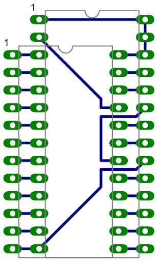

Another major hurdle was getting the 28pin EPROMs to work with the 24pin sockets on the Sym-1. Synertek had envisaged using 8kB ROMs, and with one chip enable, there is enough pins in a 24 DIP socket to handle 8kB. However an EPROM needs a programming pin and pin to supply the programming voltage, in this case 12.5V. So and 8kB EPROM is usually fitted into a 28pin package. I wanted to have RAE in ROM on the board, so I really wanted to be able use those 2764 EPROMs.
I found an image of how to map 28pin EPROM to 24pin ROM and made one up using perf-board (Vero) and some thin wire-wrap wire. There a few tricks to making these boards that I will pass on shortly...
