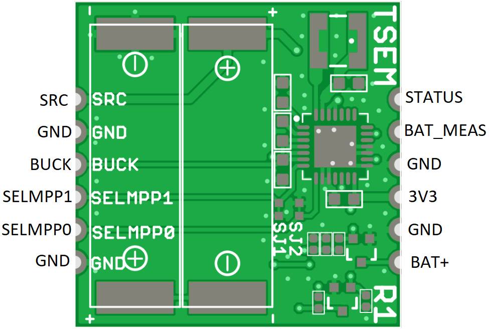

Tiny Solar Energy Module (TSEM)
A 1 square inch PCB module with 2 tiny solar cells, a highly efficient Li-Ion charger and with 3.3V and 1.8V output
This is a 1x1 inch PCB module with two tiny solar cells, a highly efficient Li-Ion battery charger and with two regulated outputs (3.3V and 1.8V). It harvests enough power from INDOOR light to power a simple BLE or LoRa sensor. The board has castellated vias so it can be surface mount soldered onto a mother PCB as well as soldered onto 0.1" headers to be used in a bread board. After the power harvesting challenge (semi finals) I have designed two TSEM derivatives and started selling on Tindie. https://hackaday.io/project/160376-solar-harvesting-into-li-ion-battery and https://hackaday.io/project/160470-solar-harvesting-into-supercapacitor. The last one stores it's energy in supercacitors!
Ideal for indoor applications
The AEM10941 harvesting IC is very suitable for indoor applications because it has an ultra low power startup. The boost converter starts at a very low 380 mV input voltage and 3 uW input power. The IC gets most power out of the solar cells by doing MPPT maximum power point tracking every 5 seconds. In addition the mono crystaline solar cells have a very wide spectral range resulting in 22% efficiency. This makes TSEM very suitable for indoor applications.
How much energy does is harvest indoors?
Indoor light is about 1/100th of outdoor light or 10W/m2. At that power solar cell open voltage is 0.458V and I estimate Vmp at 0.36V per cell. Since we have two in series the booster will work at 0.72V input voltage. At that voltage boost efficiency is about 75% . LiPo charge efficiency is about 95%. Battery current is 5.72 times smaller than the solar current because the voltage increases from 0.72 V to 4.12 Volt. Finally I assume that indoor light is available for 10 hours a day. 44mA * 1/100th * 75% * 95% * 0.72V/4.12V * 10 hrs =  0.55 mAh is harvested every day. So an application must have an average current less than 0.55mAh/24h = 23uA, that's enough for a simple Bluetooth Low Energy beacon or a very simple LoRa application. However if the device is in full sun for only one hour a day it harvests ~10x more: 7 mAh.
If you need to harvest more then you may connect an external solar panel to the castellated via's. Below is a comparison between the on-board solar cells and external solar cells with respect to cost, dimensions, and the energy harvested per day.
Solar panelHarvested energy per day, indoors (mAh)Application average current (uA)
2x $1.02 On-board 0.5V/44mA 22x7mm Ixys KXOB22-12X1L0.5523
1x $1.06 External 1V/100mA 30x25mm1.145
1x $1.31 External 2V/100mA 79x28mm2.9120
1x $1.18 External 4V/100mA 70x70mm6.7279
The harvested energy can be stored in this 110mAh 3*20*25mm LiPo battery. This battery fits very nice below the module.
Specifications
  • PCB 2 layers 25.4 x 25.4 x 0.6 mm  (1 x 1 inch)
  • 2 onboard solar cells in series, 0.5V/44mA each, 22 x 7 x 1.8 mm each
  • harvesting IC input voltage 50mV to 5V. Input current max 110mA. MPPT every 5 secs, MPPT set to 70% (adjustable).
  • Battery: connect an external 3.7V Li-Po battery
  • 3.3V/80mA and 1.8V/20mA regulated outputs. These are enabled when battery voltage is between 3.60V and 4.12V (max charge voltage)
  • voltage divider to monitor battery voltage using the host MCU
  • 3.3V status output pin that warns the host MCU if battery voltage drops below 3.60V
Pinout
SRC - solar panel positive terminal, input to the harvesting IC, connect only when you use external solar panel in stead of onboard solar cells
GND - solar panel negative terminal, connect only when you use external solar panel in stead of onboard solar cells
BUCK - can be used to pull SELMPP1 and SELMPP0 high, 2.2V
STATUS  - open drain output with 1M pull up, when battery voltage falls below 3.6V it goes low 600ms before the 3.3V output is disabled. Can be used to warn the host MCU to gracefully terminate writing to eeprom/flash and prepare for power outage. Voltage level 0/3.3V.
BAT_MEAS - analog output, provides a divided battery voltage for the host MCU with ratio 10/(4.7+10) =0.68*Vbat
GND -
BAT+ - connects to Li-Po positive terminal
GND - connects to Li-Po negative terminal
3.3V - power supply output, provides 3.3V to your application circuit
GND - ground connection for the 3.3V output
1.8V - power supply output, provides 1.8V to your application circuit...
