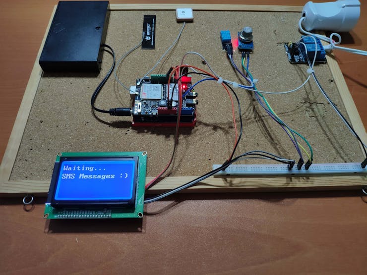

Also, gas leakage, instigated by pipe expansion, is a dangerous problem while temperature is rising. Therefore, I added an MQ-135 Gas Sensor to the device, which detects NH3, NOx, Alcohol, Benzene, Smoke, CO2, to check the hazardous gas status in my room. And, most importantly, to be able to send commands to control the cooling fan via SMS messages and get the weather and gas information as feedback, I used a SIM808 GPS/GPRS/GSM Shield sponsored by DFRobot.

Connections and Adjustments
// Connections // Arduino Uno: // SIM808 GPS/GPRS/GSM Shield For Arduino // D0 --------------------------- RX // D1 --------------------------- TX // D12 -------------------------- POWER // 3-wire Serial LCD Module // D2 --------------------------- SCK // D7 --------------------------- CS // D10 -------------------------- SID // 5V --------------------------- VCC // GND -------------------------- GND // DHT1l Temperature and Humidity Sensor // D3 --------------------------- S // MQ-135 Gas Sensor // A0 --------------------------- A0 // 2-Way Relay Module // D4 --------------------------- IN1
Note: D0, D1, D12 pins are occupied by the SIM808 GPS/GPRS/GSM Shield.
Connect an external battery (7-23V) for the SIM808 module to work properly.
Attach the GPS antenna and the GSM antenna to the SIM808 shield.
Insert a SIM card into the SIM slot on the SIM808 shield.
Before uploading the code, set the function switch on the shield to None (1).
Upload the code.
Then, set the function switch to Arduino (3).
Press the Boot button on the shield until seeing the Net indicator LED flashing every 1 second and wait for the SIM card to register the network - the Net indicator LED will slowly flash every 3 seconds.

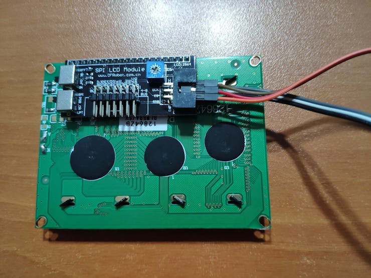

Connect the 3-wire Serial LCD Module to the Arduino Uno.
To switch to the 3-Wire mode, set the PSB_ON switch to SPI.
Click here to get more information about the 3-wire Serial LCD Module.
Connect the DHT11 Temperature and Humidity Sensor, the MQ-135 Gas Sensor, and the 2-Way relay to the Arduino Uno.
Attach a plug to the 2-Way relay to be able to control the cooling fan easily.
