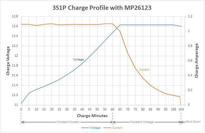

The MP26123/4 will perform a precharge if the battery pack voltage is below 3 volts per cell. The precharge time is limited to 30 minutes at 10% of the full charge current. If the battery voltage rises above 3 volts per cell within 30 minutes, the charge current increases to the full charge level which has been set at 1 amp by resistor R12. The MP26123/4 is rated for up to 2 amps of charge current but I didn't want to push it too hard. When the battery voltage reaches the maximum level (4.2V x number of series cells), the charger transitions from constant current mode to constant voltage. The charge current will drop until it reaches 10% of the full level, causing the charger to shut down to avoid trickle charging.
The maximum charge time is set at 4.5 hours with 0.15uf capacitor C6. Once you know how long it takes to charge your battery pack, you can adjust this capacitor value per the formula in the data sheet. A 10K NTC battery thermistor can be connected to the MP26123/4 to shut down charging if the temperature gets too hot or too cold. Using a standard 10K NTC table, the high temperature turn off is approximately 40ºC and the low temperature shut off is approximately 11ºC. If you don't connect a thermistor, you...
