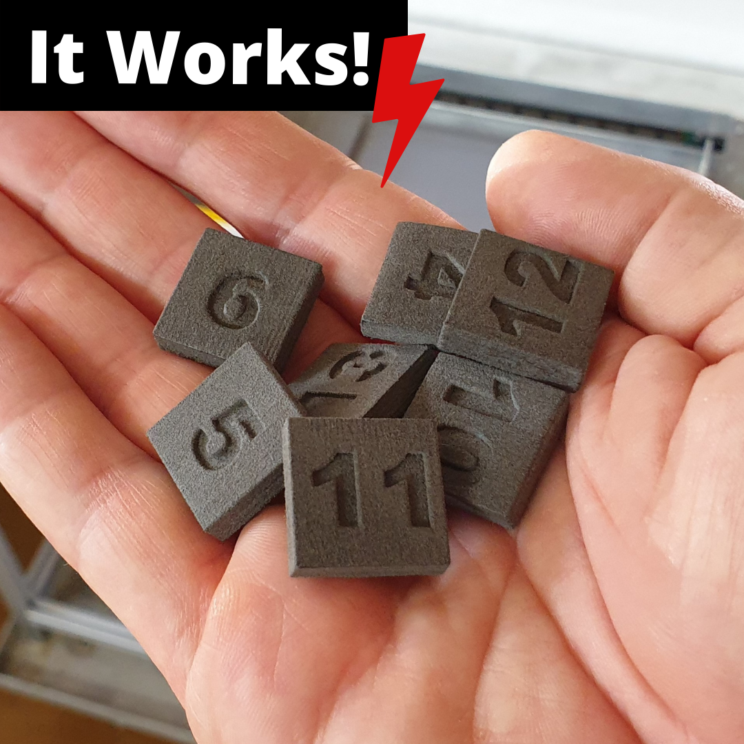

  • Initial test prints: the PA12 print profile experiments
    Tomas Starek05/11/2022 at 20:02 0 comments
    I did 3 tests past two weeks and here are the results. If you are intersted in more details please join Discord - https://discord.com/invite/qDFNFASM57
     Test nr. 1 - first few sintered layers on my printer ever!
    Test nr. 2 - moving forward, now it starts to be really 3D :-)
    Test nr. 3 - last time numbers were not printed. Now they are! Few more print tests like this one and then Benchy is waiting :-)
